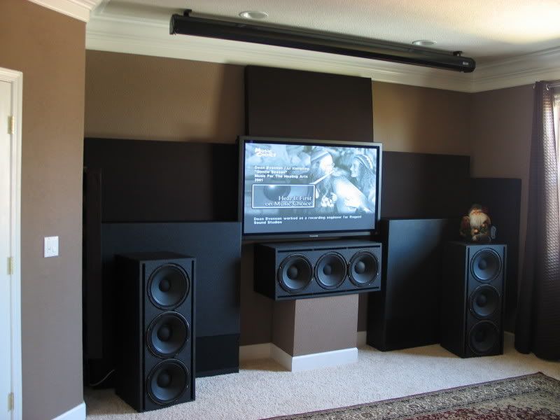

post #277 of 433 Old 12-23-2008, 09:19 AM
allredp's Avatar
Location: Rockies
Posts: 997
Very good news, RMK!
Not like we were expecting anything less with dual SPUDS...
Just for kicks, it would be fun to see what kind of SPL readings you are getting at your LP now with the SPUDS in your front position.
Seems like you did a couple scenes from the Dark Knight last time.
I'm trying to remember what your room size is--please remind me.
Also, any details of what you notice SQ-wise over conventional boxes would be cool.
Glad you're enjoying--I'm still figuring out a way to get myself into Danley!

post #278 of 433 Old 12-23-2008, 09:34 AM - Thread Starter
RMK!'s Avatar
Location: 95608
Posts: 7,749
Mentioned: 39 Post(s)
Quoted: 1508 Post(s)
Liked: 1325
Originally Posted by KevinH View Post
RMK, I know you are still playing, but when you get a little more time with the front dual SPUD location, can you give a little more detailed synopsis? I'm too leaning towards dual SPUDS and my locations would be 2 as a riser behind the first row of seating or 2 up front. Thanks much.
I can give you more superlatives or SPL numbers but it really depends on your preferences, use and room. In looking at the room frequency response graphs via my SMS-1 there is not much usable output below 20 Hz. There could be a number of reasons for this like the current center front wall position of the SPUD’s horn exit. I have a high pass of 15hz/24db slope set on the SMS-1 so I was expecting a bit more output below 20hz but honestly at this juncture the bass is so clean and powerful that I can live without the infrasonic bass.
Opinions are not facts.
RMK! is online now

post #283 of 433 Old 12-23-2008, 01:28 PM
Tom Danley's Avatar
Posts: 197
Hi RMK
Your second spud arrived I see, I am reminded of the words spoken by Monty Burns excellent.
At a time when you feel like pushing black boxes around for fun, there are a couple things you might want to try in addition to sitting on them.
Given ones room has a strong impact on the results, it is often the case where setting up one way in one rooms works best while in another room, a different setup works best.
In other words, there are things in room acoustics where if you have the luxury to experiment, you may find that the best path to the best possible results.
You mention you have the ability to measure response, this is good.
While I am not familiar with the product it appears you have this?
http://www.hometheaterhifi.com/volum...05-part-1.html
The write up for the controller has some things to consider;
It mentions there is a subsonic high pass filter, confirm it is set to 15Hz.
Make sure there is not a high pass or subsonic filter in your amplifier and what ever is driving it. Often commercial amplifiers have a high pass protection filter, it should be mentioned if present in the manual.
Note the eq provided on page 3.
It is mentioned that you shouldn't try to lift the dips, this is correct in more than one way. A dip is likely to be caused by a reflection, a delayed signal that arrives and cancels the original. That kind of problem can't be fixed, the more energy you apply, the stronger the reflection is, with pink noise and a simple RTA, it can appear that your helping but your not, your increasing the Q of it, not filling it in. . \\
EQ is a correction linked in magnitude AND phase, unlike things you can fix with EQ, you can improve the amplitude sometimes but you screw up the phase if you try to fix these kinds of problems.
The bottom line is, your normally much better off cutting a bump than lifting a depression. On page 3, the unmodified in room response and eq is shown.
To make the speaker they show flat to 15Hz, given the eq available, it would all have to be cuts.
If there were a slider at 15Hz, then that could be lifted instead as it is the box roll off and not a reflection / cancellation. Fwiw, this would be too much to fix with eq too.
You would need to make up for the reduction in output over most of its band by increasing the gain post eq say in the amplifier drive or gain.
Anyway (staring outside at the snow falling again), like I said when you feel like some exertion, try these;
Try placing the outlet for each spud in the outer corners with the box moved into the wall / wall corner. This produces an acoustic mirror for the box by being up against the corner and raises the efficiency and lowers the low corner.
Try placing the subwoofers standing up together with the outlets at the bottom together.
This replaces the mirror image the room wall provided above with an actual source.
Also, this pair has some forward directivity over a point source due to it's physical shape at /near the exit, in effect being a 180 degree horn.
Now what may not be clear is unlike a vented box or other direct radiator system, with horns you have a factor one can fiddle with. In the Tapped horn as with a conventional horn, the path length is partly what governs the low corner frequency.
Placing the spuds near a boundary or second unit does increase the length and lower the corner f .
If you want to try tuning the system lower, there is another configuration you can try.
Place the cabinets either together in the center or separately in each corner BUT place the outlet facing into the back wall / corner and move the cabinets about 8 inches away from the back wall.
In this configuration, one is extending the path length as well. Normally one see's some loss of sensitivity above the low corner compared to the conventional mounting but that is in trade for a much lower corner F.
Given the sensitivity of a pair of spuds compared to normal subs, its worth a try especially since you have a way to measure and compare the results.
It's too bad with room acoustics you can't just say do this and it works the best, I mean you can to a degree but I can't tell you what will work best in your room / house.
Since your playing with LF, Try the fireworks recording on our website, it has no high pass or compression and if I remember correctly, it was as strong at 10Hz as it was at 50Hz.
Approach the level carefully as this will tax the headroom in every part of your system and won't sound loud at all.
Sit back and pretend your sitting in the dark, near the woods in my backyard and to make it a lot nicer, pretend there are no mosquitoes.
Best,
Tom Danley
Merry Christmas, Happy Holidays, wishing good sound to all.

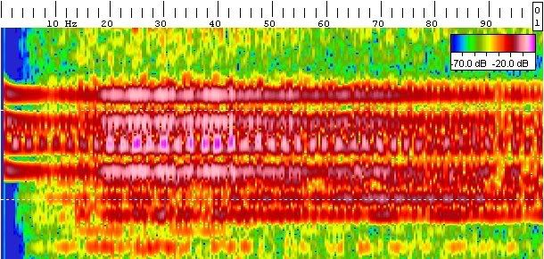

Here's a waterfall of the fireworks recording. There's a little bit of content below 20hz I like the train recordings too BTW. They go pretty low also.

I am going to be trying alternate positions other than the Front position you see below. I like the sound of the current location but I miss the tactile I had when near-field behind the LP.
Ports' facing the front wall isn't an option as it requires 8" of space to the wall and I am going to go with a larger FP screen that will prohibit that placement.
My two preferred options are stacked in front with the CC sitting on top (the current CC base is detached). I will use a pair of Subdudes to decouple the Center from the subs and add an extra bit of height making the center at approx the same height as current. The other option is stacked in the back of the room. My questions is if stacking them flat, should the ports be aligned or on opposite sides. In either case the top sub would be farther from the floor boundary and I'm wondering what if any issues that will create.

First off, I'd like to thank Brian (InPhase) for his assistance in moving the subs around the room and his general HT knowledge and expertise. After moving the THSPUDS to stacked front n center, then the same stacked placement in the rear of the room and then flat, side by side with ports aligned, I am back to my front vertical placement (per the previous photos).
As much as I love the extreme tactile feel of the nearfield placement, the shaking was just too much for the SO. Also, when firing from the rear into the seat backs the bass energy is more easily localized and I found that distracting and unnatural. It may be that the perfect location is under the seats as was the designs intent but I have not tried that location due to some other factors like current seating width.
It is really an amazing that a sub with just two 8” drivers can produce this quality and quantity of bass. For the time being, I am going to live with the industrial looking front sound stage of the JTR’s and THSPUD. It is a look that I and the SO have come to like and as the room is dedicated there really is no compelling reason to change.

It was fun to hear this pair of incredible subs. The clarity of Danley products is always a wake up. I'm used to large sealed subs, and the Danleys reveal details in the bass that I have never heard. It is always nice to get to hang out with others that share this disease, I mean passion.
Really? You went back to front placement? My inclination is that the front placement will always provide the most natural bass. Just out of curiosity, did you ever try standing them up and having them aim lenthwise out from the front wall towards the listening position? (I know this is ugly and won't be permanent, but I'm curious if their are any noticeable sound differences.) Are you leaning towards flush mounting them?
Yes, all your good work was for naught.
The stacked or flat front positions are not acceptable even to my very flexible aesthetic sense. I’m sure it would sound very good and perhaps a bit more tactile but after re-locating them to the front and re-playing the Dark Knight scenes we watched, the bass was very impressive. I could go on about it but you really need to come back and hear the front location bass for yourself. I will say that if you liked Peter’s DTS20, I think you will like the THSPUD's in the front placement a lot.
The question of flush mounting ties into my video issues. At this point I am leaning toward a false AT wall as that would provide me the most flexibility … plus I’m tired of sheetrock dust.
Thanks again for your help yesterday.
