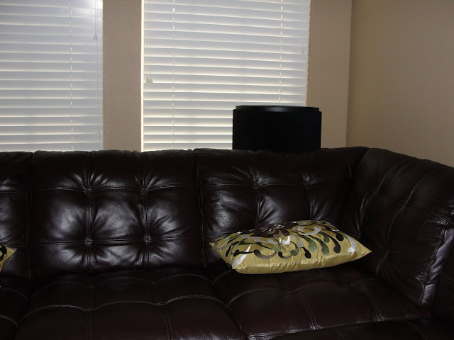

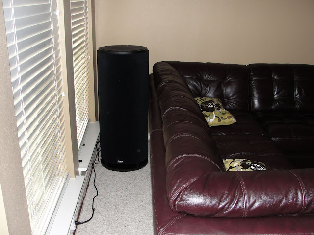

Thanks. I just stood the beast upright, and it might have sounded a little better; however, with it being so close to the listener (the port is at ear level @ a close proximity), the bass is MUCH more localized.
I tried playing with the PHASE settings to see if that made a difference. My ears did not find a difference.
I guess the Velo was well positioned and optimally adjusted for the best room response. Maybe I should not be doubting the PC-12+, but giving a little more respect to that little Velodyne DLS-3750. The Velo was surprisingly able to get to sufficient SPLs for the room size. I have to give the PC12+ credit, because it is nice to hear frequencies that the Velo could not even touch.

OK PC12+ family, I finally got REW running and here are my curves comparing my old Vleodyne to my new PC12+. Anyone know if the built in PEQ can help in this situation?
BTW, look at my posts above to see my current situation of dissatisfaction.

Sorry to hear of your continuing troubles.
I've read all the posts and (assuming there is no mechanical issue with your PC12+) suspect that the problem resides in your particular combination of your listening position and sub placement limitations.
Your room has such a dip at 30 Hz that I don't think will be able to get totally fixed with an equalizer alone. Most of the stuff I have read suggest treating the room first (bass traps, etc) before investing in a lot of new equipment.
That said, if you can't move your sub--can you adjust your listening position?
I also wonder if eventually perhaps you might be better off getting 2 small subs (which would allow perhaps more flexible placement) and would perhaps offer a smoother bass response over a wider area. That's part of the reason I ended up with 2 (I have two PC12+ instead of 1 Ultra).
Good luck!

Mvp2005fan, that is some GREAT advice. I really do appreciate you following my situation and for all your help. THANK YOU!
I am pretty much stuck with the seating position and the positioning of the sub; however, I can place a second sub on the other side of the sectional. The only problem is that it opens directly into the kitchen.
