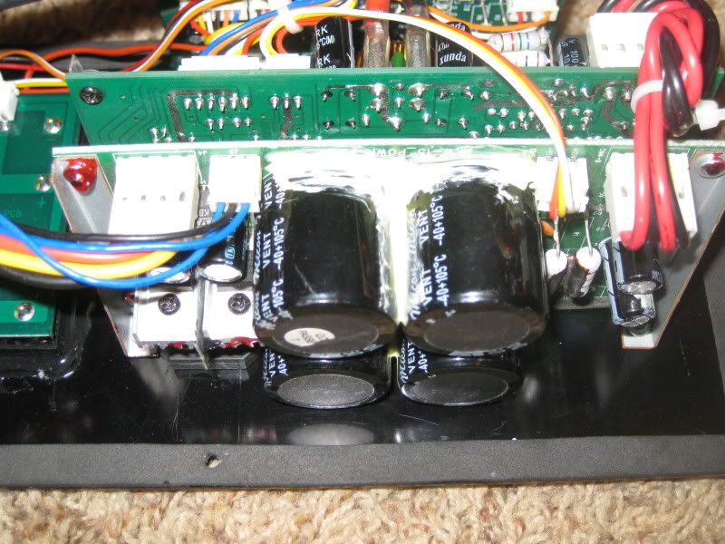

Completely new?
Not sure it does have different capacitors and some "cooling Gel" around them?? I am not sure...I took a few pics upon unpack and now amp is installed. I will post these pics but If I have to I can take amp out and get some more pics.
Here is the old on the left and new on the right...
And the "Cooling Gell?"

anyone with electronics knowledge care to shed light on the "gel"? Is it just for stability (like a glue) or is there another purpose? I have seen glue used quite a bit to strengthen. Also, I have an old Sansui amp that has some whitish stuff around all the caps, including between the cap and the board.
I'm not positive in this particular case, but it could be to "bond" everything to the board for heat dissipation.

I suspect that it is not a gel, but is white silicon adhesive. The capacitors are rather heavy compared to the support of two thin leads soldered to the PC board. In a heavy vibration environment, as these are, the vibrations will stress the leads. So, they bond them to each other and to the board for support. Some companies use hot glue for the same thing. My only issue with what I see in these pics as well as pics of Indigo amps (they use hot glue) is the sloppiness. I know this is not meant to be seen, but still....
