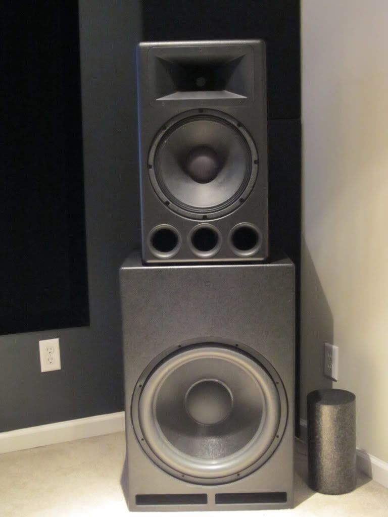

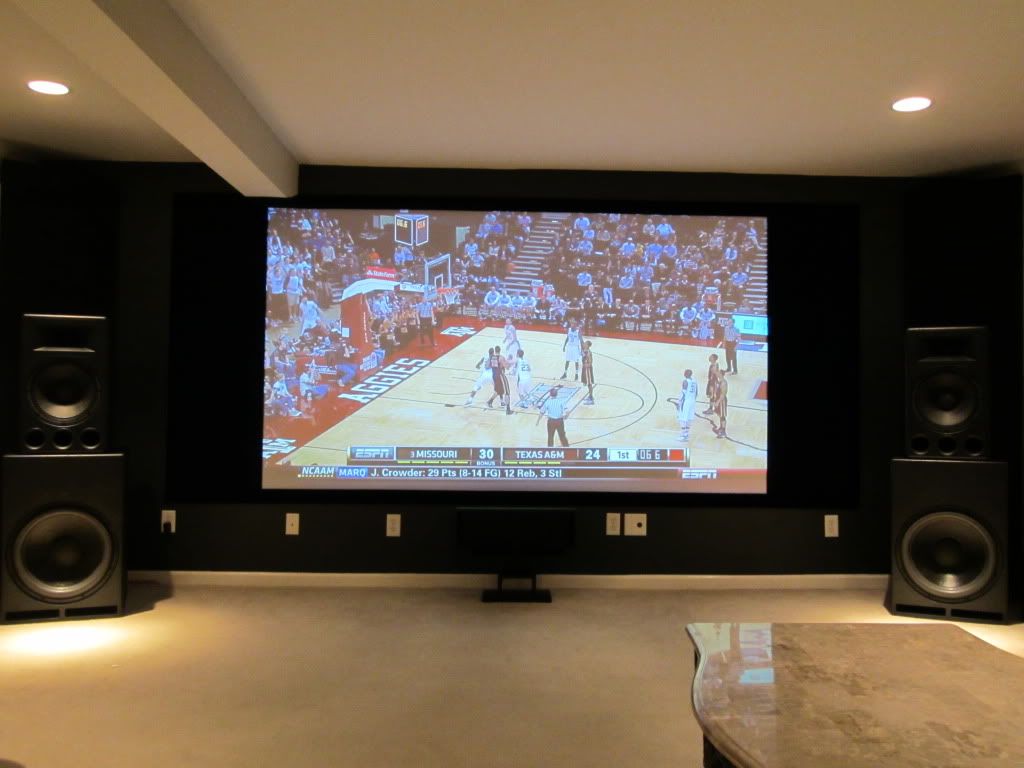

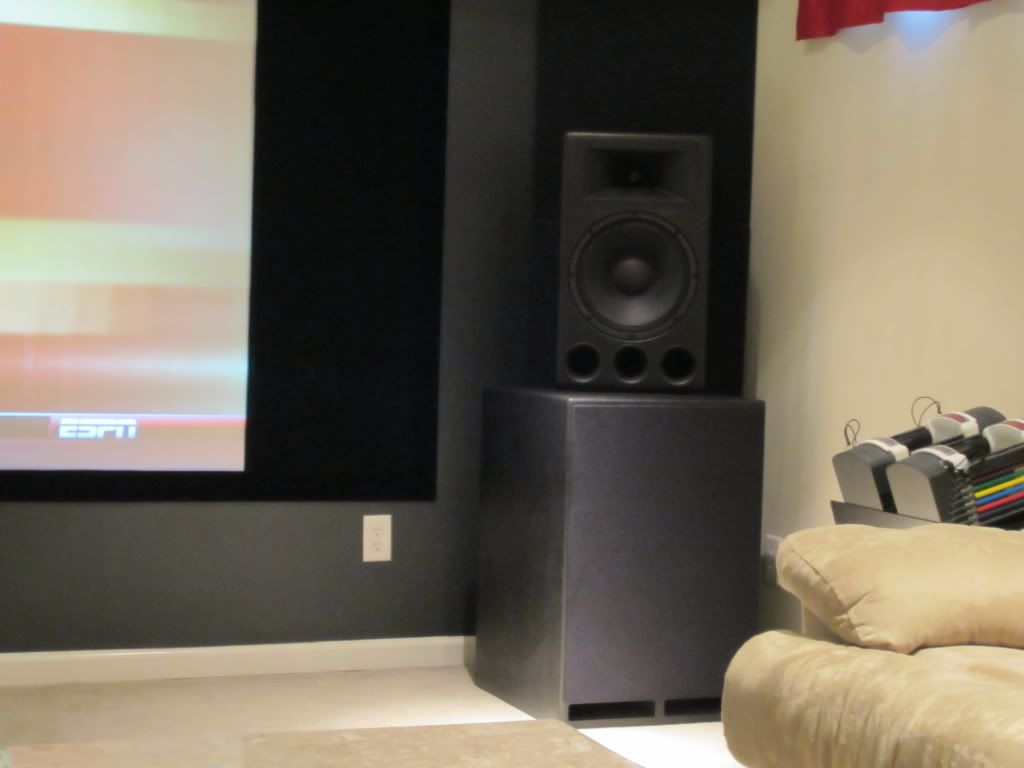

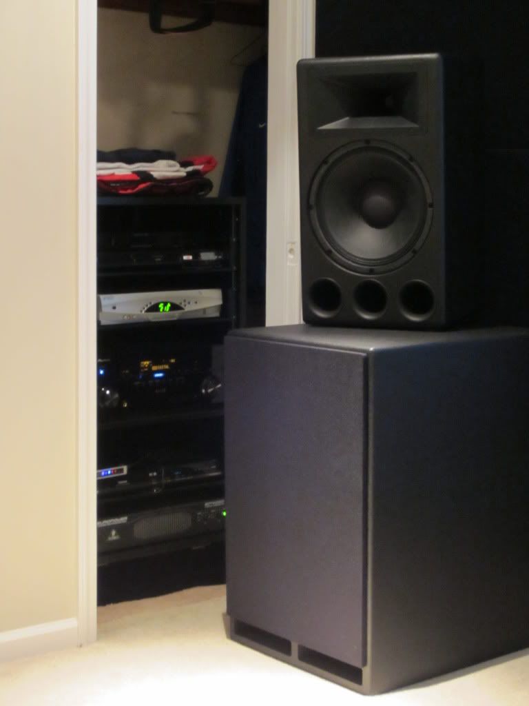

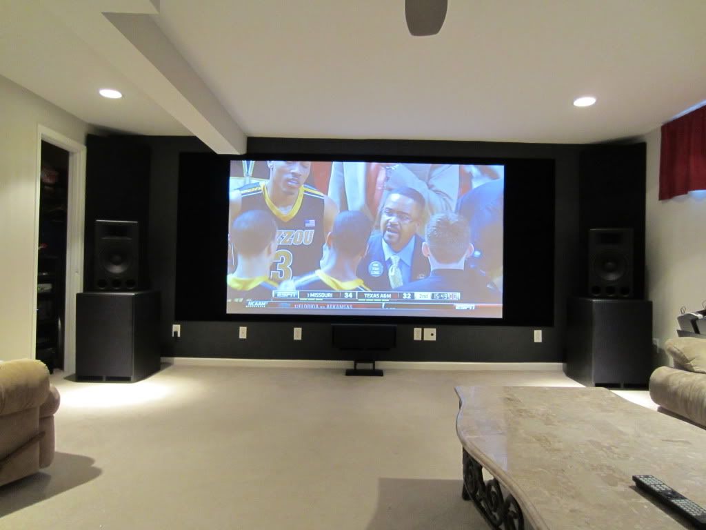

My Caps have new friends.
The grills for the speakers are supposed to be shipped next week, I think that will look better. Loving the Cap/eD combo.

Looking good Carp. How do they sound?

VERY pleasantly surprised. I have Magnepans that I love for music but weren't giving me the dynamic range I wanted for movies.
When I went with eD I was thinking I might have to run 2 sets of speakers, one for movies one for music - I know that sounds crazy, but I have become just that with this hobby!
I am loving how the eD's sound with music. I boosted the treble a bit on the mcacc eq on my elite and they really do sound very similar to the Maggies for music, with the added bonus of not falling apart when you stand up or move around the room.
For movies, these things have crazy output. I usually watch at -15 with the Maggies on the master volume but I was at -9 last night. I assume that's because the Maggies sound louder because of the distortion, there is none of that with the eD's.
So, I'll be selling the Maggies shortly.

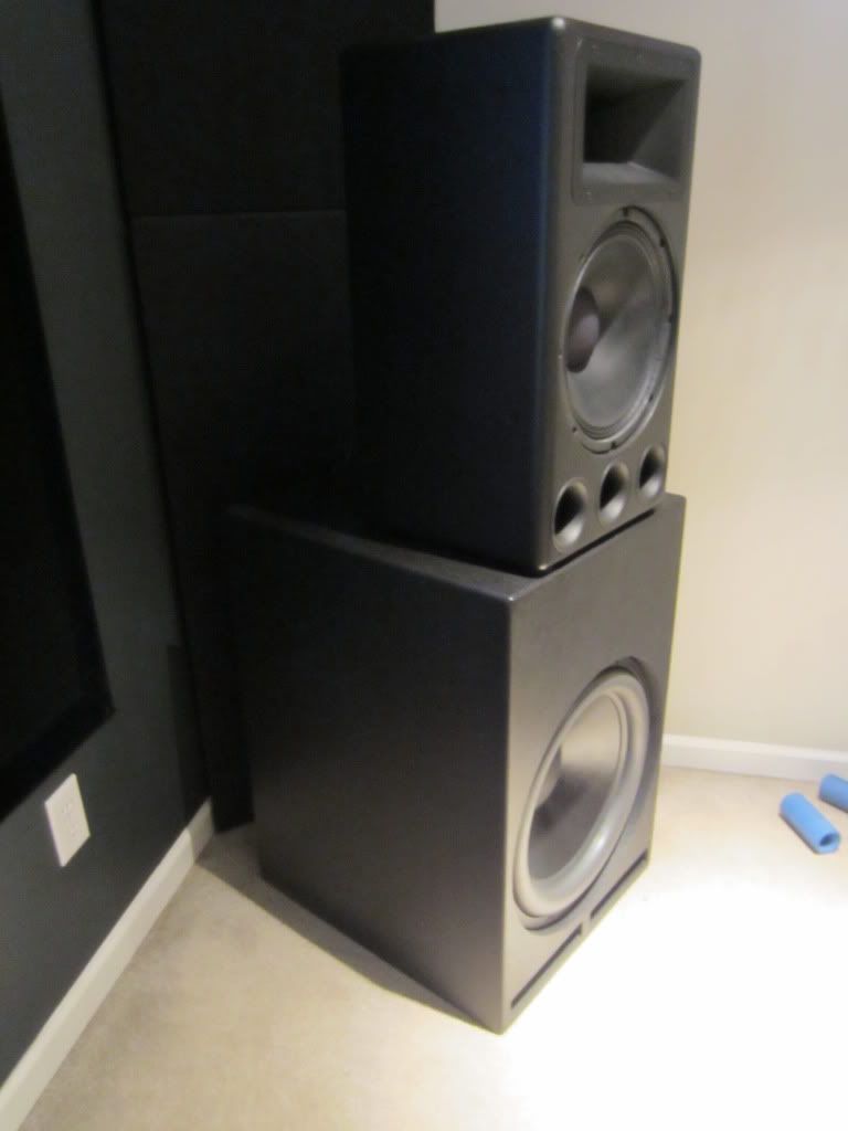

Wow, I knew the dimensions of the cinema 12's, but they look really big on top of the Captivators. Your HT looks really nice. Are the c12's matte finished?
I like the "Naked" speakers!
I too knew the dimensions but yes, I agree, they look much bigger in person. I like that though, they look better sitting on the Caps being so large I think.
No, just the basic finish. Matches the Captivators very well. The matte finish would look nicer but would reflect from the projector a lot more and wouldn't match the Caps as well. That and saving 40 bucks a speaker made the decision easier.
