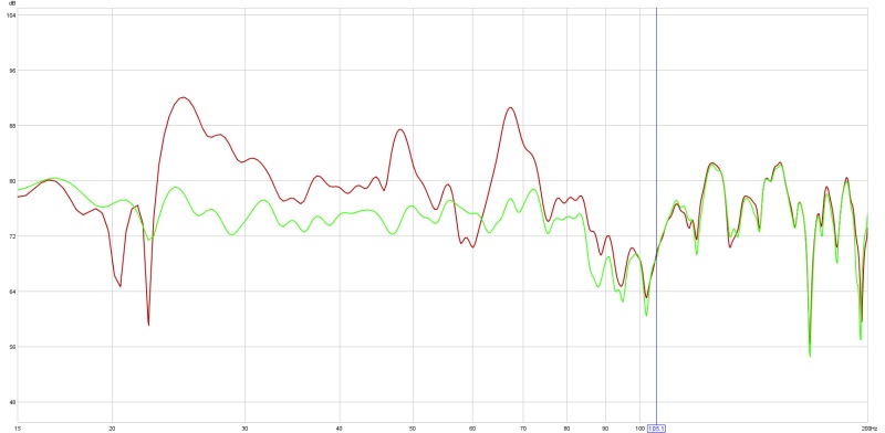

This is my final before/after for what I currently am running with, although I made a few minor +/- 1dB changes to the BFD filters since I took this. And the graph has no smoothing applied.
I think I ended up with about 11 or 12 filters. I start with the big cuts to bring down the big peaks, then bring down other areas, add / split filters to attack a peak in pieces to keep from bringing the surround freqs down too much. Then after all the cut filters, if any freqs were inadvertently dropped from other filters, I bring them back up to about zero. And then I tweak filters, sometimes add a few - 1~2dB filters to smooth it out a bit more. And you can see that I brought up the 22-30Hz range as well. I haven't noticed any issues in doing this. My sub has two modes that change the tuning. I run one port plugged for 20Hz mode, and the both ports open mode for 24Hz~ tuning has a lot stronger bass through 22-30Hz (it's like a plateau) but drops off pretty steeply around 20Hz in my room. So I eq'd it a bit to give me more of a slope there. I could have brought <22Hz and >30Hz down a lot more to leave a natural slope at 22-30, but I didn't want to cut other areas more than I already had (which, as you can see, was already 10-20dB cuts for the big peaks).
To find best phase setting, I took measurements with both 0 and 180, and looked for the smoothest transition. Then I recently learned about using the sub distance setting to tweak response. I previously had it set at the actual distance plus one foot for 1ms of delay for the BFD response time. But once I tried the sub distance setting, I was able to set phase at a specific setting, then tweak the distance to bring the peaks above the xo point into line (see the graph with the various sub distance settings in my previous post).
I don't know enough of the technical side of it, so maybe Brian @ Rythmik can comment, but if the response is flattened out to be pretty much the same, like in the last graph in my previous post, there shouldn't be too much difference in sound. That's assuming the waterfall/spectral decay graphs don't show major differences in SPL after the original sound stops and the sound keeps echoing. I could be wrong, and even if the graphs are the same there could be audible differences because of the phase alignment. I don't know enough of the technical stuff to say for sure.

cyberbri thanks for taking the time to give me a rundown on what you did.
I did something similar... i knew the phase trick re: distance but i was thinking there was a definate way to perfectly ring in the phase.
I use the inverse of mains to and proper sub and then run distance variably to find the least spl (tone at xover).
It's funny you mention how you smoothed your curve which is what i did today... i ran a few presets and listened to music and a few movies and finally dialed in to a smooth curve as it can be...
I do have a super long cable with the spl meter... but instead i just moved the sub to various locations today 10 locations and found a better location for the sub which gives me little to no nulls and gives me 4 peaks... not a problem i rang in some filters on bfd and got a fairly flat response... I think i may Set my phase again tomorrow for 80hz plus the 1ft for bfd and try this again. I was going to order midi setup for bfd but manually is fairly easy its a bit tedious but i don't expect to do filter setting changes very often anyway.
Best addition to my sub is the bfd.
My waterfall does look a bit better as well... though i think something maybe the issue with phase as there is a dip at 85-105hz my xover is at 80hz.
no smoothing and i used 8 filters... i set the filters manually and used rew but i had to manually apply some filters as rew's predicted response was not always 100% what i got.
Also i think the F12 in my square room goes to 11.3hz at -3db

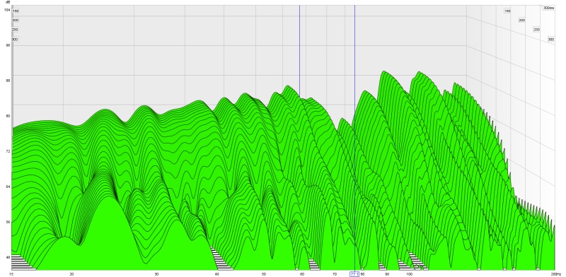

I am glad you joined the discussion. Sometimes I wish we can have a phone conversation to understand the setup and personal philosophy of each other better, instead of via posts. Anyway, can you remind me which track is this the 20hz-100hz sweep? The disc is organized like a book. I wish they had a index for all the tracks they have.
Porksoda,
Some of the things may affect your waterfall are 1) the distance of your measurement position to the wall. If your measurement position is close to walls, you have more reflection wave than direct wave, and 2) the sound absoprtion of your flooring and furnishing. In the past, I had carpet and I also had hardwood. The first thing you notice is the clapping test results. The hardwood floor has more echo than carpet. However, that may not be a bad thing (My personality acoustic philosophy is never make your listen room dry. Stereo image works because of room). You can use other methods to treat the room. But don't over do it. Also it is good to look at the actual measurement waveform if it is based on pseudo random or impulse test signal. You can compare the waveform before the impulse and after the impulse to have an idea of your measurement noise floor. Without a low noise floor to start with, the adjustment may not make as much sense.
Brian,

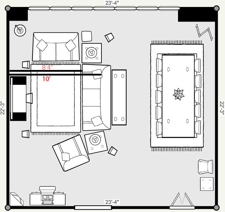

I am about 9' from the wall below is the plan of the room and the sub is located just above the coffee table next to the love seat.
I do my measurements from the sofa middle seat on a tripod at ear level. There is probably a lot of echo/reverb in the room i will try the clap test... but yes the soundstage sounds good. The sub is Very controlled and good w eq but i do miss a bit of the 25hz peak i had... good thing with the BFD is i can have 10 presets and i can set them to WHAT I WANT to have the shape of the curve to.
I was THIS close to ordering one of those automagic audyssey things.. while i understand the market for those press the button and leave it eq's for me i really have to see what the eq is doing and its very easy to use... easier than my cars built in computer.
In any case Brian getting back to the room... my choices on sub placement are limited initially i had it at the wall near the front left speaker... which had decent results but had a lot of sharp dips... this new location i have it facing the wall oddly enough and it is firing onto the loveseat which probably is the best seat to sit on to "feel" the bass but i have no problem feeling it at my position.

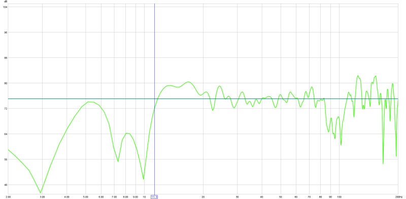

Here are some (older, from back around November) REW measurement graphs of my F12s crossed at 50Hz with both mains playing. I was specifically looking for interactions (nulls) between my left and right mains and also between mains and subs at the time. The frequency response is a bit lumpy due to using MultEQ for a rather large sweet 'spot' targeted to encompass 8 seated positions thus there are obviously going to be some trade-offs made (thus the lumps). If I move from seat to seat the response will change but is basically no worse than what these graphs depict, just different in each seated position. The only real constant is the bump below 30Hz and the last part of that 30Hz centered dip... (I tried everything and I now think its the room). Notice the waterfalls... in the first one I've scaled it so that you can see a full 60dB drop (note the 300ms scale max limit). Unfortunately I did not take active steps to lower the noise floor before taking this measurement and you can see what having fans (projector at less than 3 ft from mic, cabinet fans and two computers with one at less than 3 feet from the mic), the HVAC (furnace heater and fan running) and a noisy fridge in the next room along with ticking clocks etc. do to the noise floor... its rather high. Still I show a relatively tight room. The second waterfall is the same graph but with the scaling adjusted to where REW usually defaults as its what most people that post REW graphs usually scale to. Note its less than 200ms until you get down into the 20Hz region... I think its from the HVAC but it could also just be my room. I intentionally lower the noise floor before running MultEQ (like calibrating in the early morning hours to avoid traffic noises, shutting down all extraneous equipment, etc) but I always take REW measurements with the theater operating as usual with projectors, HTPC, heat/air, etc running as they would be normally during movies/music listening. It is important to realize that MultEQ also operates in the time domain in an effort to reduce reverberation times at all seated locations.... the main reason I gave up on the Behringer approach a few years back was that its mainly used to target a single listening position as the sweet spot, often to the detriment of any of the other listening positions (IOWs, no compromises for the other seats)... also its very difficult to get it to positively affect time domain without also messing with the current adjusted freq response. The conclusion I finally came to a few years back was that the complexity of everything MultEQ does simply at the push of a button (well several pushes really) is going to be quite difficult to duplicate with a Behringer/REW no matter how much time and skill you have... especially over a very wide target area. I only listen to music solo about 50% of the time and I almost never watch a movie alone, therefore I require a larger sweet 'spot' area as opposed to a single listening sweet spot position. Bottom line here is... my FR measurement graph is lumpy for a reason.... but notice how tight the room is? I also have extensive acoustical treatments strategically placed around the room. I personally don't believe that a room can ever be 'too tight' where bass frequencies are concerned. (BTW, I never apply smoothing to bass response graphs... smoothing only makes sense when trying to evaluate the upper frequency ranges because of combing and other effects.)
"For deep bass, the listener is not really listening to the speaker, but rather, is listening to the room as it is being played by the speaker."
