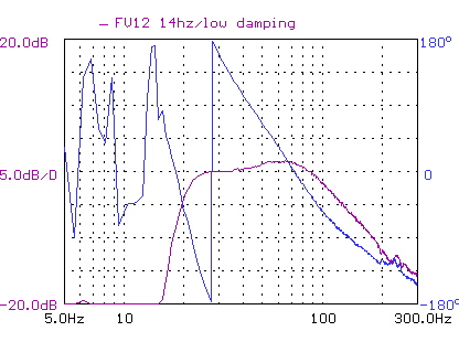

I have using 14hz low damping to get visually the max FR flatness setting (I don't need this is a Butterworth setting, it is definitely more like Chebychev with acceptable ripple). The high damping would have a more gradually attenuation and it would take out some of the ringing. In other words, we use low damping as the ceiling FR that we can accept without adding boominess that is common to vented subs, and all the other lower ringing setting just naturally fall into their places.

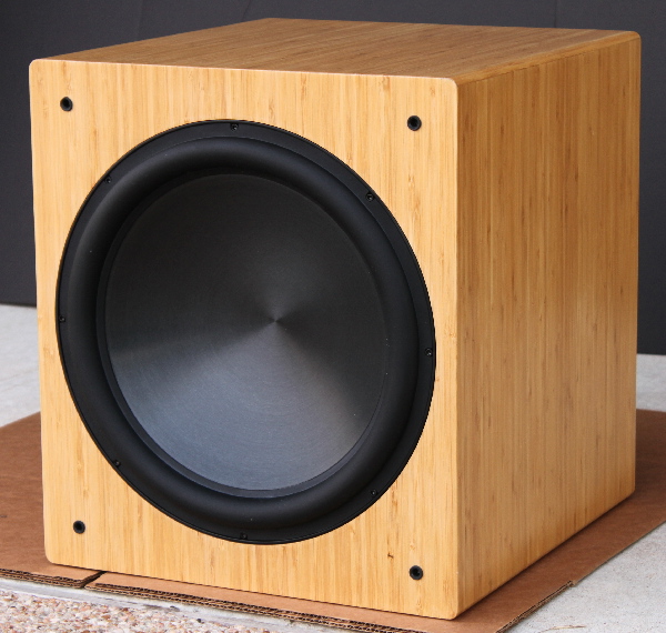

Here is the photo, an E15 bamboo.

Originally Posted by Rythmik View Post
Here is the photo.
That would match my natural bamboo Sierra-1's, stands, and floors perfectly!!
Here is the photo.
Hi, Brian. It looks great, although I think I'll stick with piano black. At least you've finally posted a high-quality pic of an E15.
Here is the photo.
Wow -- looks like they did a fantastic job! I might want that unit, Brian
