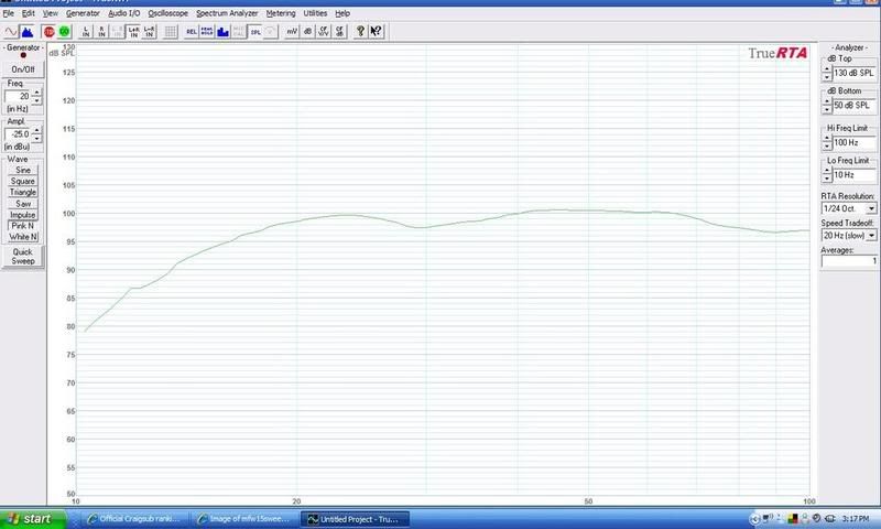

The MFW-15's we have here were the original units as designed by Mark Seaton. Here is the response curve taken at the time:
The MFW-15 as it exists today appears to not have much in common with the unit designed by Mark. While I cannot speak for Mark Seaton, I don't think he would apply his name to the current MFW-15. The amp is different, and it's a good guess that the driver is also not the same as specified by Mark Seaton 3 years ago.
For over 14 months, this qualifier has been listed with the MFW-15:
(Note: As of 3-09, based on many reports of amp failures due to what has been called faulty parts being substituted into the MFW-15's amplifier, this rating is under question until the amp issue is resolved.)
From recent reports, it appears the MFW-15 now has added more than just failing amps to its detriment: It also looks as if the response curve is considerably weaker than the original.
What is being delivered today should really be called the MFW-15 Mark II, and any mention of Mark Seaton being the designer should be removed.

My MFW-15 hits 17hz in my room. This is very common. Where did you get your info?
