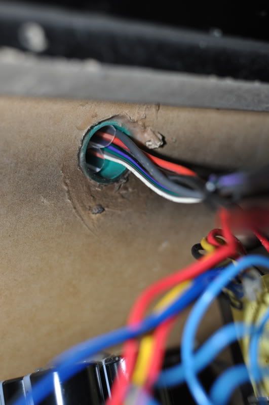

Originally Posted by smjens5 View Post
Great idea, superbabyboy. I have 2 mfw-15's with v3 amps. The v2's I took out have been hum-fixed and work great. I've been thinking of selling them, but haven't gotten around to it yet. I am in agreement that the v2's have a slight edge in sound quality, but they run hot, even in standby. They had me worried enough that I bought v3's. The v3's are lukewarm at most.
Do you think there is a circuit change that could cause the v2 transformer to run cooler? If so, I might sell my v3's and keep modified v2's.
The capacitor swap is genius.
I removed the foam in this hole and put two big straws into it .By doing that,the heat will not be trapped in the sealed cabinet anymore, which will help reducing the temperature in the amp's cabinet.
superbabyboy1984 is offline
Not sure this is a good idea.......
NicksHitachi is offline
I dont know how this can be considered a additional port while the amp's plate is still be sealed in the cambinet.??.There is only one way for the air go in and no way out while the sub is playing.
The original foam did not really seal the hole completely.What I saw it really does was secure wires to prevent vibration between the wires and the tube.
FYI ive sealed my upper and lower "pipes" proper a leaky sub sounds just that.......
I wouldnt count on the plate amp being air tight..... Yes theres a foam seal, but all those through holes and the line level inputs are not.
Assuming the amp were sealed youd be effectively increasing the cab volume and therefore changing the tuning of the cabinet.
Having said all that there would not be enough cooling from the warm air diffusing through those small straws to be significant. Since its a closed system diffusion would be the only air transfer through those tubes.
Just not convinced the tradeoff(s) are worth it in this case IMO.
got it. I forgot about the the cab volume will be increased when I did that.
