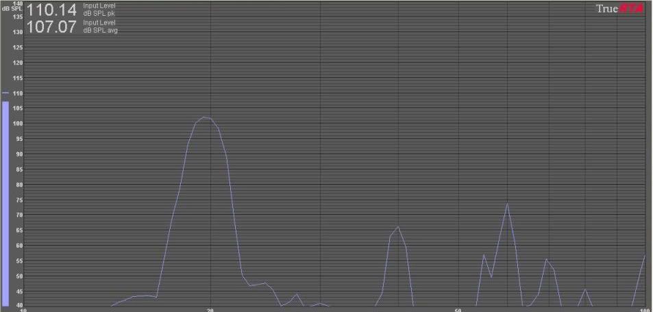

Here is a raw data graph of a CS-18.2 delivering 107 dB @ 2 meters groundplane. As mentioned earlier, it was 85 degrees Fahrenheit for this test.
This was using Tru-RTA's sine wave generator. Microphone was a TEF-25. Caibrator was from Pacifico. Sound card was an M-Audio Mobile Pre.
THD was kept under 10%.

I was just looking at the CEA2010 spec, it allows for a 2nd harmonic distortion of -10db. I see yours is at -36db! Going one more harmonic, spec calls out 3rd harmonic to be below -15db, yours measures -28db.
That's some very clean output at max spl. I had my CS-18.2 playing 107db easily on the Pulse server room scene, and had plenty of gain and composure left to play with, but my ears and body were more than saturated at that point!

The graph I posted above is a 2 meter measurement. We add 6 dB for one meter.
Going to CEA2010 specs, and pushing things to a limit, we have an increase (including the lower temp) of 4 dB across the bandwidth. Yes, I did test with some of this short term measurement method in the summer, the numbers below are not guesses.
When we did our website, I was conservative in our specs - for example - calling the CS-18.2 for 112 dB @ 20 Hz (1 meter). A CS-18.2 will deliver that level with ease and for minutes at a time, not split seconds.
If we are pushing it with these short term bursts - and make no mistake, with allowing a -10 dB on the second harmonic, that is PUSHING - we will see one meter numbers on the CS-18.2 looking something like this:
20 Hz - 117 dB
25 Hz - 121 dB
31.5 Hz - 125 dB
40-100 Hz average - 131 dB
The thing about this short term burst is it won't last long. After the short term burst is done, you will lose about 3 dB in output due to amp limitations. Yes, I did test with some of this short term measurement method in the summer, the numbers above are not guesses.
We all need to keep this in mind when discussing output numbers.
Subtract 6 dB for the CS-18.1 Series 2.

post #567 of 689 Old 11-11-2010, 08:17 AM
JackOften's Avatar
Location: Arizona
Posts: 465
Originally Posted by craigsub View Post
I know many will suggest I am wrong and CEA is right, but I still think long term output is more important than a short term burst.
It would be great if we can get sub manufacturers to test to a standard. I understand your reasoning, but its easy to see that if sub manufacturers just use their own arbitrary testing standards, they'll use tests that play to their sub's strengths... keeping purchasers uninformed.
JackOften is offline
post #568 of 689 Old 11-11-2010, 08:34 AM
craigsub's Avatar
Posts: 11,937
A test I would like to see is how a subwoofer handles 3 frequencies at once for a 5, 7 or possibly 10 second duration.
Example: 20 -35 -50 Hz ... then 25 - 40 - 60 Hz and finally 30 - 55 - 75 Hz.
Something like this, at 2 meters groundplane, with raw graphs shown on LinearX or Tru-RTA would be very revealing of any subwoofer's performance, including what to expect on program material.
craigsub is offline
post #569 of 689 Old 11-11-2010, 09:00 AM
JackOften's Avatar
Location: Arizona
Posts: 465
The Consumer Electronics Association came up with a standard you don't like, but it's intent was to help consumers (like those in these forums) make informed choices.
Without standards like these, sub manufacturers will continue to use tests that play to their sub's strengths and downplay their weaknesses.
I guess some of us (your potential customers) would like to see subs tested by the same sets of rules for that reason, but no one is telling you that you have to do it. You believe that your set of testing provides more information to consumers at the cost of not being able to directly compare craigsubs to other subs who are complying to CEA testing standards. No problemo.
