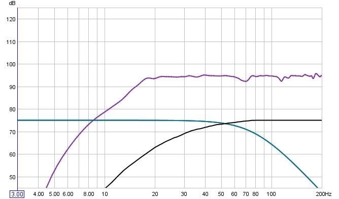

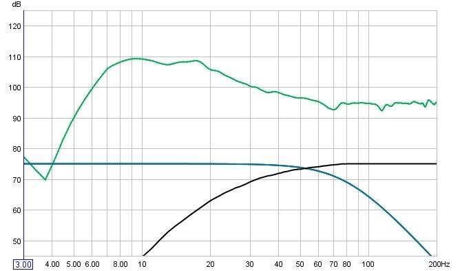

All I know is that this
[graph with what I agree with JPC appears to be a 4th order rolloff at ~40Hz]
Does not sound nearly as good as this with music or movies
[graph showing flat response below 20Hz]
Surely you don't think that anyone is advocating a system that extends only down to ~40Hz?
