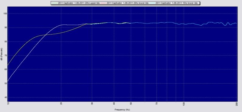

Terminator Salvation starting at 44 min 25 sec and ending at 45 min.
Upper part of chart uses 20 hz HP filter.
Lower part of chart is same scene full range.
Left side of chart is LFE channel alone.
Right side of chart is L, C and R channel together.
NOTE: If chart looks to small to you, use the IE zoom funtion to make the picture as large a you need.

Nice cherry pick there, J.
Do I really have to go and pick out all the dozens of small, sealed builds that are in the DIY section right now that are way, way smaller than my LLT's and were reasonably priced? Would you also like me to personally send you a PM linking my conversion of the LLT's to small sealed cubes?
C'mon.
Awesome subs there, btw.
You can talk the talk all that you want, but until you walk the walk I remain unconvinced. When I see you use a pair of "small" sealed cubes then you can talk about how size does not a matter!
Until MKT goes "small" on a permant basis, I remain unconvinced!

Location: South Florida
Posts: 6,952
Liked: 30
Originally Posted by J_Palmer_Cass View Post
Why is a Captivator arbitrarily cut off at a certain point?
http://forums.audioholics.com/forums...2&postcount=10
Are you asking why the Captivator, a ported sub, is ideally filtered just below it's tuning point? This is not arbitrary, but is a recommended practice for almost all ported subs.
mojomike is offline
