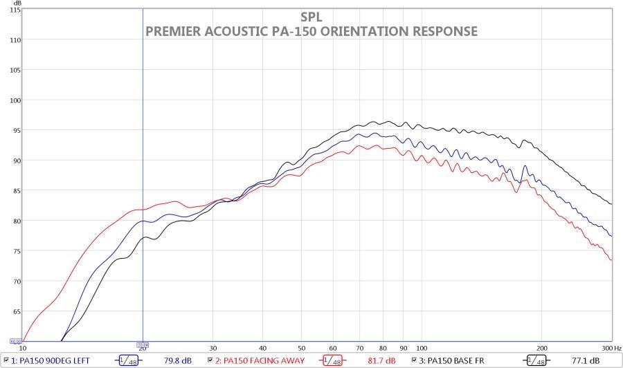

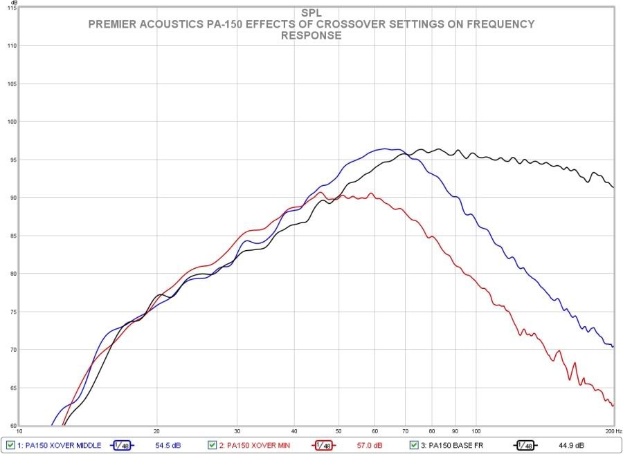

I started off by running a few frequency response sweeps with the subwoofer in different orientations to determine which would be the best to test it in. This is because the subwoofer has a front firing driver but a rear firing port. This will place one or the other further away from the microphone and reduce its relative output. Testing at 2 meters instead of at 1m helps out some in this regard. As you can see below rotating the subwoofer to have the driver front firing, side firing and rear firing did have a notable affect on the response. I ultimately chose to go with the driver forward firing. The reason for this is because it provided by far the most output above 30hz. The other 2 orientations lost anywhere from 2-8db in output between 40-200hz otherwise which is a very big hit. Rotating to have the port side firing or front firing did increase the low end some but this only helped out below 30hz. This subwoofer is tuned to about 25hz and rolls off very quickly below 20hz. No matter how you cut it it simply does not have a great amount of output below 30hz as you will see later. Sacrificing the 40-125hz range for a few extra db below 30hz simply doesn't make sense for a subwoofer of this size and cost simply doesn't make sense. That is the reason for testing it with the driver forward firing. Also keep in mind that since the port was further away from the microphone it's actual output below 30hz is going to be a little bit stronger than what the tests show when in use in someone's room. The actual 20-25hz output is probably some 3 or 4db better than indicated in these results.
This is the effect of the crossover control setting on the subwoofer's basic response. The crossover was set to it's minimum, 12 o'clock and maximum positions. All tests were taken with the crossover set to it's maximum position.

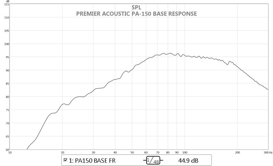

This is the basic response of the sub as used for the rest of the tests. Note that this sub has a nicely extended upper response that very gently rolls off by about 3db by the time it meets a built in low pass filter in the amplifier at about 180hz. This is a nice thing to see after testing so many subwoofers with a response humped up in the middle of the bass range and severely rolling off by even 100hz. I did note during my brief listening tests with the sub that it had a very pleasant sound to it on music tracks. Note that this sub rolls off quite quickly. This is partly exaggerated by the placement of the port relative to the microphone for the tests but it is still 10 to 15db down by 25hz no matter how you look at it. What this type of response points to is that the enclosure volume is too small with the low tuning of 25hz and this particular driver, to produce the low end efficiency needed to match the top end. This results in a gentle roll off down to tune followed by a sharp drop off below tuning. This is not a bad thing in some ways as in use, most people's rooms will reinforce the low bass and bring the low end up some.

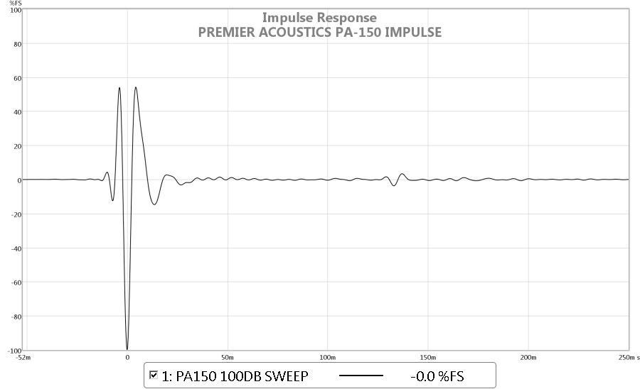

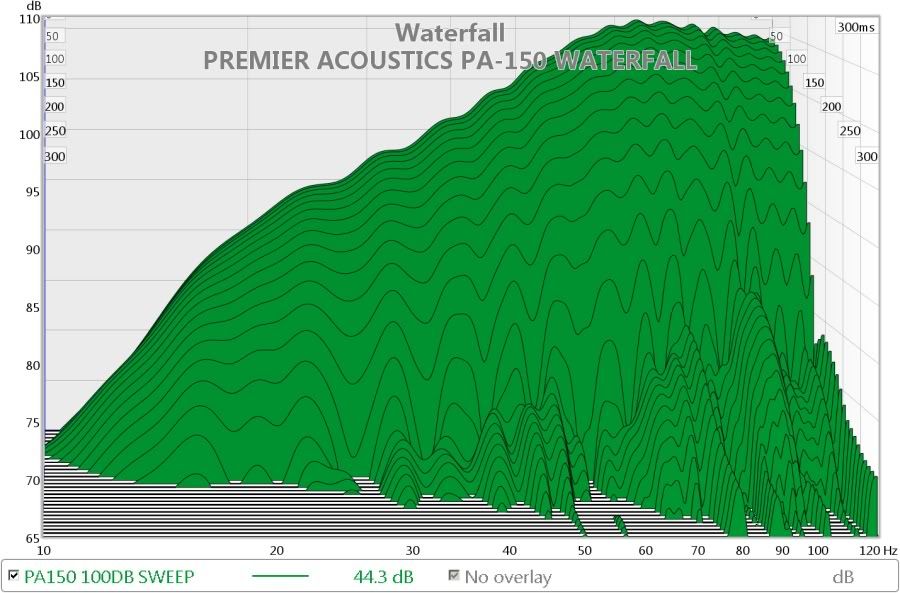

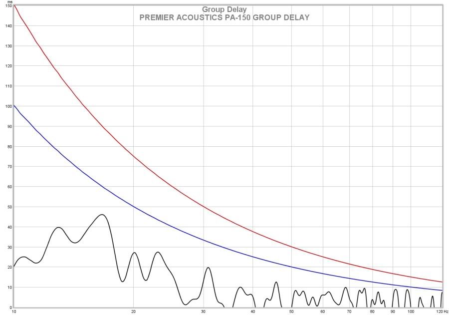

Looking at the time domain measurements there is not a lot jumping out at us to comment on which is a good thing. In general this subwoofer exhibits no tell tale signs of resonances or lingering notes and has a nice rapid decay down into the noise floor. The group delay performance shows more of the same.

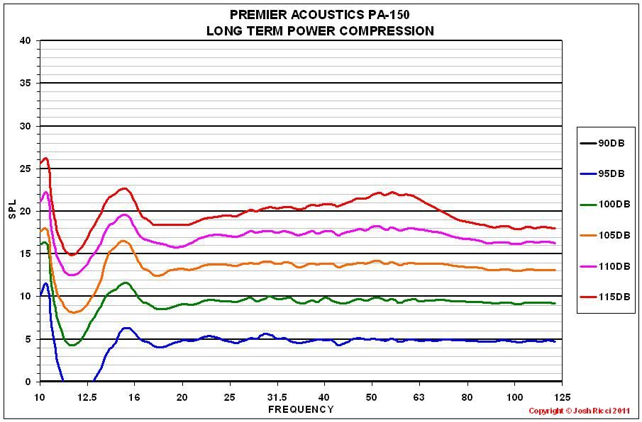

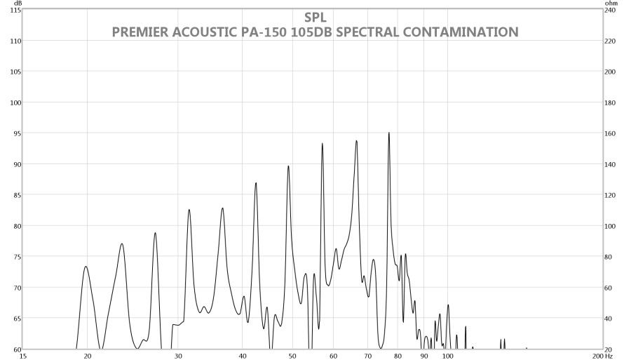

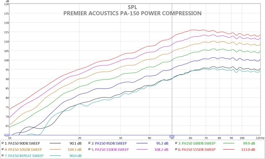

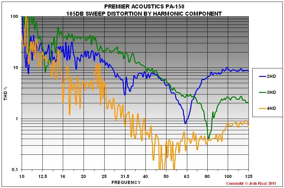

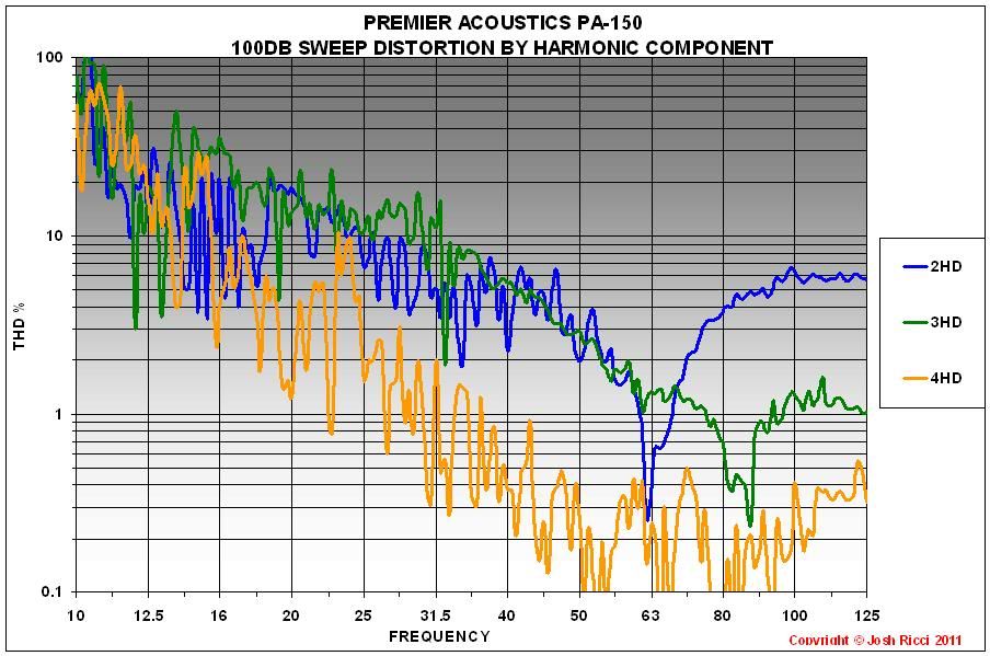

Here we have the power compression test results. This subwoofer surprised me with how much headroom it had at 40hz and above. It actually completed a nominal 115db sweep level which I remind you is referenced to 50hz at 2 meters, so this is equivalent to a 121db nominal sweep at 1m! It did exhibit a large amount of compression most notably above 70hz and around the port tuning 16-30hz. There was also some port wheezing in evidence on the 110 and 115db sweep levels, but the subwoofer never acted in danger. The driver produced a lot of excursion but other than heavy distortion and the port noise the sweeps were uneventful. The 115db sweep I would also suspect had a large amount of amplifier clipping involved. This sub is amplifier limited and it appears that the amp is of sufficient power and the filters built in placed right, so that the amplifier cannot mechanically damage the driver no matter what ridiculous Hollywood LFE effect is thrown into it. That is good. You can have fun with this sub and find it's limits without fearing irreversible damage the first time you turn it up a little too much. This is the way any sub should be designed IMHO, since you never know what may be in the next blockbuster sound track, or what might happen if the kids play with some settings while you aren't there.

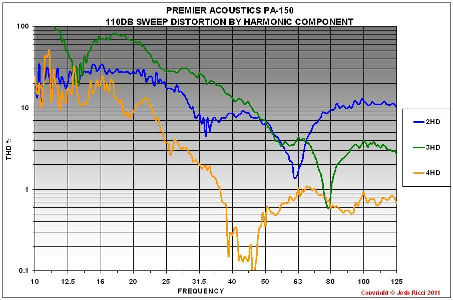

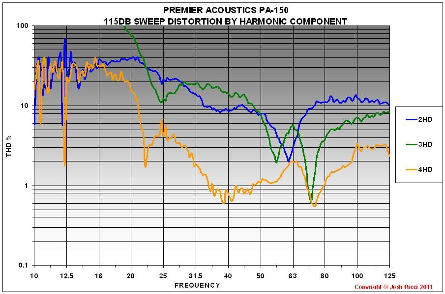

Looking at the distortion measurements the THD is not the best I have seen but not exactly horrible either. The deep bass distortion is rather high. Above 40hz the performance is better. Looking at the harmonic breakdown the distortion above 60hz is dominated by H2 which is good. Below there it is equal parts 2nd and 3rd harmonic. Note the big notch around 60hz where the distortion performance is notably better. This probably corresponds with the upper impedance peak above the tuning this is where the efficiency is very high and the amplifier is supplying very little actual current into the driver, which results in less distortion. Also note how it shifts downward at higher input levels. Remember that, it comes in handy some times.
100db sweep distortion by harmonic
105db sweep distortion by harmonic
110db sweep distortion by harmonic
115db sweep distortion by harmonic

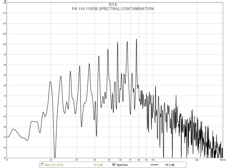

Spectral contamination tests

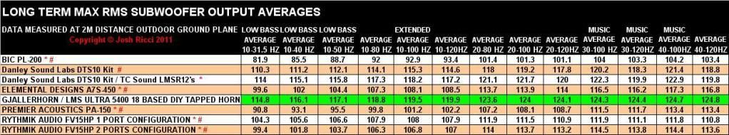

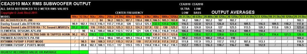

The max long term output for this sub is not huge below 40hz, but it kicks some butt above there and produces an amount of bass commensurate with something larger and more expensive. This data is derived from the maximum output level achieved during the power compression sweeps.

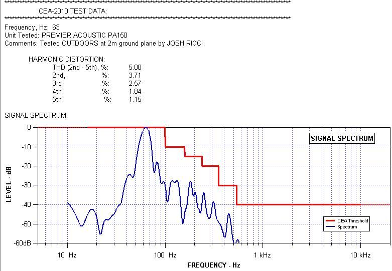

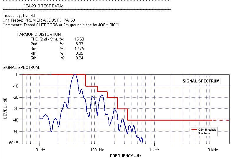

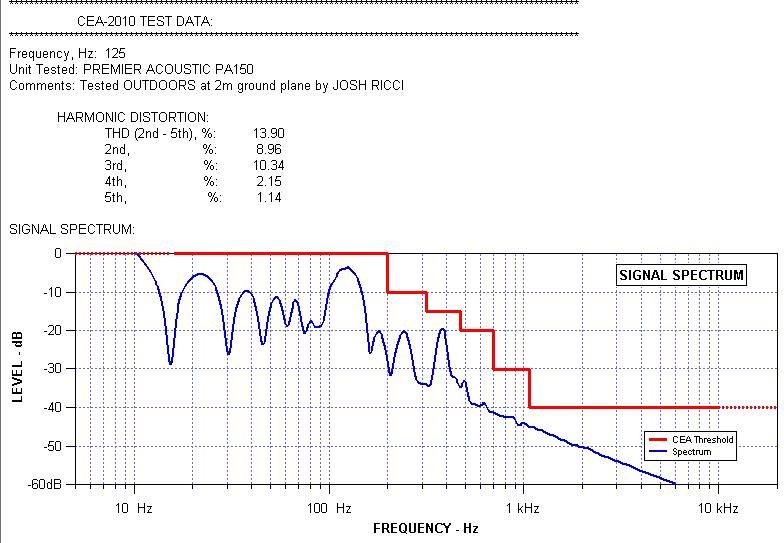

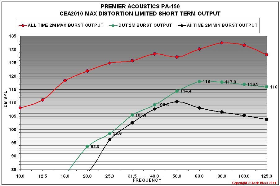

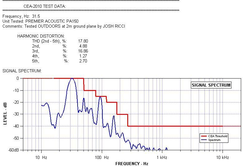

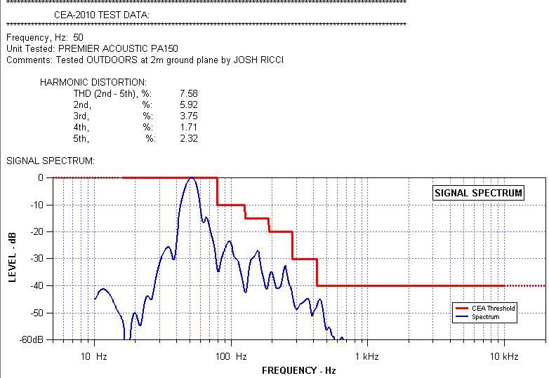

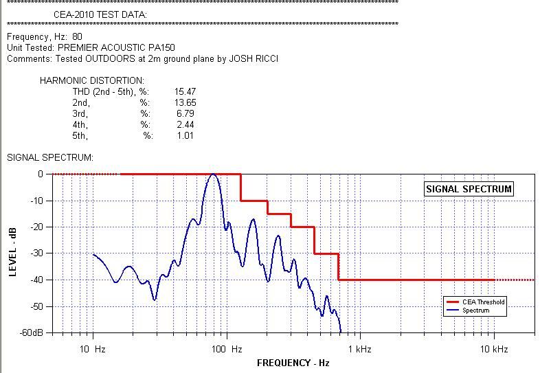

Here is the CEA2010 output data. The overall trends we have already seen rear their heads again here. At 31.5hz and below this sub only does ok. Remember that its output in the low range is hampered somewhat by the port being further away from the microphone so it's real output is a little better than this, but even still it is no 20hz titan that will be knocking things off shelves anytime soon. Once this sub gets to 40hz and above though it starts putting up surprisingly big numbers. At 50hz and above this subwoofer is up there with some much more expensive units.
Attachment 218711
CEA2010 Distortion Results by Frequency
