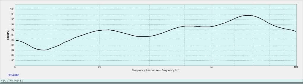

The results? Anyone who tells you ported vs. sealed is an easy 100% obvious choice in a blind listening test is flat out wrong - at least according to our results. [HuskerOmaha comes to mind! -- though I guess when I point one finger at Greg - three point back at myself]. haha - THOUGH I haven't been proved wrong quite yet since I wasn't auditioning the subs and don't clearly have my name stamped all over a completly inaccurate mass guesswork of a score sheet. --. But kidding aside - Why should I think I have the golden ears! -- unlikely indeed... Seeing how the votes were all over the board I would likely fair no better. For the record however I BELIEVE I like the ported sub sound and still feel I own the best overall subs I've ever heard with the Captivator pair --- yes that's right -- my mind hasn't changed.

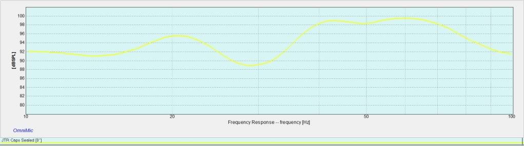

Both HSU and JTR Caps - the two ported subs of the day were both run in the 16hz (HSU) and 15hz (Cap Pros) tune respectively. And let me just tell you that the ported vs. sealed argument is pretty much put to rest. Nobody knew much of anything between what was what, and wild guesses abounded for most every sub. It was humerous to those of us collecting the votes after each audition -- I collected all original score forms which I will scan and post here. This was agreed apon in advance with each forum user willing to participate in the voting agreeing that their scoresheet would be public. 9 of 12 auditioners decided they wanted to participate in the blind voting and were willing to have their scoresheets posted. The other three voters either chose to not participate in voting or would only be present for a partial day.

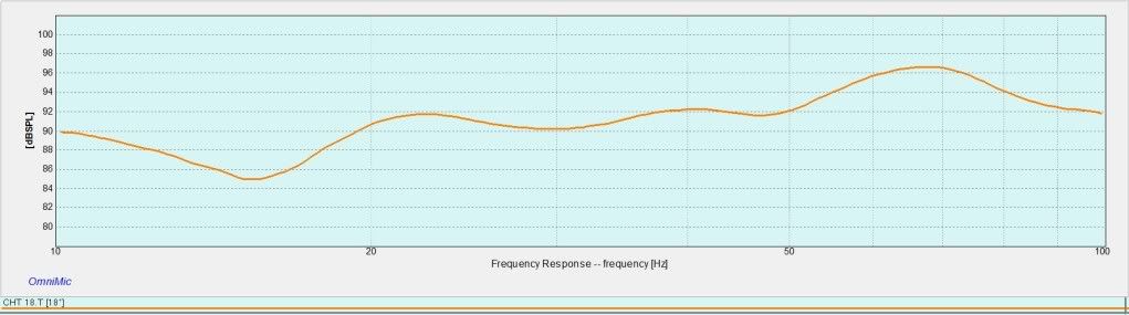

Could each sub have sounded better? - probably --- Audyssey probably did some subs a favor and hurt others
Did Audyssey manipulate the 100hz and above FR spectrum to various inequities in listening? - probably - we didn't even measure a full range 10-20K hz spectrum. Audyssey is known to cause variance there - take that for what you will. The subs were calibrated fairly consistently as you'll see. They were all within a few dB, and there was between 45 minutes and 1.5 hours between every single audition. No subs were demoed with less than 45 minutes of time elapsed between them -- this break for each sub setup allowed for minor dB level changes as configured by Audyssey to be less impactful. IE no subs were A/B'ed immediately after each other. Someone might suggest that the loudest sub would clearly win the day or the sub with the flattest EQ would dominate - that was not the case. The flattest average frequency response was owned by the MFW-15 DIY Dual opposed by far when averaged over 12 seats. That may be because it was the only setup run off a single sub out. Highest peak spl belonged to Cap Pros and Orbit Shifters. (post # 3 contains FR and SPL numbers from meet day) All three of these setups scored midpack.
Could each sub have been manually EQ's better? Or shouldn't you have used REW + EQ? - I'm sure, there are better alternatives. We lacked the REW knowledge to pull off the REW + EQ (except the vendors and desertdome - and desertdome wanted to blind audition). Furthermore Audyssey is much more relaxed than the extra stress that Michael was under at the HuskerOmaha meet in 2011 running REW + EQ on each sub. In the end Audyssey curves were banded to look very similar, SPL readings line up with expected capbility, and there are no major outliers on anything IMO. LOTS of people run Audyssey in their home and these results may are at least standardized to a tool that many would have access to. The Audyssey results in another room than mine would obviously vary some -- but grip or complain - it's the path we chose and if you don't like how we did it. Feel free to stop reading here because you won't care about anything else anyone has to say.

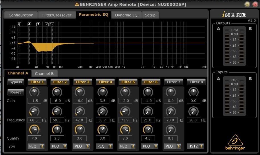

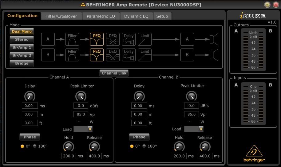

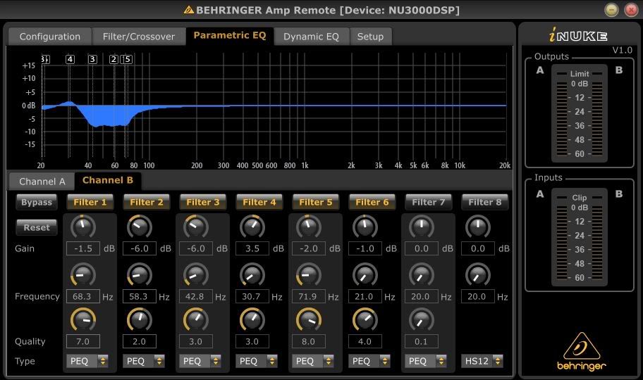

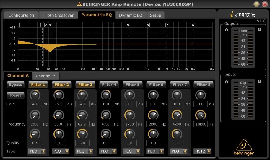

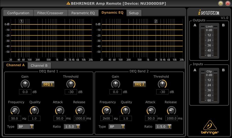

It can be argued that the two subs running on the INuke DSP3000 - the JTR Captivator Pros and the CHT 18.1 subs did not preform as best they could. The INuke DSP 3000 amp was overloaded and power cycled 3 times during the Captivator audition during the most intense scenes. The INuke amp was also used on the CHT 18.1 subs with a boost at 20hz, to level the FR graph prior audyssey - specifics are in the #3 post. The CHT subs encountered hard clipping during the some of the most intense movie material(no power cycling), but I do not believe the amp contributed to any issues during the music material for either sub as demonstrated based on further testing. The clip lights did not blink on the amp during the music material for either sub over the range of music material. For the record the clip limiter was NOT engaged with the INuke DSP amp. The INuke amp may have caused both of these competitors a bit in its shortcomings, but it also very much aided them in acheiving a much flatter frequency response graph through the employment of the integrated DSP which was configured and saved for both the Cap Pros and the CHT subs prior the blind meet. The DSP settings and prior Audyssey graphs for both Cap PRO and 18.1 are provided in post #3. The HSU VTF-15H may not have been run in the most favorable EQ setting because we were looking to use the 16hz tune in an unforgiving room to more closely match the sealed subs response - potentially limiting the HSU's available headroom. These are just points of note, but do not disqualify the results. Some of the other subs also had artifacts of the Audyssey setup process standardized for all subs. For instance the Cap sealed showed a significant and unique dip in comparison to the other subs at 30hz - so nobody will say our testing was completely without variables, but we did follow a very standardized procedure in setup and to my knowledge made absolutely no mistakes or deviations in our agreed upon procedures. We did some retesting on Sunday January 15 with the CHT and HSU subs and we (Tesseract67 and Luke Kamp) documented all the testing data in following posts in this very thread. Nothing appeared out of the ordinary during the retesting. To put it bluntly the subs ranked as they did because that's the way they preformed under identical setup conditions using standardized Audyssey MultiEQ XT settings. The scores realized were done so in blind testing with nine enthusiasts' opinions voiced. The INuke amp issues should not be discounted as a setup errors, Both Cap Pro and CHT were auditioned before the meet and the issues which occurred during the Saturday blind testing were recognized in previous testing Wednesday, Jan 6, for the Cap Pros and Friday, Jan 13, for the CHT subs and thus were to be expected by the subwoofer owners. There is some retest data discussion, observations, and frequency response charts available from our additional time spent on Sunday January 15th with the HSU and CHT. The retest data may provide some indication of what Audyssey did (or didn't do) to each of these sub's frequency response. This information is shortcutted via the following links

Sub A:  Dual HSU VTF-15H
Music Score:  72 (6th place)
Movie Score:  365 (6th place)
Originally Posted by stitch1 View Post Sub A: My score shows it to be smooth accurate lacking a bit in depth and was “great” for music. I didn't love this sub. I may have even scored it a bit higher then I would have it it wasn't the 1st sub I heard. The only clip I gave it a fantastic was the john mayor song as I felt it represented the kick drum and bass guitar well. Again I think I may have over rated this sub at 41 overall. I do believe this is a sealed box.
Originally Posted by HuskerOmaha View Post Music/Movies Score (/) Sub A: (8/42) I wrote that I thought I could feel BHD on movies a bit. Someone said there is a 20hz and a 8hz? on speclab of this. I wonder if we ever felt the 8hz. I couldn’t feel anything on Vikings (Poop and Pipes from the Omaha GTG;)). Initially I thought maybe these were the Caps. I wrote tons of guesses through the night, but you can’t really finalize WHICH SUB you think it is until you have heard them all. Guessing seems futile. I thought this sub was overall OK for movies. Nothing really wowed me, nothing sounded terrible. I was kidding on my sheet about chuffing. I didn’t hear any all night, but at the levels we were listening (115-120 Hz average?) in my seat…how could you. Bunk. I initially voted this as ported, but after hearing the rest, could be a lower sealed sub. The output didn’t appear to match that of several others, leading me to think of them as smaller drivers or less displacement per science. I’m sure I’m an idiot on this one. Guesses (in order of my fake confidence): 1) HSU, 2) Cap Pro
Originally Posted by thebuckaman View Post Sub A- I thought this sub sounded ok for music and movies. It didn't seem to do anything special but sounded fine for most of the music movie clips. Going with HSU
Originally Posted by carp View Post Sub A: Now were talking. Much better than the Klipsh. The music clips were much clearer and punchier and the bass didn't linger. One of the best subs of the day.
Originally Posted by jedimastergrant View Post Sub A was a step up from the Klipsch in extension and every other characteristic especially for music, but I was not blown away at any point with the movie clips. I found myself hoping that there were much better subs in our future and that was indeed the case. I still felt it was a solid sub and I did not feel like it did anything wrong. Nor did I think any of the subs ever really put out a bad sound.
Originally Posted by desertdome View Post Sub A - These subs were with Sub d and the Klipsch in not sounding very accurate. Many notes were smeared together and the music just didn't seem enjoyable. For movies they performed much better and I had many ok to great ratings with even 4 fantastic ratings. I indicated on my score sheet that it sounded the best with the Book of Eli, Drumline, Iron Man, and Matrix Revolution clips.
Originally Posted by wlelandj View Post Sub A: For music, while I found it smooth and accurate with good depth, it just seemed subdued hence the lower "fun" rating. It did well on the lower end of the spectrum, but thought it lacked punch higher up. (CapS?)
Originally Posted by kwarny View Post Sub A - I gave this mostly 1s and some 2s. I disliked this for music. It sounded inconsistent throughout the frequency range and somewhat bloated but much cleaner than the Klipsch. It was okay for movies but lacked the impact or tightness. I guessed ported. It sounded like the JTR Cap Pros from the Omaha GTG.

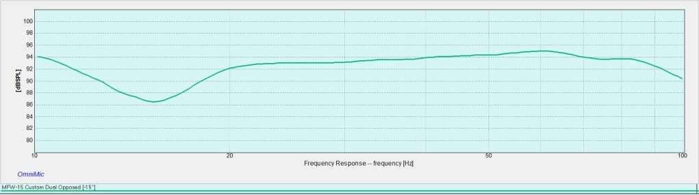

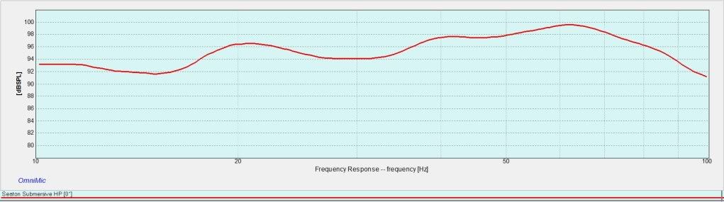

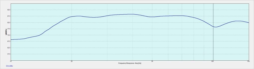

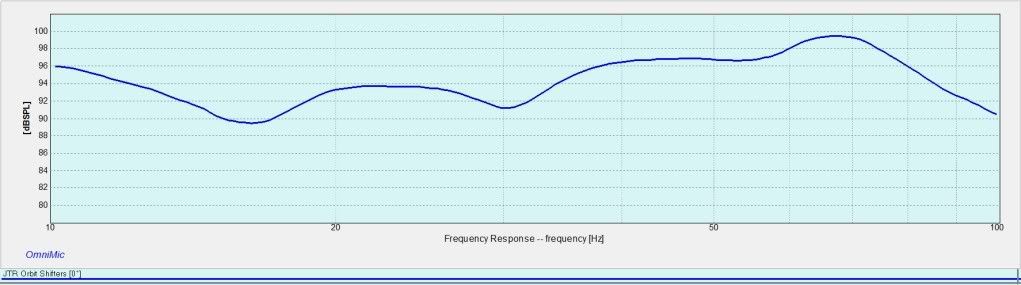

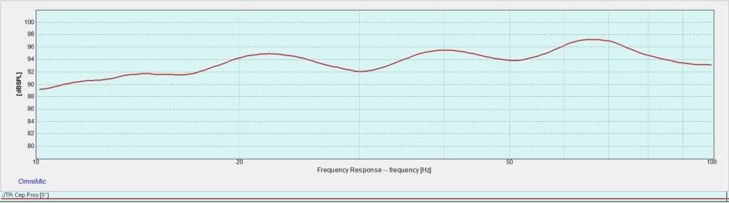

This post will denote the frequency response taken once from all 12 seats and averaged to produce a single FR for the test. It should be remembered that these frequency responses do NOT represent a single position, or the Audyssey calibrated position, but represent the average for all seats residing in the "Audyssey bubble". The same exact person, Luke Kamp, held the mic in the same way for every single one of these frequency response graphs. He rested his hand on the back of the chair and held the omnimic facing up. The chair leg positions were marked in tape on the floor and chairs reset to their original position before every test. Blain helped us gather one fr graph, and that's the one we video taped - I'll be uploading videos later, but we ended up redoing it with Luke holding the mic to ensure there was as little variance as possible because Blain was holding the mic aloft rather than resting the hold on the chair back like Luke was doing.
Also I setup the omnimic to record SPL before every test and at the end of the ~35 minute demo session for each sub just wrote down what the peak SPL recorded was over the entire demo material. Keep in mind everything was level matched by Audyssey and omnimic graphed before the start. Some of these variations might surprise many of you. These max spl measurements were all taken from 17 foot back from the nearest subwoofer in the back of the room at the "command table" The response back in the rear of the room is muddy and peaky I'm guessing because it sure sounds a lot worse back there! Mark suggested I get a FR reading from the place where the SPL reading mic was set, and I think that's a good idea and hope to gather that soon so we can see at what frequencies the SPL may have been peaking at. The readings were taken with c weighting and slow response times through omnimic. Again - each time it was reset for the music section and left on the entire demo session and the max for the entire demo session is all that was recorded. Every sub hit their max SPL during the movie section. The mic was placed in the exact same position for each reading. You can see the mic's position in the movie I'll upload to youtube soon.
All calibration was done by Audyssey MultiEQ XT on my Onkyo TX-NR1007 receiver. After Audyssey was run the following steps were followed for each sub.
1)Run Audyssey using five positions. Main listening position directly underneath projector, then the two outside chairs on each row.
2)After Audyssey completes verify no sub level gain at maximum negative trim (-15), if so reduce gain and run Audyssey again.
3)After successful Audyssey completion - turn crossovers to 100hz
4)Turn off Audyssey Dynamic EQ (Audyssey EQ was left engaged)
5)Add 3 dB to each sub output (sub 1 and sub 2), in the unique instance of the MFW-15 dual opposed DIY which used a single sub out to the amp we used +6dB on the single sub out -- level matching was confirmed with omnimic and SPL meters to be the correct amount of gain added. The MFW-15 dual opposed graph is also middle pack in the FR curves, as you will note when the final results and individual labeled FR graphs are posted - so no issue there. Everything else Audyssey calibrated and we left it alone except to increase the sub dB by +3 on both outputs.
6)Take frequency response reading in each of 12 audition chair positions. Luke Kamp held the mic in each of the 12 positions for every sub on every demo. I averaged the captured value using omnimic's built in functionality, while not looking at the screen so as not to manipulate the results. Tesserract67 was responsble to make sure to make sure the omnimic mic continued to work (our USB cable kept trying to unplug when we were moving around and we'd have to start the 12 position gathering again). With this technique we got a single omnimic graph reading to account for the average of the entire listening area accoustic 'bubble' that Audyssey created. You won't have per seat readings from this meet because they've all be averaged and not saved individually. What are you going to do with 12 readings per seat times 7 subs? You want a chart with 84 FR overlays? I don't either.

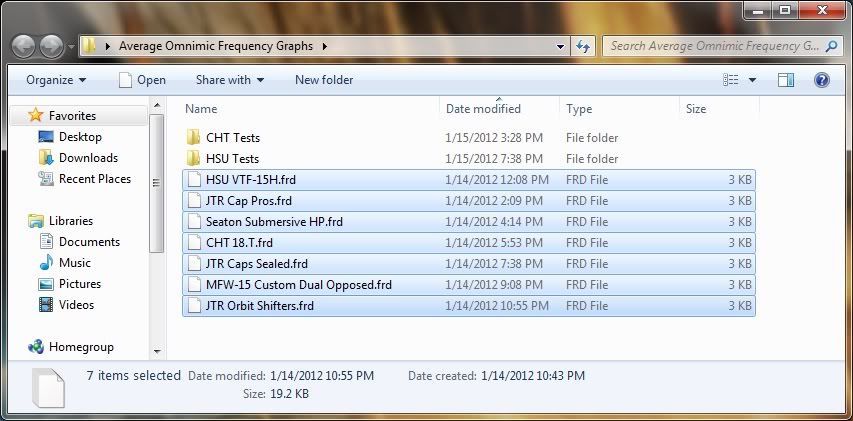

7)Save frequency response .FRD average with sub name.
8)Reset Omnimic SPL numbers to capture SPL peak on each audition.
Here are the timelines the omnimic graphs were taken, and the timeline of our day...Shortly after this reading was taken we invited everyone down and began the audition.
Again -- frequency responses were gathered as an average using all 12 audition seat positions in one average graph per sub pair. The average curve was saved and overlayed to show the following. [Updated teaser with full reveal] I will break them down individually below so you can see how Audyssey affected each sub.
Oh and in case you are wondering - the two subs with the highest peak SPL measurements were flat out middle of the pack in the frequency response graphs shown above (the JTR Cap Pro and the JTR Orbit Shifter) - so don't go thinking that the subs with the highest FR graph had the obvious advantage the whole time. Another of the subs mid pack spl frequency response with a phenominal flat (in fact best of the day) frequency response had the lowest peak SPL measurement (MFW-15 Dual Opposed). Highest SPL doesn't just automatically and blindly win the day. The Submersive HP and Cap Sealed measured exactly the same at 118.3dB and they were the declared winners by averaged vote for music and movies respectively. Remember we weren't a/bing these subs back to back, and there was about 45 minutes + of downtime between each audition and the loudest subs of the day were not immediately demoed next to the quietest on both sides. Thats a lot of time to pass and sort of respect expectations off a couple dB here or there. Also note that the peak SPL measurements captured below do not necessarily indicate the peak clean SPL measurements of every entry --- they soley relate to the peak SPL captured at the command table 17 foot away from the subs in the back of the room during each of our day's audition with the standardized volume levels we utilized for this meet. The Inuke DSP 3000 amp was used for both the Captivator Pro pair and the CHT 18.T subs. A DSP was engaged for both sub pairs to help level the playing field since these two sub entries were the only passive entires without any native EQ. I will post their exact Parametric EQ settings as saved and screenprinted in the omnimic software next to their frequency response graphs for reference so people can see what EQ was applied prior Audyssey on each of these entries.
Without further ado - Here are the frequency response graphs and peak SPL number captured for each audition. 1/6 smoothing applied (omnimic default)
HSU VTF-15H Pair - peak SPL recorded - 117.1dB
JTR Captivator Pro Pair - peak SPL recorded - 123.3dB
Seaton Submersive HP Pair - peak SPL recorded - 118.3dB
CHT 18.T - peak SPL recorded - 118.1dB
JTR Captivator Sealed Pair - peak SPL recorded - 118.3dB
MFW Dual Opposed DIY Pair - peak SPL recorded - 116.4dB
JTR Orbit Shifter Pair - peak SPL recorded - 122.0dB

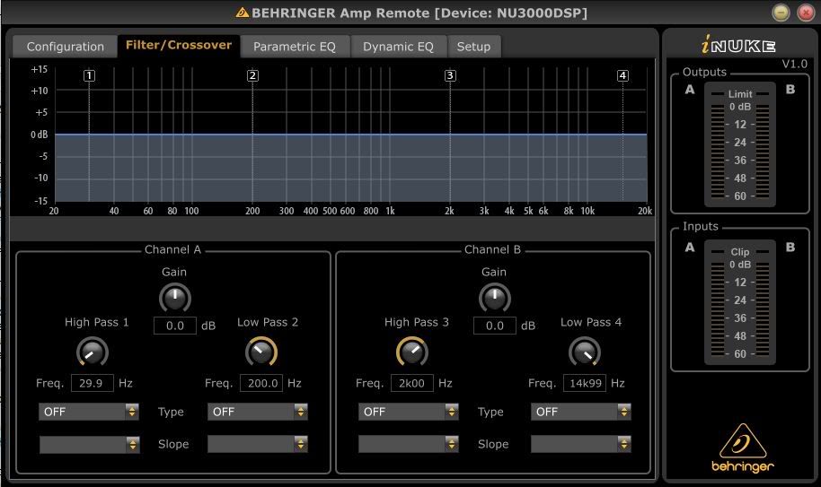

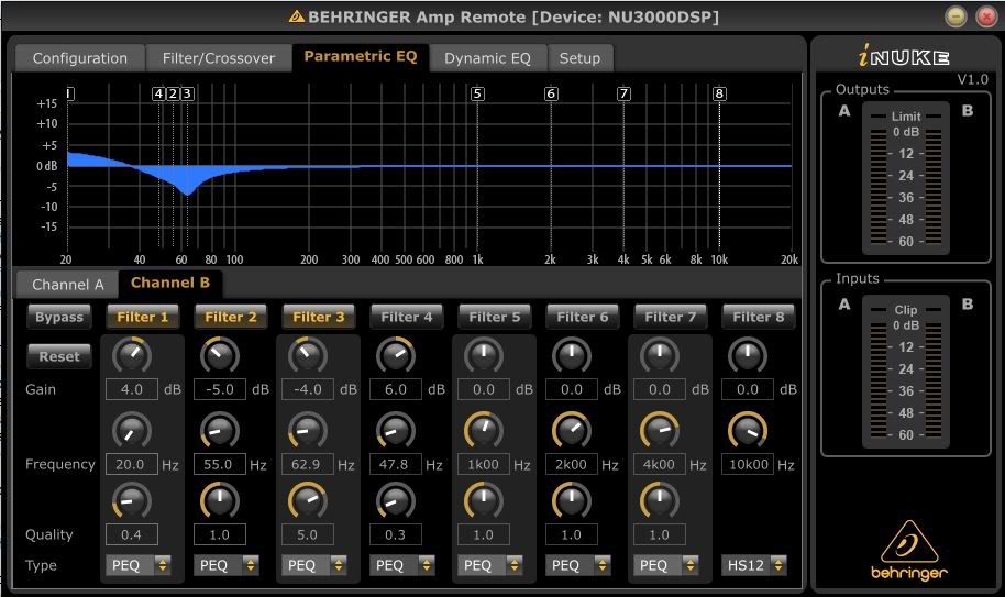

Some people have asked about the INuke DSP settings for Both the Cap Pros and CHT 18.T.
We only utilized the parametric EQ function and set both channels per each sub to try to help flatten the EQ - as these are passive subs and don't have mated amps with active EQ built into the plate amp (or in the case of the mfw-15 turbo project ---custom built into the outboard amp). We did not use the HPF or Dynamic EQ functions at all on the inuke amp for this meet, but I have screen shoted every config screen for transparancy.
INuke DSP 3000 DSP settings saved for both CHT and the Captivator Pros are noted here: These are unmodified and EXACTLY how used in the meet. I preformed my parametric EQ function for the Cap pros in the 15hz tune back in December of 2011. You can read about that here -
http://www.avsforum.com/avs-vb/showp...postcount=2901
I always wanted to flatten the line out a little more but got bored and never got back to it...

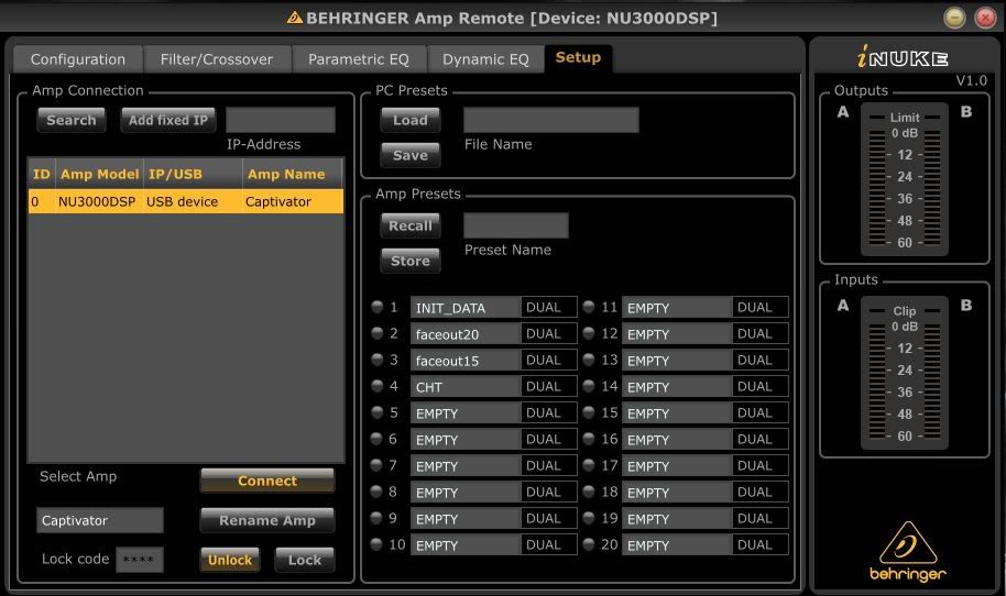

Here are the Inuke configs.

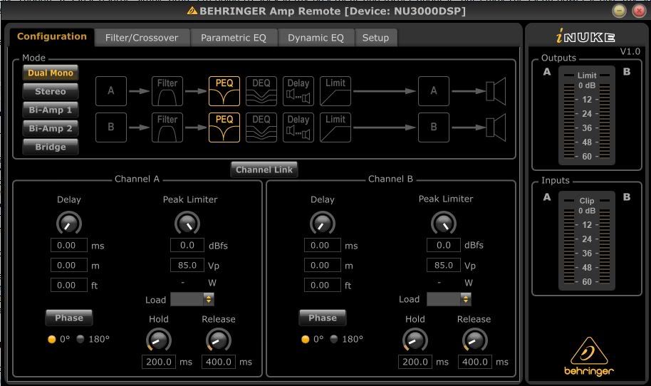

INuke DSP 3000 Config Screen where you can load which profile you want to use -
INuke DSP 3000 general config screen for JTR Cap Pros

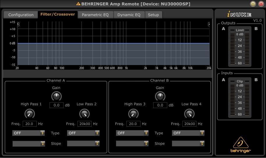

INuke DSP 3000 filter/crossover screen for JTR Cap Pros (not used - no HPF engaged)
Inuke DSP 3000 Parametric EQ screen for JTR Cap Pros - Channel A (in 15hz tune)
Inuke DSP 3000 Parametric EQ screen for JTR Cap Pros - Channel B (in 15hz tune)

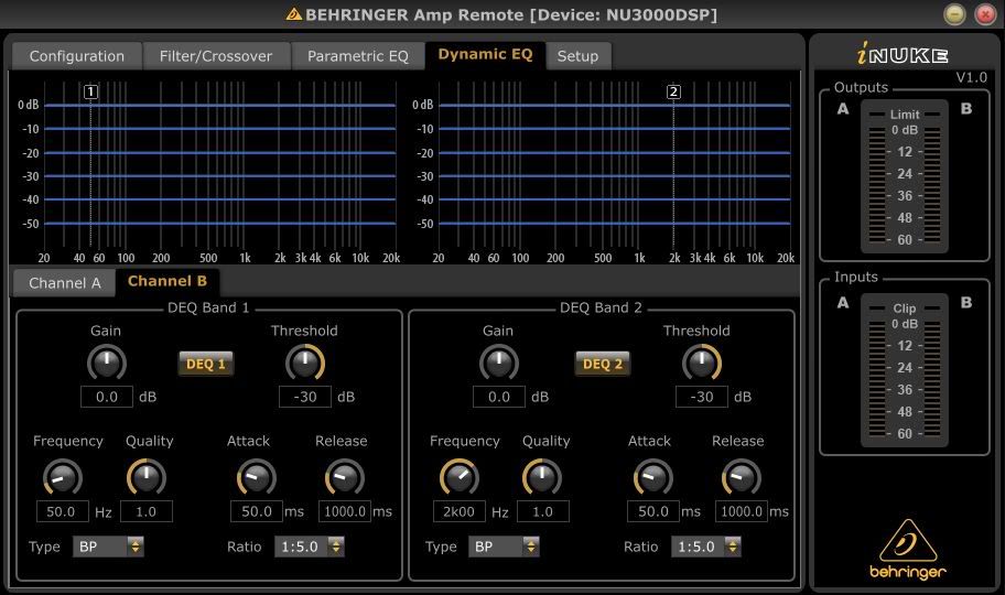

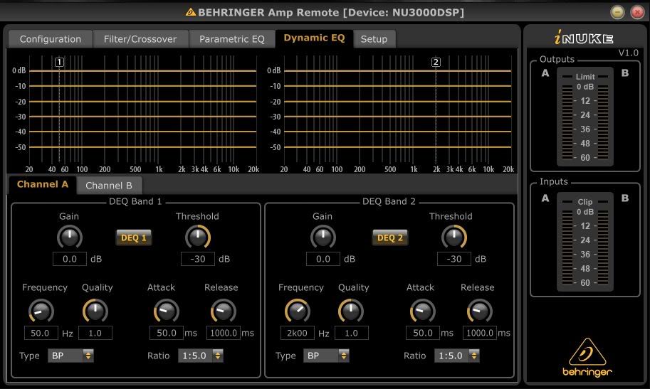

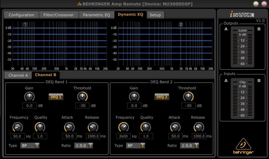

Inuke DSP 3000 Dynamic EQ screen for JTR Cap Pros - Channel A (not used)
Inuke DSP 3000 Dynamic EQ screen for JTR Cap Pros - Channel B (not used)

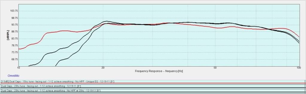

Here is the resulting frequency response graph captured in my room prior to the meet (December 2011) with the 15hz tune, no Audyssey, and no HPF. Obviously since I created these DSP settings and captured this frequency response information back in December - keep in mind this is from a single main listening position and not an average of the 12 seats used in the audition like you saw above in the meet graph posted for the JTR Cap pros It also doesn't not have Audyssey engaged in any fashion. The 15hz dsp profile setting was the profile I used at the meet with one port on each cap plugged. I'm sorry I didn't grab a new reading the night before without Audyssey like I have with the CHT subs, but I didn't think to do it and so you'll have to ignore the 20hz omnimic graph overlays - those settings were not used. You are looking at the red line in this picture to see about what My Cap pros were cabable of with only the Inuke's DSP applied and no Audyssey. 1/12 smoothing for this shots I believe.
Here are the Inuke DSP 3000 settings for the CHT 18.T subwoofer setup
Because I had a lot more time to play with my DSP settings and set what we used at the meet back in December 2011 for the Cap pros. You'll probably see I have more parametric EQ bands engaged for the Cap Pros, but from the post DSP graphs on Friday night, and the Sunday's retesting on the Inuke with the CHTs (which in the more "back to normal" room configuration with out all the subwoofer drivers and chairs and everything everywhere) --- we really had a pretty darn nice DSP setting engaged on the CHT subs as well even with only three bands per channel used for so short a session. Desertdome helped me set up the DSP settings for the CHT subs while Kwarny and Tesseract67 stood by and approved of these settings on Friday night.
INuke DSP 3000 general config screen for CHT 18.T
INuke DSP 3000 filter/crossover screen for CHT 18.T (not used - no HPF engaged)
Inuke DSP 3000 Parametric EQ screen for CHT 18.T - Channel A
Inuke DSP 3000 Parametric EQ screen for CHT 18.T - Channel B
Inuke DSP 3000 Dynamic EQ screen for CHT 18.T - Channel A (not used)
Inuke DSP 3000 Dynamic EQ screen for CHT 18.T - Channel B (not used)
Here is the resulting frequency response graph captured in my room post Inuke DSP application from a single main listening position (NOT averaged over 12 chairs - they weren't setup at this time) on Friday Night Jan 13. Unfortunately on Friday night I did not grab a screenprint of the initial non DSP frequency response. But this is prior to running Audyssey and all Audyssey EQ stuff off. We were only using the CHT 18.T woofers in my room with the Inuke DSP applied. We listened to through a couple clips and Tesseract67 (sub owner) made the decision to use this configuration over the other Dayton amp he had brought. (1/6 smoothing applied)
