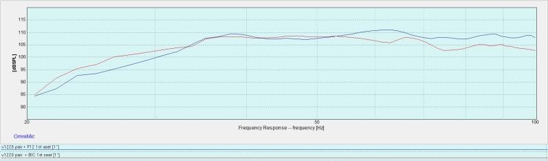

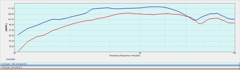

Archaea came over last night and got a few graphs for the v1220 pair in my room, I'll get measurements for my room soon, but my overall happiness with the pair is getting better. I watched pirates of the caribbean 3 last night at 0....pretty sure my neighbors house was shaking (luckily no one lives there atm). I could feel every explosion pretty well, I believe at one points while listening to some techno/trance music we hit 121 dB... Hopefully Archaea will post the graphs soon, I think his wife probably chastised him when he got home at 10:45.
As for the F12, I still think I like the sound of the F12 better, but the V1220 pair is obviously louder than the single F12...I'm going to continue playing around with the settings and will make a final decision soon on which I prefer.

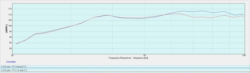

Archaea and I did some more playing with the omni mic and positioning. Here are the results. These graphs are all taken at the same volume with no smoothing and the sub placements are not ideal. The F12 is placed in front of the couch between seating positions 1 and 2. Position one is the center of the couch, position 2 is to the left of the couch and next to the wall, Position 3 is to the right side of the couch and away from the wall. As you can see in the graph, the blue lines are the V1220s and the F12 while the red is just the v1220s. We found what we thought to be the best placement for the v1220s and then I moved the F12 around to see if it would help, and as you see in the graphs, I think it did help a little in flattening out the line.
After listening to some movie clips and some music, it sounds drastically different. I'm hearing notes I didn't really hear before. There was a large lag at about 60 hz prior to moving stuff around and some songs sound a lot different with out that lull. Also, I am almost sure that I hear some sounds I didn't hear prior when watching the movie clips on the demo disc. I do believe I can specifically point out some sounds in the book of eli gun fight at the house. Also the THX clip sounds a lot smoother. So far I'm happy with the sound of this set up, but maybe not the positioning. I might play with re-arranging furniture, but I have a 3 piece sectional couch that is very very very large and if I turn it the other direction I'd only have about 6 inches between the wall and the couch thus making it difficult to get in to the area without climbing.

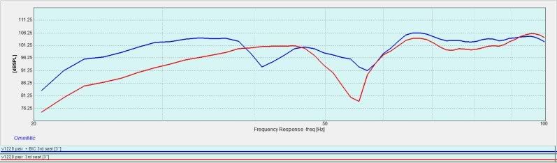

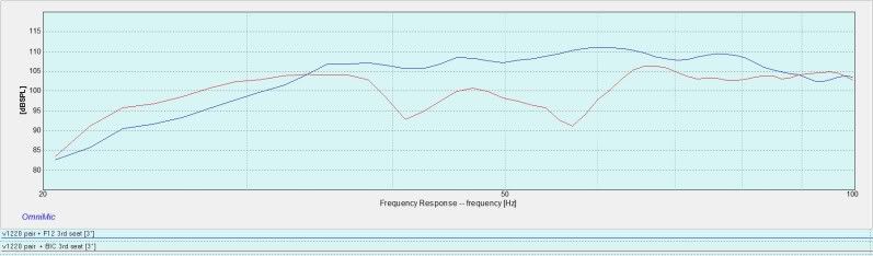

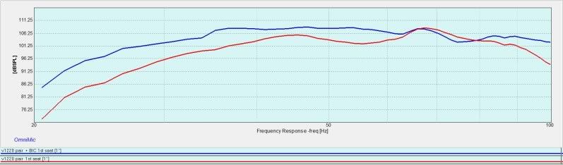

So, I rearranged my room, and that made it a LOT harder to place my subs to get a decently flat response, its pretty hideous actually. Here are the graphs as compared to the seating positions in my previous posts:
1st Seating position(Center of couch):
2nd seating position(Left side of couch):
3rd seating position(Right side of couch):
And for fun, a graph of where my head is when I lay down vs where it is in seating position 1:
Some how they seem pretty close across the seating positions oppose to the 3rd seat in the previous arrangement that had giant dips. Now if I could just afford something that was stead down to 5 hz eh?
