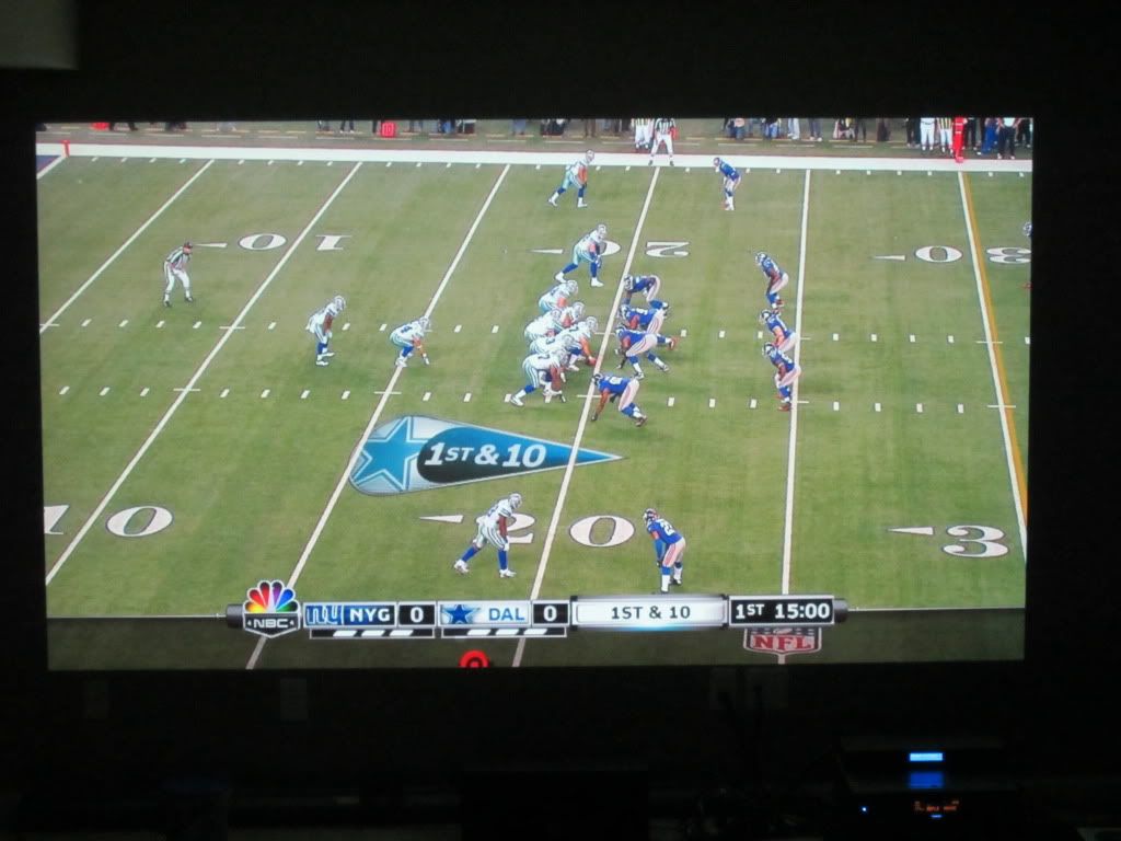

As you can tell I love mine. I have an Epson 8500Ub easily lighting up a 153" Seymour AV A/T screen and it looks great. As good as your $6000 plasma????? apples and oranges.........A 130+" screen is pretty impressive in a home, very close to a theater experience.
Have you seen any of the newer projectors? setup properly in a home, not a box store? If you haven't, they will surprise you I'm sure.
You could always keep your plasma down there and have a huge A/T retractable screen come down in front of it???
The JVC model line produces really great blacks I'm told. More expensive but I'm not sure if they are light canons like the Epson or Panasonic. The Epson's have great blacks for the price and have plenty of lumens to light a large screen.
Worth looking into IMHO.
Here's a screen shot from mine,
and for size comparison, I'm 6'4" and weigh 270lb
I could take a few more shots with a very dark scene so you can get a better idea if you like? but won't be able to that till tomorrow.
Let me know.

Crabalocker...... You also have a killer setup... The only thing for me the reflection off your wood floor would annoy me. Does that reflection bug you at all?
Thanks, I do love my projector.
I thought I would hate the reflection and that it would drive me bananas but to be honest, I don't really notice it while watching. The wife says we're not putting anything in front so I do not want to experiment with carpet or cloth to see the benefits of ridding the reflection because then I'm sure to notice it and would have to battle for a fix. My gut says the wife will give no quarter!
Yea I agree, Erin Burnett is hot.
Sorry for getting off topic from the OP but man that room is perfect for a projector, something like carp's setup would look awesome in his room.
