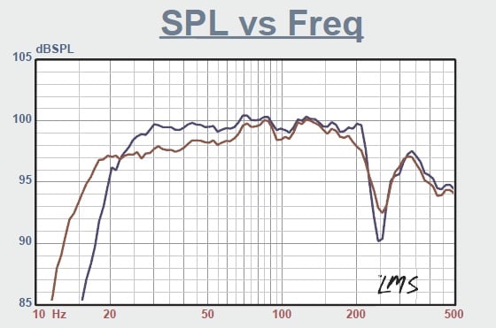

As the others have mentioned, the most significant contributor to "accuracy" is your frequency response curve which is the result of the subwoofer interaction of the room.
Below is a outdoor frequency response of the HSU VTF-15:
Here is the frequency response of the HSU VTF-15 in a room:
As you can see, the room affects a subwoofer's native frequency response.
I made the mistake of upgrading twice (to a JL Audio F113) before realizing that my perception of a one note subwoofer was not due to my subwoofer, but a null in my frequency response curve.
My suggestion would be to measure what your frequency response is. If it is relatively flat, then upgrading to a better subwoofer will likely be effective. If it's due to an even frequency response curve, I would see what happens after you fix it (i.e. EQ). Buying a bigger, better subwoofer in this case may not correct your issues, as it was in my case.
