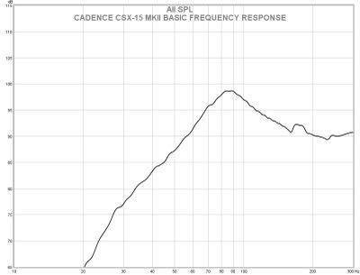

Now that Josh Ricci has tested the Cadence CSX 15 for Audioholics you might want to reconsider recommending it. Only 2.5 stars out of 5.
This is a mid-bass module. Even Josh mentions the CSX15 MKII as a mid-bass module...
