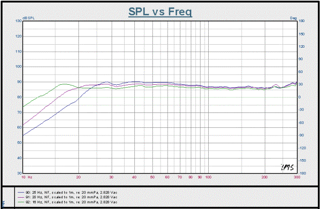

DSP on that XS15 isn't quite the same as these other options, so unless you're bringing your own with measurement gear the SubM and CapS will have much greater low end out of the box, no matter how many XS15's you throw into your setup. Even then, there's no telling what kind of filtering you can't defeat on the XS15 and EQing an already EQ'd sealed sub isn't exactly ideal. With these listed in specs, "Soft limiting protection & Frequency dependent compressors" you've already got things in place that you can't change.
-6dB point
SubM HP: 15Hz or 19Hz (selectable)
CapS: 15Hz
XS15: 26Hz
The CapS has over double the displacement of the SubM HP for a little more money. If bang/buck wins over aesthetics, it should be a no-brainer.

In this small of a space (16x12x8) there is assuredly going to be ample room gain(PVG) likely starting in the 30-35hz area. I would be very surprised if the XS15 wasn't relatively flat down to the 12-15hz range in this environment. The filtering in place on the Power X line is fairly minimalistic by industry standards. I agree though a single XS15 really isn't going to compete with those other options.

Thanks Tom. Sure enough, I must have missed the room dimensions. It certainly wouldn't hurt the OP to get a meter out and get some LP readings of his current sub vs a close mic just to give him a good idea of what he's working with.
I agree from the FR and sweeps shown the low end filtering seems to be minimal compared to most. For example, the obscene filtering of Epik's or eD's sealed subs.
Do you have plans for a sealed line targeted at the larger rooms like the other subs mentioned do?
Yeah, it is called buying more of them. How about a dual opposed version that can stack on one another, like Bosso's? I would really like the dual opposed in that old SVS cylinder and rather than ports on the top shrink the height and add another woofer with feet and then just add more if needed. The numbers show it to be down 3 dBs to the empire with dual 15's so a dual opposed version would be stronger than the empire but leave the natural sealed rolloff. Bosso makes this sub already but with awesome looks, lots of power, and a frequency response shaper.

Buying more of them won't get you the 15Hz -6B point like the DSP setting on the SubM HP and CapS. You could have 50 of them and it won't change that fact. Signal shaping is very important to the low end. It's not like you have a passive sub and untouched signal you can do your own thing with, that would be ideal and then you could do what you want.
But for the guys that need extension down to the teens where their room gain kicks in Seaton and JTR's subs are doing that out of the box.
The Empire has crap for output under 20Hz though since it's filtered, whereas Tom's sealed 15 seems to have a shallower roll-off that would give you something decent in a room like the OPs.
I agree- I suggested in the PSA thread that dual 15's sealed with more power (and extended DSP) around that $1200 price point the vented unit is at would be a real killer product.

Here is the sub measurement done with AS-EQ1. AS EQ-1 Sub Mesurement 116k .pdf file
Here are REW measurements that i took a while ago. It was taken with a professionally calibrated ECM8000 mic.
