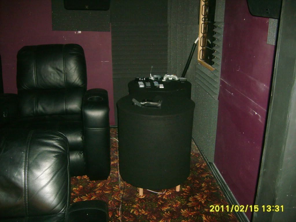

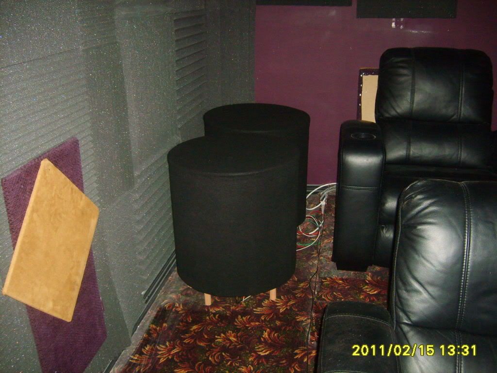

These
This whole system cost me $1500 for the 4. Two Cinema F-20's would cost $800-900 but only goes to 20hz.

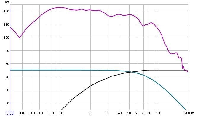

You can do it easily with DIY, and to 13 hz if you wish! The problem is they will be very big and ugly. 2 eD 190v2's, one behringer ep-4000, and one sonotube cut into 2 pieces and one sheet of MDF for endcaps. This comes in at $925 and in my room produced 120 dBs at the LP. Mine were tuned to 13.4 hz.
produced 120dB at what frequency? fairly flat across the spectrum? Did you happen to capture a FR graph at that time. For the price that seems pretty phenomenal, and I know you like your ED subs now -- sounds like a reasonable idea for someone who doesn't mind the looks. They are currently $150 a driver at ED in a sale right --- assuming ED is still legitimately selling things?

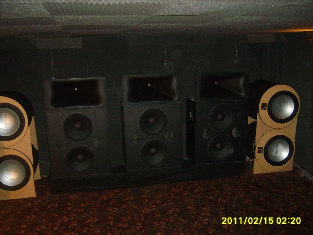

The first is all four corners
The response
Then I placed them all up front like this
The response with subs only and 80hz crossover
When I say reference I set everything to 75 dBs, subs 10 dBs hot, both vented and sealed, and watched WOTW famous scenes at reference and hit the meter at 126 dBs plus. My meter just maxed out at my LP which is 13-14 feet away.

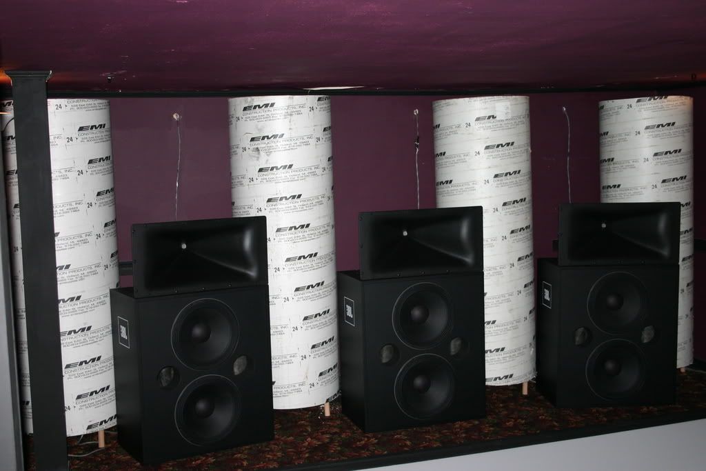

If I take away 2 subs(vented) it would hit 120 dBs in room at LP which is over reference.

I lose 12 dBs from the speakers to the seats! These two subs would play roughly 112 dBs at 20hz outside at 2 meters. Depending on placement one can get up to 12 dBs of boundary gain and maybe lose 3-12 dBs from distance. Dual ported 18's with 600 watts will get you there! My room is on concrete, so spl's are hard but pressure is easy. I can open my doors(7x6 area) and I lose nothing, that opens to another 2100 cubic feet.
