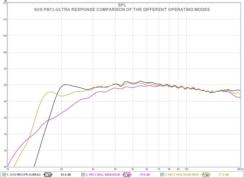

Well a bass reflex design is going to be more sensitive at tuning as can be seen on the pb13 u.
In a sealed system low end sensitivity will decrease the smaller the enclosure size. I don't have win isd on my desktop and don't have the laptop handy just throwing it out there for discussion.
I wasn't discussing in room measurements, boundary gain, pressure vessel gain, and eq can bring the low end up significantly.
Like I said the measurements on the VS are good and it looks to be a fine implementation of the driver.smile.gif
Plugging the port on what is an enclosure primarily tuned for bass reflex won't yield the same results as a sealed box purpose built for the same driver. Most likely, the sealed box would be smaller, basically enabling heavier EQ while making the design amp limited, as a good sealed subwoofer should be. But I do get what you are saying, bass reflex is more sensitive around tune.
