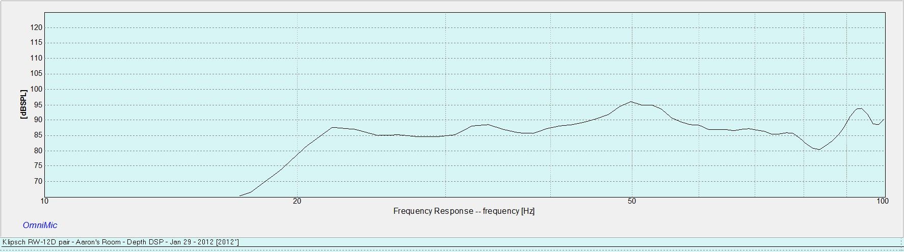

Klipsch RW-12D
Max SPL Frequency Response Limitation: Compression. The 20hz end of the FR spectrum stopped increasing at the point captured. I did not hear port noise at this point while capturing the frequency response, and at no time did I hear mechanical noise on the driver during the duration of the demo session
KlipschRW-12Dpair-NoEQnomainsmaxSPLbeforecompressionon20hzend-noportnoiseoriginalplacementfacingforward-depthmode-OneTwelthsmoothing.jpg
the Klipsch RW-12D has a built in DSP. Here are the results of the max audibly clean SPL before compression on both punch dsp vs depth dsp mode.
KlipschRW-12D-NoEQnomainsmaxSPLbeforecompressionon20hzend-noportnoiseDepthEQvsPunchEQ.jpg
Positive:
I never heard port chuffing at the standardized volume chosen except for on two occassions - Bass I love you which has 7hz and 15hz notes, and the 100hz to 20hz sine wave which extending to 20hz --- extends below the Klipsch's port tuning.
I did not hear mechanical limits of driver
Seeming possesing the most headroom (or the strongest protective DSP scheme) since we never heard the mechanical limits of the drivers.
LCD DSP, Volume Control, 3 DSP settings (flat, movies, punch) very nice.
Overall very impressive for the $300 sale price. Great budget package overall and regularly available on and off at $300 sale price!
Negatives:
Port chuffing on the two songs
I could tell (or though I could) that these subs seemed to be missing the lows a bit. Pomp and Pipes Organ - nothing. Bass I love you low notes - nothing but air movement/port chuffing.

I'm no expert at all, but after looking at the graph (shows both Depth and Punch), does it seem that "Punch" mode gives better output at all FR points? I've been running mine in "Depth" mode for movie viewing, but if "Punch" will give more FR (even at the lower end), I will change them over. I guess it can't hurt to just switch between both of them for a couple of days to see how it sounds in my room.

Punch does seem to give more output at max spl before compression kicks in. (Better? depends on your definition. Flatter FR is depth mode, but when the SPL limits are pressed it appears depth starts looking more like punch anyway --- with apparently about 2dB less max SPL before compression kicks in on the low end of the signal)
Yeah I don't know exactly what to make of that, but it is what we measured so I have no reason to try to hide it. the Klipsch has those custom DSP settings -- perhaps Klipsch has programed some slightly different limiters in on depth vs. flat or natural dsp modes. By comparison you'll notice the Jamo's max spl at 20hz stayed almost exqactly the same before compression and driver noise with or without boundary gain. That's more what I would have expected.

After hearing the Jamo/Klipsch side by side, I contend that the Klipsch is better sounding on most of the songs we listened to. The Jamos sounded weak, though we ran them at the same levels. I heard things I don't know how to describe that I didn't like coming from the Jamos. I wouldn't say the Klipsch won by a landslide, but between the two, I'd go with the Klipsch. I also like the look of the Klipsch better than the Jamo.
One thing I have to point out is that while Aaron, Tatertot and I were sitting against the wall in the main listening positions, Archaea was sitting in a chair more towards the center of the room, exactly where you'd expect a null to be. During the organ part of that song that has the organ in it, Archaea kept trying to find where it is in the song because he wasn't hearing anything, but I heard it from my seating position, albeit faintly. I do believe I had the best seating position as my head was next to the mic used for measuring.
I would agree with Archaea, that both of the subs are good contenders for budget subs. They are nearly interchangable for movies, though the Jamos are flatter as the graph shows, you lose some volume in the higher frequencies. I apologize that my review is very elementary, I don't have the experience and know the lingo like Archaea, I just know at the end of the day I liked the Klipsch better.
That being said, back to re-EQing my Daytons, can't wait to get my basement finished so I can have a room thats not open to the rest of the house.

Originally Posted by kcnitro07 View Post
One thing I have to point out is that while Aaron, Tatersly and I were sitting against the wall in the main listening positions, Archaea was sitting in a chair more towards the center of the room, exactly where you'd expect a null to be. During the organ part of that song that has the organ in it, Archaea kept trying to find where it is in the song because he wasn't hearing anything, but I heard it from my seating position, albeit faintly. I do believe I had the best seating position as my head was next to the mic used for measuring.
Tatersly, Aaron, and KCNItro07 all sat in the normal couch and recliner seating positions, I pulled up a wooden kitchen chair and placed it in front of the couch and recliner arms. There was definately less bass in tmy seating position then what the guys were hearing in the seats with their heads up against the back wall getting extra bass re-inforcement. That said the Jamo reproduced the 16hz organ notes the best from my particular seat I thought. I was trying to hear something on the Klipsch and asked to play the clip a couple times cause I couldn't hear anything. The Jamo's played the note, and the Dayton's made clicking sounds IIRC. The Jamos were pushed beyond their comfort level on some of the lowest material, but except for a few songs I personally liked their sound better for music. That's why all this stuff is subjective with these two subs being in the same class.. There wasn't a blowout winner here.
Originally Posted by joehonest View Post
Archaea, You made it very clear you ran the tests in PAIRS, but for those of us who plan only to use ONE sub. How should we interpret your findings? Is it just less max SLP levels ?
Originally Posted by colohtpc View Post
Great test, great write up. Thanks! I also am limited to single sub at this price range so same question about how this all relates to one only.
Two subs typically allows for smoother, more true to the sub's capability frequency response. 1 sub would have been 3-6dB less SPL at max in aaron's room and potentially a bit rougher frequency response because the room's nuances would be harder to overcome with a single sub.
The other thing to clearly note is that these max SPLs and frequency response graphs are specific to Aaron's room. Don't expect that your frequency response and max clean SPL will be identical unless you have an identical room. tongue.gif Well since we know you don't have that - then just consider these frequency response captures as a piece of data which primarily shows its relevance in relation to each other. IE - the Klipsch, Jamo, and Dayton subs in a room --- each less than 1 dB away from the beginning of low frequency compression or audible mechanical limits.
In the chart that the Jamo and Klipsch are being compared directly @ 20hz they are both the same, the Jamo stays flat and the klipsch is rising to +6db @ 50hz.. Would Audyssey XT flatten the Klipsch ?
Yes Audyssey may attempt to flatten the response on the Klipsch. One thing to keep in mind is that Aaron's current entertainment room had a lot of room gain. (a good thing) When you take away some of that room gain the Jamo extends to 20hz, while the Klipsch will begin to fall off at 23hz. This is evidenced by a graph I took of the Klipch RW-12D pair at Aaron's house in his other living room in January of this year. That first room offered less room gain and shows the more natural port tune of the Klipsch with more clarity. (this older graph isn't using smoothing IIRC). Note this measurement is of the same two RW-12D subs in just a different room of Aaron's house. It wasn't captured at any kind of a max spl, but rather just a FR capture.

Heres some crazy ideas... Can the Klipsch be sealed, then it should be perfect., would sealing the port lower the deep end?? The jamo 12" driver is the weak link, but you could easly buy a better replacement driver, that would fix the jamo.. Sealing the Klipsch would be the most cost affective, as a new driver for the jamo would be a hundred plus bucks for something good..
joehonest is offline
post #21 of 43 Old 08-27-2012, 02:22 PM
alphaiii's Avatar
Posts: 2,159
Quoted: 44 Post(s)
Liked: 58
Heres some crazy ideas... Can the Klipsch be sealed, then it should be perfect., would sealing the port lower the deep end?? The jamo 12" driver is the leak link, but you could easly buy a better replacement driver, that would fix the jamo..
It's not as simple as that...
Sealing the Klipsch will likely kill low end extension because it will roll off higher in frequency... IF (and it's a big if, but some drivers do well in both sealed and ported boxes) the driver would work well in a sealed box, the volume of the box would be larger than it should be if it were sealed, so the driver will be overdamped which could cause cone excursion issues. You could add wood blocks/bracing inside the enclosure to reduce the internal volume, but without measuring the T/S parameters of the driver you won't know 1) if the driver will even work well in a sealed box and 2) what target volume to shoot for.
With the Jamo... Buying a better driver, assuming you find another that works optimally with the given enclosure volume and amplifier (which has unknown boost/filter circuits), kind of kills the whole "good deal" part of it.
In that case, just buy a better sub...

The Klipsch is a BIG box, sealing the port would do more harm than good ??
I would think someone would of tried it by now..
post #26 of 43 Old 08-27-2012, 04:29 PM - Thread Starter
Archaea's Avatar
Join Date: Apr 2004
Location: Kansas City, MO
Posts: 10,145
Mentioned: 484 Post(s)
Tagged: 2 Thread(s)
Quoted: 3086 Post(s)
Liked: 2714
no typically you want smaller boxes for sealed. The klipsch box should be smaller if sealed (less airspace) to help prevent overexcursion on the low frequencies.
A driver at port tune moves very minimally. The box tune itself aids the driver in creating most of the sound at that tune. This fact that 1) the Klipsch driver will move minimally at lower frequencies, coupled with the fact that 2) the built in Klipsch sub DSP generated high pass filter effectively prohibits lower frequencies than the Klipsch's port tune making it through are the two likely reasons why the Klipsch driver never exhibited mechanical noise limits while the Jamo and DIY drivers did.
A driver at port tune moves very minimally. The box tune itself aids the driver in creating most of the sound at that tune. This fact that the Klipsch driver will move minimally at lower frequencies, coupled with the built in Klipsch sub DSP which effectively prohibits lower frequencies from port tune making it through is why the Klipsch driver never exhibited mechanical noise.
