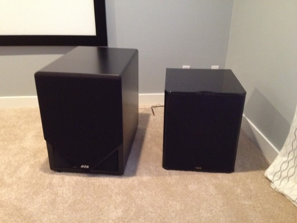

I will say the PA-150 has a nice piano gloss finish. I had an ugly bedliner finish eD A2-300, so just about anything was going to be pleasing to my wife smile.gif
The PA-150 is not overly large either IMHO. This is the PA-150 stacked next to an Hsu VTF-15H:

At any rate, the VTF-15H looks like a monster truck next to the PA-150 which looks like a Ford-150 smile.gif
