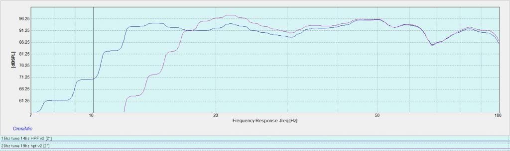

So I got a PM from Jeff wondering what was going on with the Caps FR / Omnimic curve. I honestly didn't even notice it until he pointed it out. We both agreed such an early rolloff was NOT characteristic of their normal performance. I did some sweeps tonight right around the same level. I'll be damned with the curves looked a LOT better, and what I was used to seeing. I did some experimenting and by accident I was able to replicate a similar type curve by applying a HPF only to one channel, causing a phase issue and a rolloff starting around 25hz. frown.gif Probably my bad, ugh. frown.gif This is just an assumption but as you can see something was definitely going on. BTW the mic and subwoofers were in the EXACT same position as during the GTG.
Here were my findings, 1/24 smoothing applied:
15hz tune vs. 20hz tune NO HPF
15hz tune with 14hz HPF vs. 20hz tune 19hz HPF

I was engaged in the pm exchange too and until you found this in retesting I couldn't understand how we could have possibly messed that up. Now it makes sense. An hpf on one channel but not the other effectively reverses phase and makes the two subwoofers fight near the hpf....halving the output of a single subwoofer. Its like opposing polarity (swapping positive and negative terminals on one sub but not the other) as the hpf frequency point is neared...
darn....
ouch to the guys who looked at the frequency response and thumbed their noses. eek.gifcool.gif
out of curiosity Andrew would you take one more graph using 15hz port tune and 17hz hpf using 1/12 smoothing and matching 50 hz to 90dB when you have the chance.... crossover set identically to meet day (80 hz right?)and mains unplugged when you capture. no rush on the request, but it'd be fun to post an apples to apples comparison of what should have been the cap pairs frequency response that day.
BTW how can we tell if this happened on the LMS-5400 with the 10hz hpf applied of if it happened on the dual dayton DIY subs that started with a 14hz hpf, but moved to 10hz hpf during the 5hz to 100hz sine wave clip.

I hope I didn't come across that way. I have NO DOUBT the Cap is a great sub. I just noticed that the measurement didn't seem to match the listening impressions and asked if they sounded different.

The Caps on the market today do not have a tune option, correct? Isn't it just a 17.5hz tune, or is a plug an option to tune it lower?
Archaea, do your caps have a 20hz tune? Just trying to get the tuning difference straight between different production models...

I have the 2011 model which is a native 20hz tune with a 15hz tune option using one port plug.
same as gorilla83...
the new caps use 50% longer ports and have a 17.5hz tune. they have no official alternate tune.
The 2012 design should be more advantageous for home theater use. one port plugged on the 2011 models can introduce port noise at absurd volumes.

Well if it truly was a hpf on one channel and not the other, guess that was a blunder on my part. I apologize.

Two things that surprise me.. they still sounded great and the one without the HPF lived through the torture.

So are we saying that because of this over site, the caps were a bit hamstrung and might have even done better (i.e played lower and louder?). If so, that would be impressive considering the numbers that were achieved from them during the tests

Honestly I can't say for sure what the issue was, so we'll leave it at that. Definitely not your fault, if anything I should be looking over my own setup!
One thing I can say for sure is that these subs are RUGGED. They've been tortured over the last year with 2500ish watts going into each of them during various demos and they keep coming back for more. With less power like an EP4000 you really don't even need the HPF.
I don't know if they would have played any louder, but it's likely they would have sounded much better to our ears during the standardized volume section. Completely my fault but I'm sure they will get their chance to shine at the next event.

If you figure simple distance would require 12-14dB more than 1m, and we played back well over reference, I'm not surprised at all that we hit a few limits at these arguably painful levels, at least in the fairly reflective room we were listening in. The mid and/or tweeter amps were also likely pushing their limits clipping at that point. The wider baffle and greater power of the 12C is for those who need that sort of playback level. Of course I've also heard the '8C's play subjectively louder in larger rooms, and remember we had TONS of subwoofer capability. Most could never touch those sorts of playback levels without the subwoofers crying mercy well before.
When I was at the volume control with the SubMersive HP trio, the 8C's were working hard, but stayed well behaved at some eye-popping levels, all near or above reference level. Remember that with ANY speaker, if you keep bumping another 3-6dB, any speaker/subwoofer will be over driven.

Originally Posted by Mark Seaton View Post
Even with the 80Hz crossover, the mic was maybe 16' back in the room which was fairly narrow and had minimal treatment.
Thanks for the reply Mark. I didn't realize the main seating position was so far from the speakers.

Originally Posted by Stereodude View Post
How far back from the Cat 8's was the mic during calibration (ie: seating distance from them), and what crossover frequency was used with them. I'm a little surprised to hear (no pun intended) that they were clipping at 8dB over reference.
Not sure if this was stated earlier but...
-8 or -10 on the dial was reference, so +8 on the dial was 16-18dbs over reference. The 8c's performed very very well.
dstew100 is offline
post #115 of 234 Old 10-26-2012, 07:01 AM

+ 18 over REF??? confused.gif This would be peaks from the mains of about 120dB at the seats from the individual speakers. That type of real level in the midrange -lower treble is BRUTAL on the ears. Subs you'd be talking about 130-135dB peaks with them run flat. Weren't they set really hot as well?
How in the world could either the subs or the speakers be not completely over driven at the listening levels claimed? I just don't see it being possible. What was this an SPL competition?

I'm not sure where that number came from. As close as any un-EQ'd setting really is just placed in a room, the speakers ended up 3dB low, and the subs were 8dB hotter than the speakers per internal test signal. This means at +3dB the speakers were at reference, and the subs would be +8dB.
We first started with the main speakers 2dB lower, but I raised them as IMO it was too bass heavy to provide much detail with the -15dB music listening level for the first pass.
