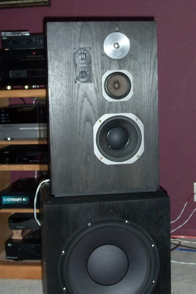

You can also stack the two subs, this will give a 6db gain. In fact I currently have my two subs stacked up front, with the top one rotated 90* from the bottom. That will save you on running a long line to the back.
In the HT I had from '97~'09, I tried many different sub locations, and I did not really like having a sub in back...but you can certainly try it.

4DHD did you say you mounted your normal speakers on top of your subs? i thought that is a bad idea. I could do that to get subs on different sides if it doesn't cause other issues.
n00b2 is offline
post #23 of 28 Old 11-25-2012, 07:39 PM
Bill Fitzmaurice's Avatar
Location: New Hampshire
Posts: 13,274
Liked: 3603
Usually it is. Where subs sound best and mains sound best seldom coincide.
Bill Fitzmaurice is offline
post #24 of 28 Old 11-26-2012, 04:15 AM
4DHD's Avatar
Join Date: Aug 2004
Location: sierra ecuadoriana
Posts: 6,191
Quoted: 205 Post(s)
Liked: 112
That can be true. But I present to you the JBL Performance Series PT800/PS1400 stacks. You would have to spend much more to get better. In the case of my last house, in which I designed/built a new room, with audio the main point of design, I stacked my custom L212 to my custom subs. I had tried subs in different locations, only to go back to the mains location.
Of coarse, using a PS stack does not mean one then can not add other subs, if needed or desired.
Here is a pic of the PS stack.
L212/SUB1500
PT800/SUB1500
Custom, one of a kind pair, MJC212 mains, mod PT800 center, PT800 surrounds, SUB1500s. Parasound P7, Citation 19, Parasound HCA2205A, HK AVR3600, Marantz TT, Samsung BD player, Denon DVD-A player, MacBook Pro w/ Dirac Stereo Suite.
4DHD is offline
That looks like a nice setup!. I'll try it out this way and see how it goes. Cheers.
Thanks, it was for 12 years, until I moved to Ecuador.
Notice all the space between the mains and the side walls, about 5 ft. Makes for a very wide soundstage. And being the mains were out from the back wall about 4.5 ft, quite deep as well. That room also had a vaulted ceiling to 10 ft, adding to the room's volume.
Where I am now, I've put the mains back on their 13" tall bases, which drops the mains about 9". And it works better for the soundstage, most likely cos of a lower ceiling. But there would be other reasons for that, like all concrete construction!
Although I have even more space to each side, about 9 ft, and a minimum of 5 ft to the back walls.
