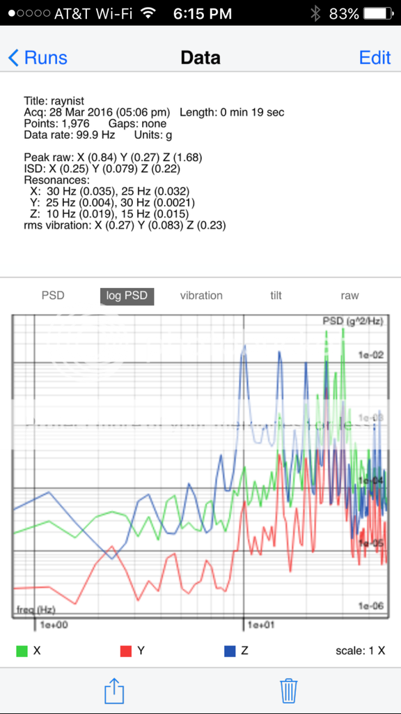

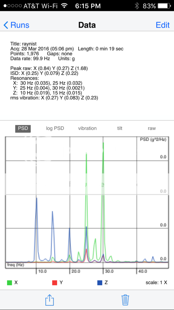

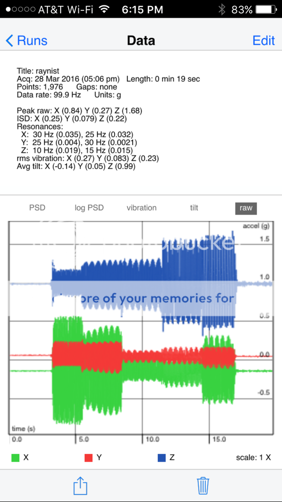

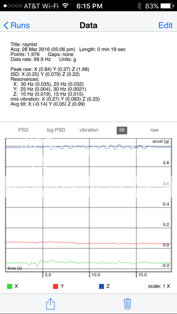

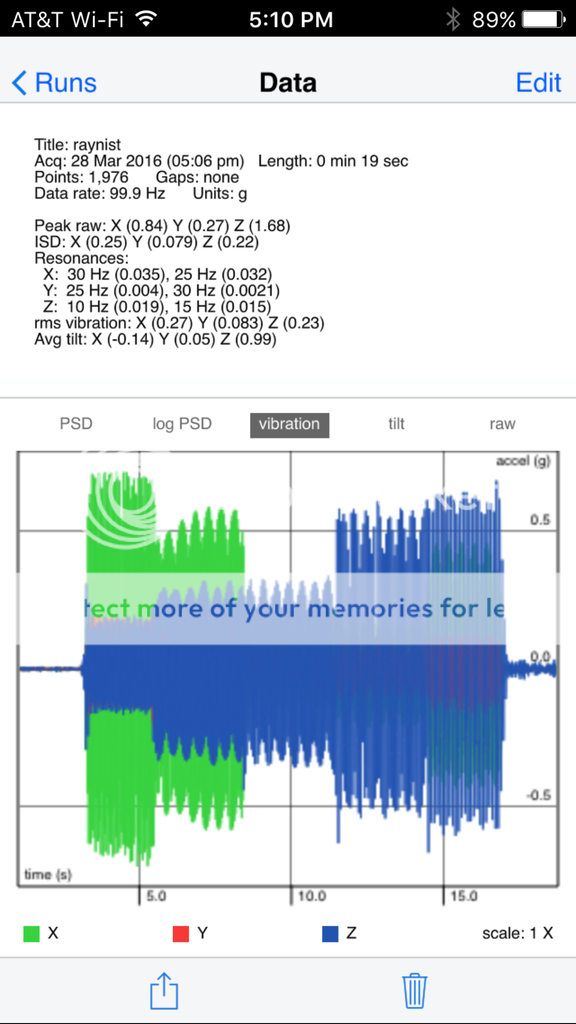

Here is EOT at reference.
Did I do this correctly? How do I read the graph?
raynist is online now

raynist, take snap shots of the other graphs. When you view data, there should be 5 graphs. It looks like you have strong 10 Hz output. The subs are nearfield and are the seats on a riser? Coolrda will look over the graphs and give you some more feedback. It's nice getting some more Vibsensor data!
derrickdj1 is offline

Ok - I will post them here. 2 S2's are behind the couch. Couch and subs are on a cement slab in the basement.
I also have another system with 4 Powersound Audio Triax's on a suspended floor - 2 nearfield. I will try that on later this week.

I am also on concrete in the basement without a riser. It's nice to see other TR's graphs with a similar setup. You also dealing with a fairly large space. I am around 4300 cu ft. I have a feeling if that system was upstairs, you would tear the house down, lol.

Nice job @raynist . You nailed it. I liked that your ULF card was right above the five VS graphs and we should all incorporate that when posting VS results. What is remarkable is your logPSD response @10hz. Its equal or above with corresponding frequencies in amplitude and where it should be according the the vibration graph(I'll comment on this later). Could be room size, placement in the room, concrete floor, etc. It would be good to get a top down sketch/layout of your room, no hurry though. This is something for all that has posted here should do at some point. Anyway, good job man. I'll get your data posted on the VS thread soon.
coolrda is online now
