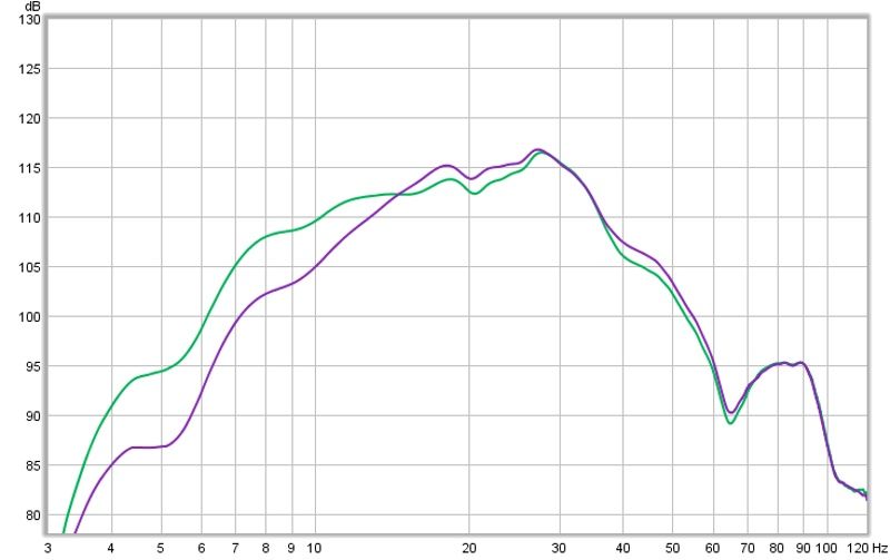

Back to the drawing board!
Here are both the raw sweeps of sealed vs ported(holes in wall)
Seeing this I am going to seal the wall and around my speakers better to see if I can bring up the low end even more. I am thinking of adding 4 drivers to the wall sealed and the 4 drivers in the back sealed as well. I will measure first to make sure.

What color is ported and sealed?
dominguez1 is offline
post #2216 of 5011 Old 08-21-2014, 11:53 AM
MKtheater's Avatar
Location: New Hartford, NY
Posts: 17,120
Mentioned: 100 Post(s)
Quoted: 1706 Post(s)
Liked: 1238
Green is sealed.

That's with mic+SC corrections applied?
You have no output above 30hz, what's up with that?
