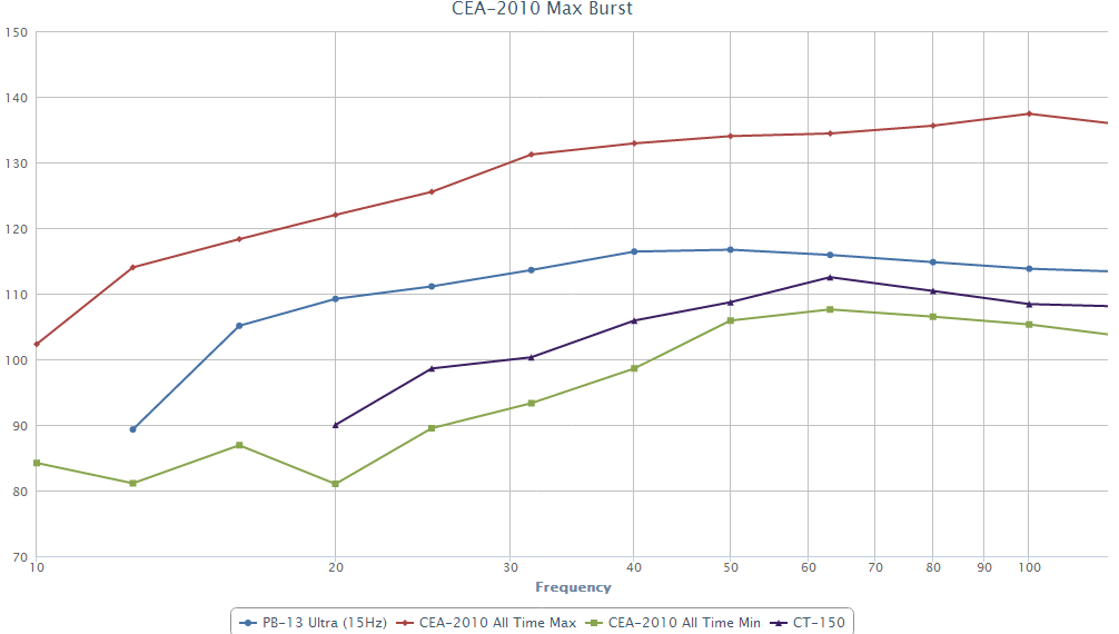

The PLUS takes out the XV15 quite handedly and the ULTRA even more. They both are much more superior subs taking the power plant into consideration also. This in no way is a slam towards the XV15 though. It’s just the way the cookie crumbles is all. Congrats on your new ULTRA though.
Back in the day I used to have a couple of CHT15"s. They are nothing like what you have on the way though. Compare them over at Data. My first SVS was a CS+ and it totally wowed me with the extension spl capability over the CHT’s.
EDIT> The CHT is the same as the ct over at Data. Anyway at 20hz it would take more than 5 ct/CHT’s to equal the ULTRA in some form or fashion.

That was max output I posted. If you went with 5 CT’s the line would still have that disparity after you dialed them back to calibration. Your bottom line is you will notice a huge difference in the material that you listen to. You’ll most likely say to yourself.. wohhh!!! I had no idea that was there.
