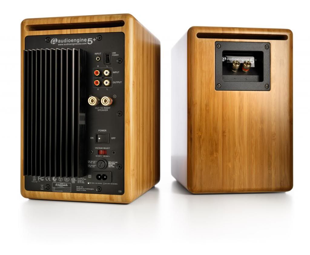

The A5's have RCA outputs. That means you CAN use subwoofers with RCA input. In fact with your setup using speaker wire is very less than ideal.
With that said for $500 max look at reaction audio bps-212, if you can spend over $500 rythmik isnt a bad choice

He is referring to L + R Line Inputs (RCA) not Speaker Level Inputs. The Audio Engine A5+ speaker combo is active, so no speaker level inputs over here. The A5+ has variable RCA (L+R) output so you can connect a subwoofer.

Then the OP has a lot more options. I've never heard of that system so I just assumed they were like any other speaker. Nice to learn something new.
In that case the Reaction is a great value.
