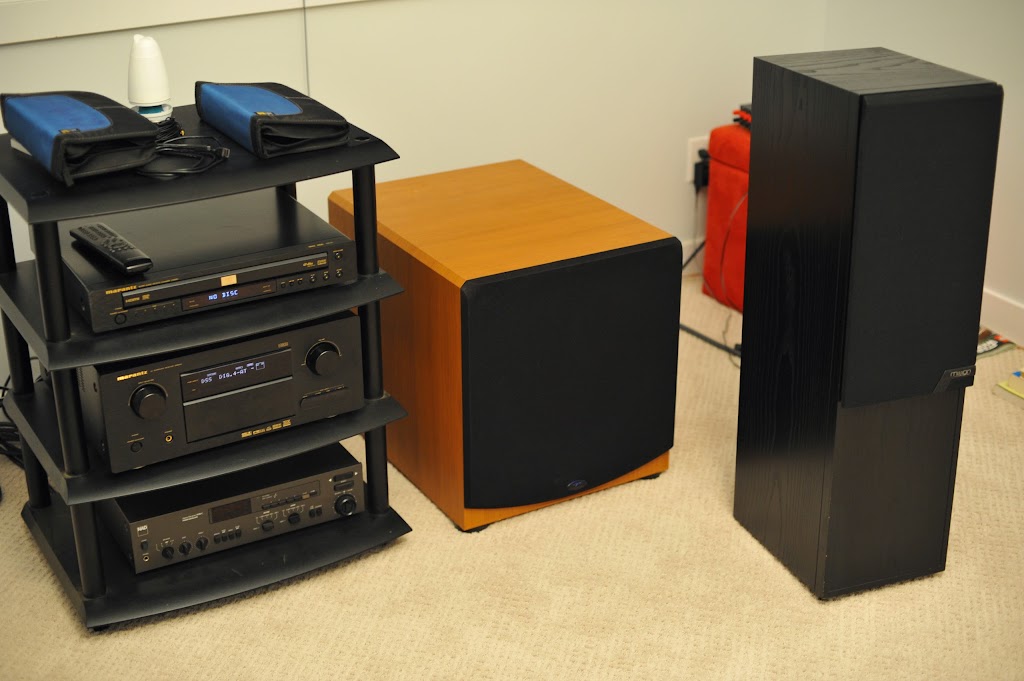

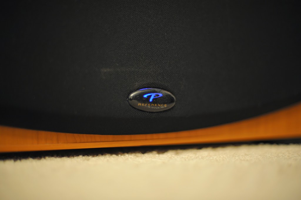

Well, I have an update on the classical Sub front. The sub Iwas after ended up selling a few days before the guy was going to deliver it tome. After that the company that I work for when Bankrupt and I ended upspending some of my Sub money on a pair of Beyerdynamic DT800 600ohmheadphones. Long story short, after I got a new job I came across an ad for aParadigm Servo 15 Version 1 Sub within my new budget so I ended up gettingthat.
I’m still slowly getting it setup as my room is hard to workwill with bare walls. I’m running into phase problems and bass jumping aroundthe room and in and out of my head.
Also does anyone know What type of glue I should use to reglue part of a dust cap back on?
