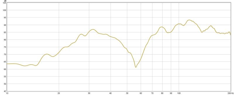

I have 4 PSA XS15s in my ~5000 cubic foot living room. After many months of pushing subs around my room and measuring with REW I've finally got them setup to where I'm getting the output I needed (craved) but I've got a ~10db null at 60hz at the MLP, and my other two listening positions are kinda outa whack.
I've considered getting 1 or 2 more XS15s but that just ain't in the budget right now. I'm considering buying a pair of "lesser" subs and running them in the back of the room in hopes of smoothing my response and leveling out the seat-to-seat variance.
I have a MiniDSP that I could use to delay the rear subs and employ a HPF to keep the really low stuff out of them.
The subs I'm considering are the Dayton SUB-1200. If you see this post, they sure have a respectable FR (at least in that room).
Is this just crazy or do you think it would be worth a try? Looks like Parts Express would take them back without any issues, but I would have to pay return shipping (which could be pretty hefty, the subs are 45lbs. each).

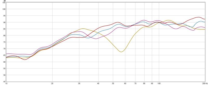

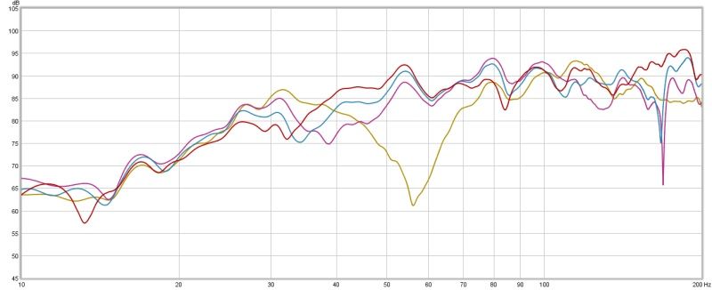

My room setup is below, but now all 4 subs are up front in 2 stacks of 2 next to the KHorns.
My only complaint with the way it's set up now is that I have a ~10db null around 60hz and my other two listening positions aren't looking as good as they did when I had the subs spread out.
I'm going to try Craig's suggestion and lower the x-over on the Khorns. Gonna do some measuring tonight and I'll post 'em up here.

OK, so last night I set up to do some measuring and to try some different crossovers on my mains per Craig's suggestion. Keep in mind this is the first time I've ever measured my mains by themselves...not sure why I'd never done it before, but whatever.
I found out that I'm sitting directly in the center of a giant 60hz null!
Check it out. This is just FL/R speakers, set to large, Audyssey off:
And here it is compared to some varying distances in front of my MLP. My MLP is currently 5' from the back wall where the picture window is:
2' in front of MLP - Magenta
3' in front of MLP - Blue
4' in front of MLP - Red
Smoothed to make it easier to compare:
Just to verify it's a null and not my speakers, here is the FR of the LFE only, same suck out right around 60hz:
So, it's no wonder I've been having headroom issues since Audyssey is boosting the sh*t out of 60hz....the distortion is 7.65% @ 60hz! Can't imagine how much amp power it's eating up for Audyssey to boost that region by ~10db. This is mains + subs, Audyssey on:
I tried moving the KHorns out of the corners about a foot or so and the null didn't change at all....seems like the only thing that is going to fix this is moving my MLP and that is just ruining my mood right now. The room just ain't gonna look "balanced" if I move everything forward (at least 2', but 4' would be better).
May have to think about rotating the whole setup so that the screen and mains are on the long wall....really don't want to do that though, it's a lot of work and it's really gonna mess with my feng-shui...especially if I end up in a similar situation and it was all for naught.
Not sure what I'm gonna do in the future, but for now I think I should run Audyssey a couple feet in front of the MLP just so it isn't boosting that null and straining my system.
Alan P is offline

Ahh yep I think you finally found the culprit. That massive boost in the 60hz is eating up some headroom. I think when you get that sorted and Audyssey does not need to apply so much eq, those 4 XS15's are going to sound night and day better.
I bet those Khorns will sound completely different too!! I have a pair in my shop office that is only 1200^3...needless to say they are amazing!! Wish I had the room for them in my house. They were a handed down from my grandfather along with a Adcom GFA-555II.
