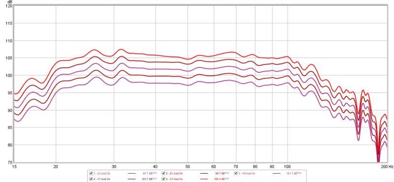

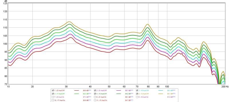

Thanks d00d, but while I was waiting, I made a discovery! Anyone wanna buy a MiniDSP??
Check it out. Same placement (1/2/5/6) but without the MiniDSP. I had to invert the phase on the 2 rear subs (since I lost the time alignment ability with the DSP) and re-calibrate the levels (so they may be off a tiny bit from session to session), but I'd say there's a substantial improvement in max output.
Audyssey off, LFE only.
Before (with MiniDSP) / -23,-21,-19,-17,-15,-13:
After (without MiniDSP) / -23,-21,-19,-17,-15,-13, -11,-9:
Without the MiniDSP, no matter how high of a sweep I ran (max was -9), I had no funny noises from the subs at all. I did however get a warning about clipping once I got to -11...I measured -9 anyways (and got the same warning). How do I measure higher without getting that warning?? Looks like I started compressing at -9 (but could that be the "clipping"?).
I hateses dirty MiniDSPeses.
sounds like you were clipping the input or output of the minidsp, you might need to get a multimeter out and measure the voltages to make sure you can drive the minidsp without clipping. I think there are quite a few threads on the subject, e.g. Mini-dsp input voltage and its limitations.
3ll3d00d is online now
Thanks d00d, but regarding the new measurements, where do I stand now? Max SPL of about 110db now? Should be good to -5MV??
About to test some content, brb.
Sounds like you needed to simply reduce the output on your receiver sub channel or MiniDSP input and then raise the level on your subwoofer volume dials. Digital clipping or clipping of the MiniDSP would cause an artificial limit to SPL and can be quite audible. This is the one known limitation of the MiniDSP products, but can usually be worked around.
Alan P and basshead81 like this.

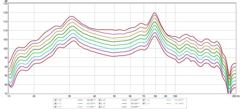

Your right basshead, no funny noises....although I couldn't get it to not give me the "clipping" warning. I tried calibrating with the MV at +18 even....no deal.
Anyways, I think I'm finally getting somewhere close to where I should be.
After running Audyssey, my max SPL sweeps are looking downright awesome!
Audyssey On, LFE only.
Before (with MiniDSP) / -23,-21,-19,-17,-15:
After (without MiniDSP / -23,-21,-19,-17,-15,-13,-11,-9,-7:
Looks like I can almost hit 115db! YEAH! Glad I figured out the problem....now I need another free day to mess with the MiniDSP.
I did get the "clipping" warning on -9 & -7 this time around as well.
Now to go try out some content real quick...wife will be home in about 15 mins!
Alan P is offline

Oh yeah, the above sweeps were with the subs running 7db hotter than where Audyssey set them.

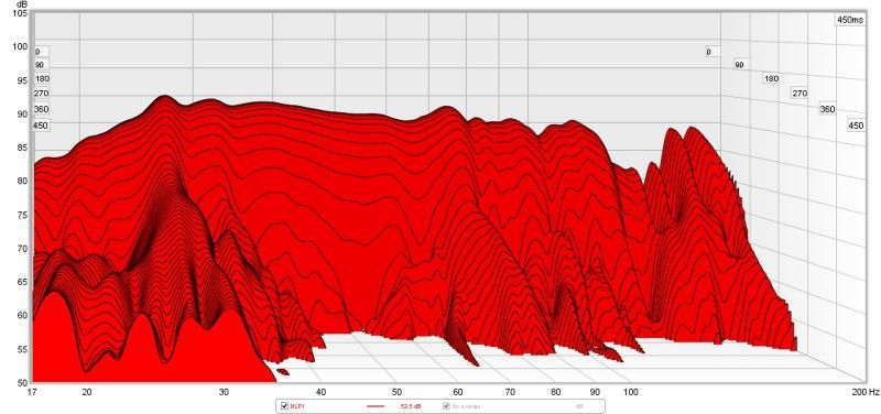

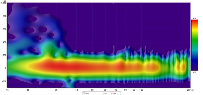

post #150 of 157 Old 08-22-2014, 10:48 PM - Thread Starter
Alan P's Avatar
Location: South Dakota
Posts: 9,366
Mentioned: 50 Post(s)
Quoted: 4697 Post(s)
Liked: 3324

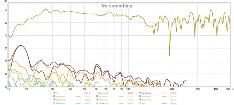

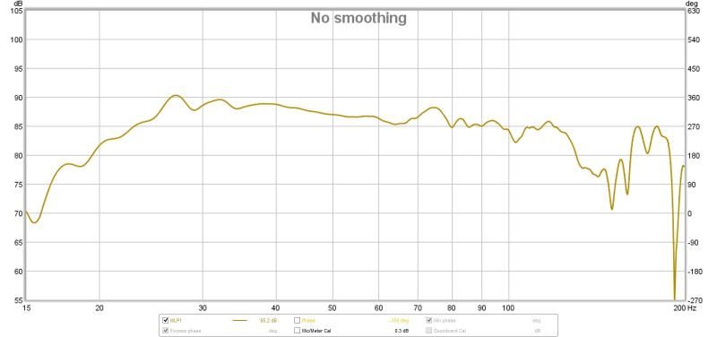

OK, time to show off.
Distortion: at -23 sweep level, under 1% THD until about 25hz. Max of 17% @ 17hz.
Frequency response: yeah, I wish I dug deeper, but I'm really really happy right now.

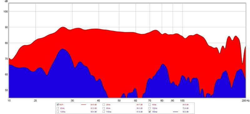

Decay: probably could improve with some bass traps (been on my short list for quite awhile, just been waiting to sort out my placement/phase issues).
Waterfall.
Spectrogram.
Any comments or suggestions are more than welcome and I'd like to thank all the folks who contributed to this thread and helped me sort out my issues, especially basshead, d00d and Mr. Mark Seaton!
I think the majority of this thread was wasted on my improperly wired voice coils (like 8 months of my life ), but there is still a wealth of great info here for anyone trying to integrate multiple subs in an unconventional room.
Thanks for all the help guys!
