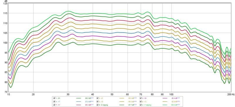

After living with the new/improved sub setup for the weekend, I'm really enjoying how it sounds...and I've noticed a strange, but happy phenomenon. The bass doesn't seem to travel throughout my house like it did before. In fact, it doesn't travel much outside of the "rectangle" that defines my listening area. Not sure what this is attributed to, but my wife likes it.

I have noticed the same thing...if the subs are not properly aligned you will actually end up with more bass in other areas of the house compared to the LP.

Exactly. If the multiple subs are fighting at your listening position, they often are combining somewhere else more constructively. If you then proceed to boost the range that isn't getting to your seat efficiently, it gets even more intense where ever it is combining better.
Were you able to get the MiniDSP back in the mix with the gains adjusted?
I might have missed it, but I don't recall seeing a clean overlay of the individual responses from final locations and the combined output all at the same drive level?
Haven't had time to mess with the MiniDSP yet, but it's on my short list.
I haven't done new individual measurements since the final position tweaks and gain matching. I'll do those as soon as I can.
A few posts up though I posted this: combined output, positions 1/2/5/6, Audyssey on, max spl sweeps:
