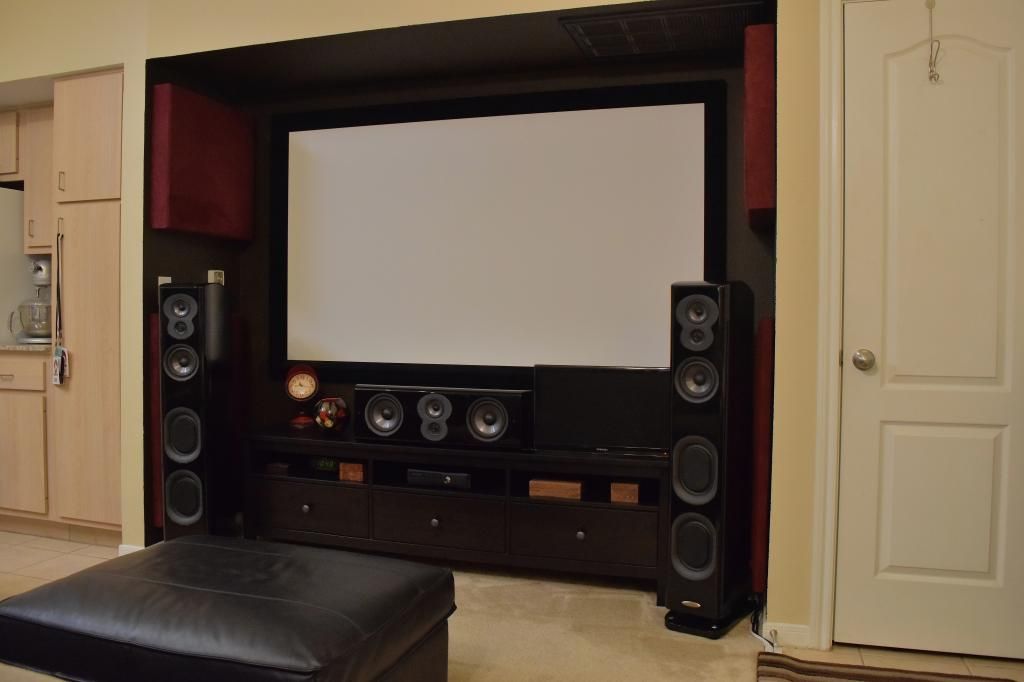

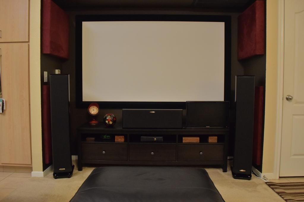

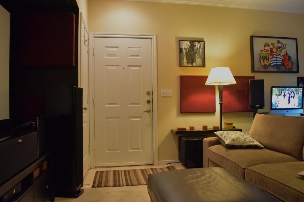

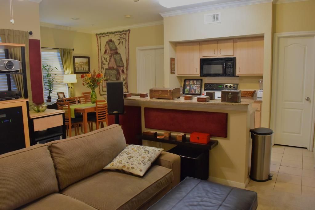

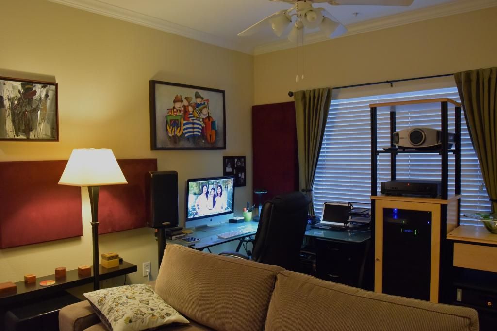

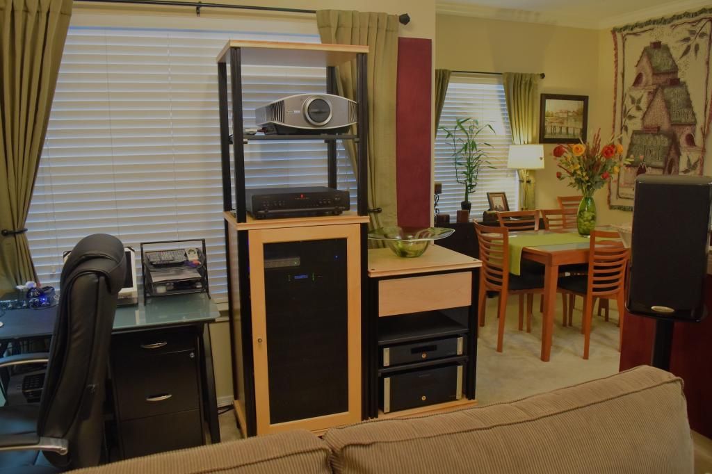

Here you go!!
All my panels are ATS Acoustic in Wine Microsuede. You can see different sizes and thickness. Some panels are custom build. Some are 2" and some 4", the 4" are bass trap with full range absorption coefficients.
Matt2026 likes this.
