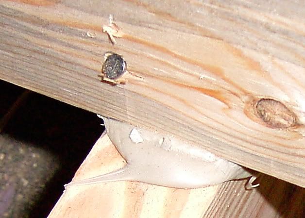

Ok. here ya go.
I did manage to get 0ne Platform panel down before I realized I wanted to snap these shots, so obviously, you only see the remaining one featured. This Theater being upstairs, the standing water on the slab below wasn't a hinderence. however, the 8 Pros that must go under the Sub-Flooring must wait, and so being, the photos of that application as well.
But only a day or so.
PS, Note the "Lady" Technician. Invisible Stereo is an Equal Opportunity Employer. Especially when they wear Short Shorts in the summer.
In the Pic below, you see how the Platform, a 2" x 4" crossed layer on top of a "Floating Base" of 2" x 8"s, was first set on top of a healthy dollop of Liquid nails, then Nailed directly to the 2" x 8"s The 2" x 8"s are floating on top of Black Exterior Sheathing.
