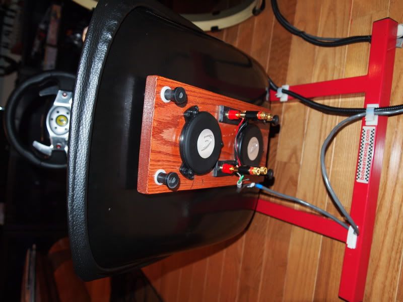

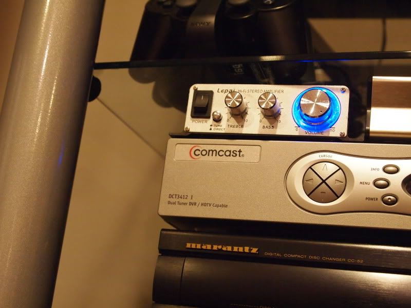

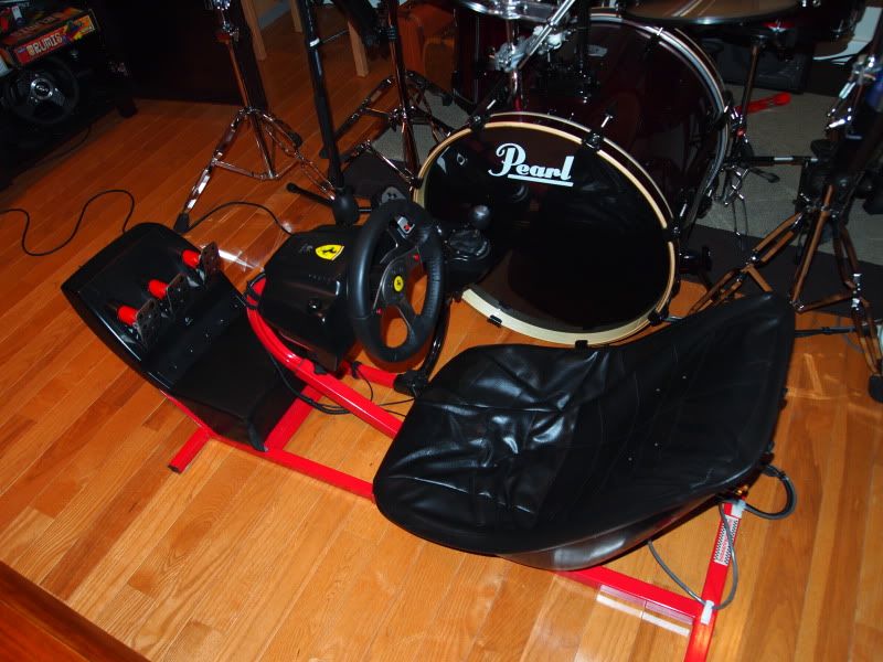

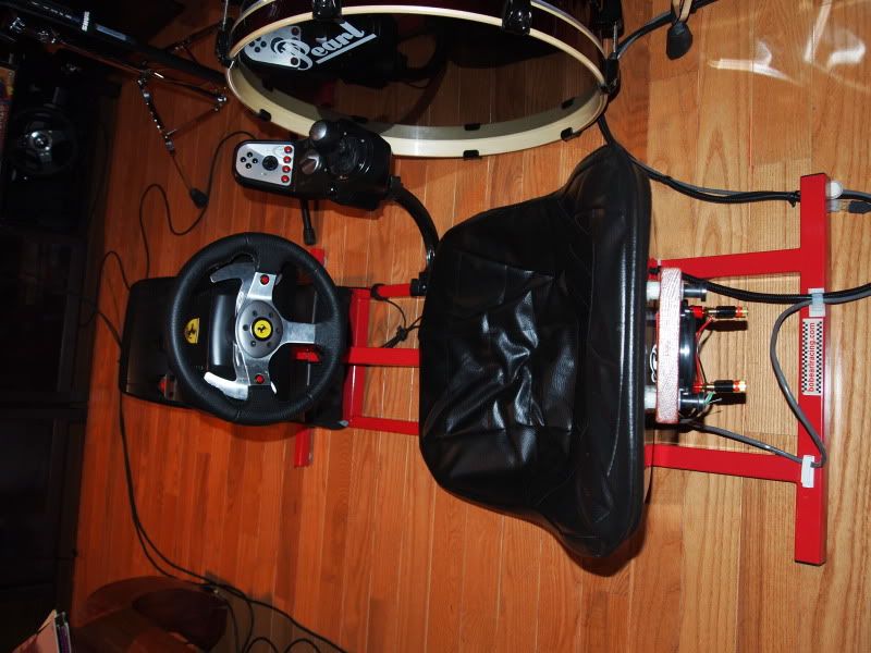

For my son's driving seat, we use two Dayton mini "puck" shakers:
They are driven by this "powerhouse" T-amp (cost: ~$20):

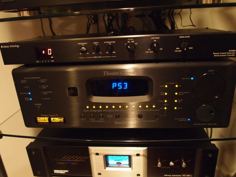

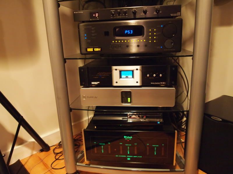

The driving seat setup works really well, although the GT5 game he uses is fairly weak on generating effects so we have to crank that T-amp up all the way.
The 4 Auro Pros are being driven by a spare channel on the McIntosh amp and controlled by an Atlantic Technology parametric sub control that provides frequency cutoff and shake level by remote:
I really haven't found anything lacking in the Aura Pros, but I would also be interested in hearing from someone that has tried both.
