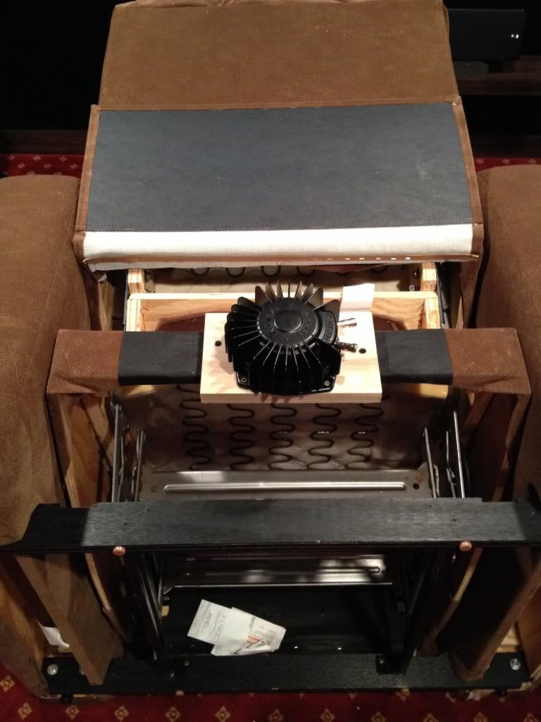

design1stcode2nd's Avatar
Posts: 825
Liked: 33
Originally Posted by afterlife2 View Post
Where are the pics or it did not happen. Edit sorry about your flood. Glad you're up and going.
I wonder if the FMOD 50hz will help my setup? Also do you guys use Mono Bridge or Stereo? I think it sounds/feels good though.
Now that there are pics it has happened
This was the only real spot I could find to mount it on my recliners. I have the amp cutoff between 40-50.
afterlife2 likes this.

The shaking level does tend to vary a lot movie to movie. What I've found is that the key is to get the sub crossover setting just right. For my setup it's around 55hz and with this setting I get the right things shaking and not much else bleeding through. I do find the need to adjust the "volume" level up or down to adjust for some individual movies/content, but I never touch the crossover setting.
I have a subwoofer EQ/preamp in front of the shaker amp, so I can tweak the shake level from my harmony remote. If you have multi-zone AVR, you can run the LFE output into Zone output and use the Zone volume to adjust the shake level on the fly.

How many of you have this hooked up to a system in your main viewing area? i.e. living room? I ask because I have thought about doing something similar but don't know if it would be too much for day to day watching. I figured worst case I could use an amp that I can turn on and off via ir and set different scenes via my remote so if I don't want to fire up the shakers I don't have to. I have always been intrigued by them and think they would probably be pretty cool. Although I do listen to a lot of music too and I dont think I would want them going off (of course that depends on where I set the crossover for the shakers too).
Would like to see your setup pjp.
