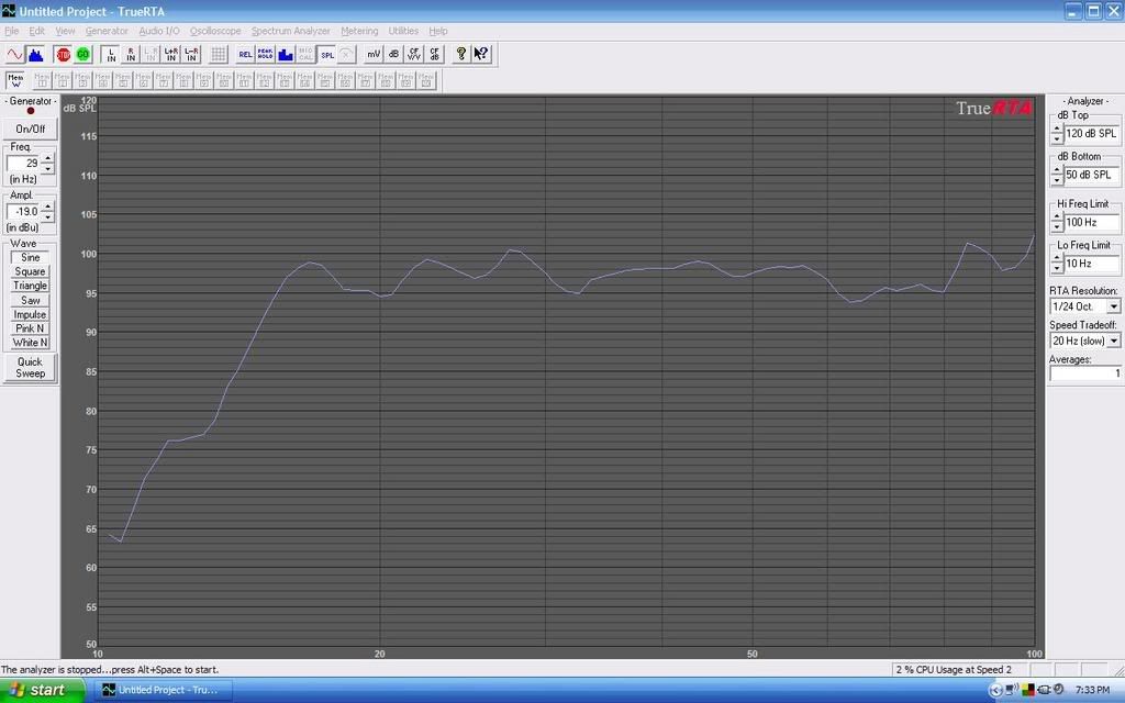

post #96 of 7153 Old 10-25-2006, 04:46 PM
craigsub's Avatar
Posts: 11,550
Guys, I thought everyone might like to see the graphs from the newest TrueRTA software. I just got a new laptop, with a soundcard rated to 10 Hz. Here are graphs of the Hsu VTF-3 HO with no EQ, and with just using the SMS1 AUTO-EQ.
The Hsu is in its 16 Hz tune, turbo installed.
We will be doing similar graphs with the Fathoms, and also look for more graphs of movies scenes using the newer software over the next few weeks.
Hsu with no EQ:
Hsu with Auto EQ.
Even the Auto EQ function with the SMS-1 did a very nice job cleaning up the FR. The subwoofer is being crossed @ 80 Hz in the Parasound, so the software "pushed" the response above 80 Hz "up" .... when running TrueRTA graph, the crossover is defeated, so the response "looks" higher than it really is, if that makes sense.
craigsub is offline
post #97 of 7153 Old 10-25-2006, 04:58 PM
craigsub's Avatar
Posts: 11,550
Here is the JL Audio Chart ....
craigsub is offline

Originally Posted by CSEmoses View Post
Did any of you notice that the room they measured in at JL is 3200, and the other room referenced was 7200 cubic feet? seems like apples and oranges, in rooms with that much difference.
Course, i might be missing something ...
There will be some difference at very low frequencies but not the kind of discrepancies between our numbers and TN's... it's more like Red Delicious and McIntosh apples, rather than apples and oranges.
