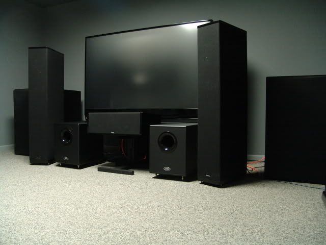

I moved my MBM-12's back up front with my mains and put the Velodynes in the bedroom. This seems to be the placement where they sound the best. I have the Conquests lowpass filters engaged at 50 Hz. The MBM's filters are bypassed. I ran all 4 through a Paradigm X-30 active subwoofer control. This gives me a simultaneous volume gain. Once the MBM's/Conquests levels were matched they were set to the same output as the main channels.
I use an anti-mode 8033 on the four and an 80 Hz lowpass in my controller.
I put my Audio Control Phase Coupled Activator in the system to blend in some subharmonics for fun. It generates 15-30 Hz subharmonics from a 30-70Hz sampling range. Once the subharmonics are added I dial the volume level back down to match the mains. I can switch it in or out of the system when wanted.
Originally Posted by bsoko2 View Post
John - want to add a little more mid bass for those explosions and gun shots, helicopter blades rotating, etc. change the xover on the true sub to around 55-60hz. It does bring up the mid bass and ads to the depth of it.
Bill
Bill,
I will give that a try.
John

Originally Posted by ribbit View Post
that's one neat setup man. mine's a mess.
Thanks Mike,
I believed you asked if I thought my original ButtKicker setup was needed once I replaced my dual HGS-18's with the dual Conquests. The answer is yes "in my case". My Buttkickers add something the Conquests do not.
John
