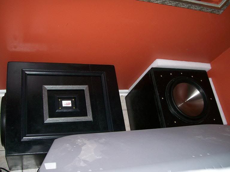

MKTheater
1. 2300cuft (sealed, insulated and treated)
2. Dual 18 inch horns
3. Master Volume 0 db Sub calibrated to 75db on SPL meter (uncorrected)
116 db**21:12 to 21:15 Alien Pound Under Earth
121 db**21:43 to 21:50 Grounding Turning and shaking
122 db**23:11 Ground Implodes down
125 db**23:35 Tripod first puts foot out
125 db**23:46 Tripod Smashes the Car with its foot
121 db**26:22 First Heat Ray
123 db**27:19 Massive Heat Ray blows up building
123 db**31:48 to 31:52 Tanker Explosion
117 db**59:14 Ferry---First Foot Stomp
117 db**59:18 Ferry---Second Foot Stomp
119 db**59:20 Alien "sound" tone (Initial Freq)
116 db**59:24 Alien 'sound" tone (LOWER Freq)
120 db**1:10:09 Fireball Explosion/Alien Appears
123 db**1:45:13 Low Sweep when Alien Crashes to the Ground

Well my new subs are here. But before I get to the good stuff I went ahead and tested my old sub so I could have something to compare it to. I added an extra time stamp or two and just corrected ones that you had listed. Well here goes:
21:12-21:15 Alien Pound Under Earth-98db
21:43 to 21:50 Grounding Turning and shaking-101db
23:11 Ground Implodes down-101db
23:35 Tripod Arises from ground-102db
23:46 Tripod Smashes the Car with its foot-102db
26:22 First Heat Beam-103db
27:19 Massive Heat Ray blows up building-102db
31:48 to 31:52 Tanker Explosion-104db
59:14 Ferry---First Foot Stomp-98db
59:18 Ferry---Second Foot Stomp-96db
59:20 Alien "sound" tone (Initial Freq)-I only took highest reading from this spot-104db
1:10:09 Fireball Explosion/Alien Appears-101db
1:45:13 Low Sweep when Alien Crashes to the Ground-108db
This is with a PB12-ISD (with old driver) Master volume at -12 and sub running at 78db or +3 hot. All numbers are uncorrected. These tests were conducted with an analog Radio Shack meter running C-Weighted and fast. Tests were done with speakers all ON because I don't know if it's possible to do the tests with speakers off on my receiver (Yamaha RX-V 2500) Room size is 3000cu/ft.
Hope to update this in an hour or two with results from the 1st location!

Sorry about that. So yeah +6 hot is correct. Well here is a quick rundown of my corner numbers. I did them quick but did test phase/calibrate, albeit quickly so I could come up with some numbers. Here's what I got:
21:12-21:15 Alien Pound Under Earth-98db (101db)
21:43 to 21:50 Grounding Turning and shaking-101db (104db)
23:11 Ground Implodes down-101db (108db)
23:35 Tripod Arises from ground-102db (109db)
23:46 Tripod Smashes the Car with its foot-102db (108db)
26:22 First Heat Beam-103db (109db)
27:19 Massive Heat Ray blows up building-102db (108db)
31:48 to 31:52 Tanker Explosion-104db (109db)
59:14 Ferry---First Foot Stomp-98db (100db)
59:18 Ferry---Second Foot Stomp-96db (101db)
59:20 Alien "sound" tone (Initial Freq)-I only took highest reading from this spot-104db (108db)
1:10:09 Fireball Explosion/Alien Appears-101db (105db)
1:45:13 Low Sweep when Alien Crashes to the Ground-108db (109db)
I placed both subs right next to eachother in the corner. I did not move them once I started testing to tweak for location. Well I'm gonna go try my other location out to see what I can get. Be back later.
movies2090 is offline
