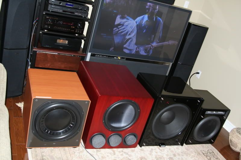

Before getting into all the observations and opinions I thought we should start on a lighter note. So let's hear your views on:
WHAT'S WRONG WITH THIS PICTURE?
John

the ultra is trying to be a sealed sub? (and is trying to spit out the bungs)

The answer is obvious. The Gotham is MIA. The 4 Amigo's??

One of the subs looks constipated

There is a serial grill thief in your neighborhood.
The two 13" drivers sure look tiny next to the 15" and 18". Makes the final results more surprising.

Sending that Ultra in sealed mode up against those big-amp'd brutes is like sending it into a fight with one arm tied behind it's back. Still, I know it fared well.

I know the SVS....
Paradigm Servo-15, SVS PBUltra-13, Velodyne DD-18, JL Audio F113.

Regardless of the comparo, that is a great picture to give perspective to the different alignments and design goals of each sub.
It is not an apples to apples comparison with regards to alignment or price, but they are all very capable subs being considered here. (2 sealed servos, 1 sealed, 1 ported acting as sealed, 1- 15", 1-18", 2-13.5")
It does give some extra appreciation to just how much ooomph is packed into that little JL! That fact that it is even in the same league in SQ and output here is a testament to how well it is designed.
