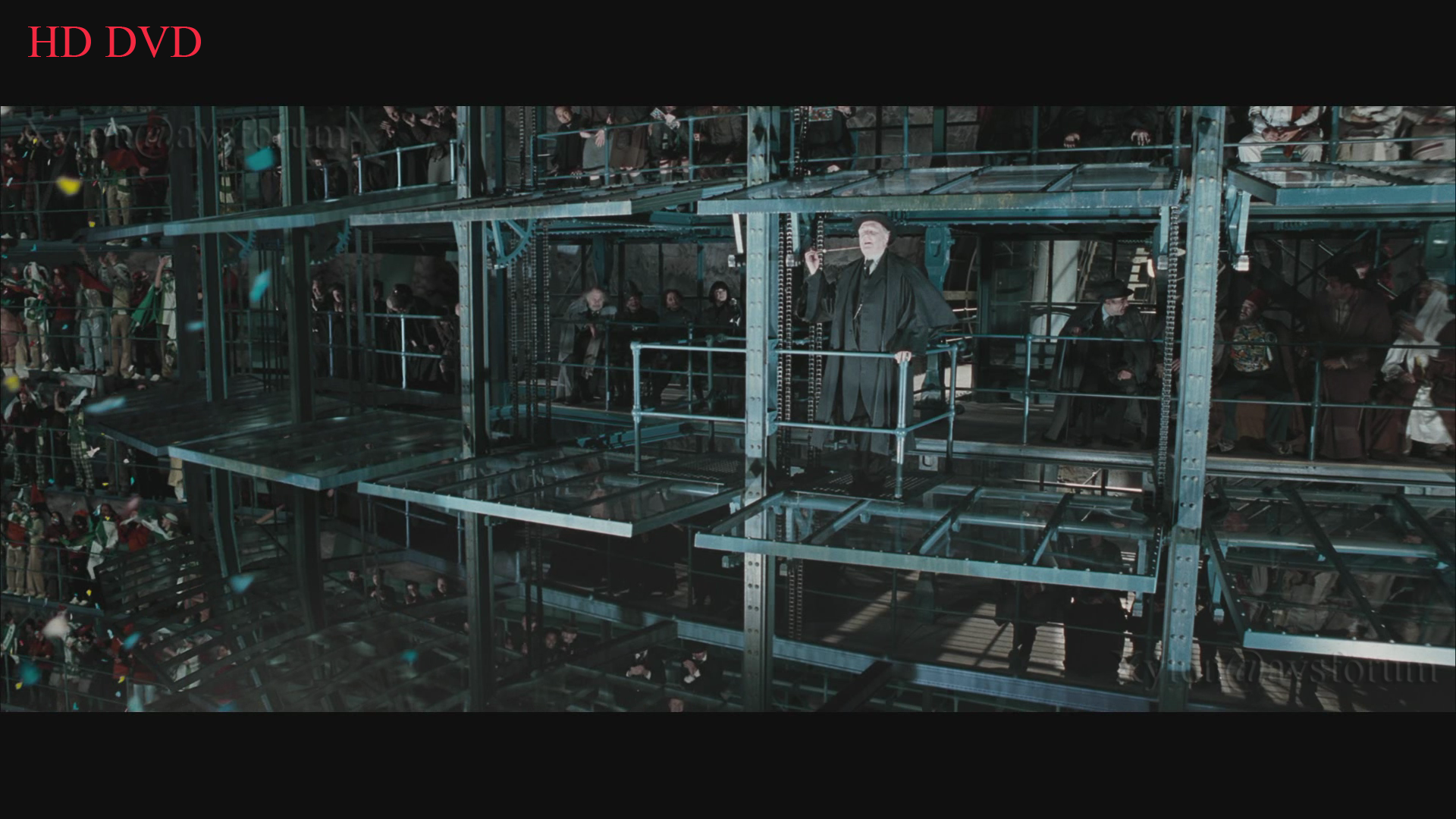

Harry Potter and The Goblet of Fire
11.20 GB*9.20 Mbps........................................................ ............................................................ ............................................................ ............................................................ ............................................................ ........................................................19.5 0 GB
