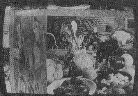

BTW, here's what an un-decoded MUSE-E signal looks like. You can see the 4-channel DANCE-encoded digital audio data, the line-sequential chroma and the luminance information - the total signal is 480 pixels wide by 1125 pixels high with each field being 562.5 lines.
I always thought that Muse is completely analog, but you suggest that there is some kind of digital encoding involved in the video path (I know, audio is a different thing). I got a good number of technical papers from a buddy (who probably reads/posts on AVS as well).
I own a good number of Muse LDs, decoders (3), and players (2), and I can confirm that picture quality is greatly dependent on the effort put into players and decoders (mainly decoders).
Btw.: the book is mine now
Btw(2): Have you ever seen the Sub-Nyquist signal "in action"? :

Before I got the Hi-Vision book, I thought MUSE was 100% analog too - I mean, that's how it was ALWAYS referred to in the press. They never said that the component Hi-Vision signal was digitized and from there all processing was digital. The Time-Compressed and sub-sampled digital Hi-Vision signal is then converted back to analog with an 8.1 MHz bandwidth and broadcast as a PAM FM signal.
I wonder if the vast majority of the people who wrote about MUSE even knew it was digital?
Since MUSE decoding wasn't a 'set' process like, say VC-1, each company could decode the signal in their own 'unique' way - with varying quality results. From what I've read, a lot of Hi-Vision televisions with MUSE built-in didn't have full-bandwidth MUSE decoders. It seems, from reading brochures and stuff, that the late model MUSE decoders finally strived to implement all the features of the system, including the MUSE-II color/resolution improvements.
Oh, and nope, I've never seen MUSE - I've seen HD-MAC on LaserDisc - boy, was it poor! Of course, HD-MAC was a mess of an HD standard - too complex and hindered by the backwards MAC compatibility forced into it.
BTW, what's the picture from? I'm glad you got the book - it's great!

The picture is like a full-house in a poker game. It shows parts of the time compressed signal which remained in the decoder memory when we switched the chapter on a Muse-LD. The probability to regenerate this exact picture is nearly zero . Don't remember from which title this scene is (probably Close Encounters). Friends of mine an I did extensive testing with different players, decoders, and we had almost every Muse LD which was ever produced in one room. I took the picture during that session, and we realized afterwards what it is.
The specifications that I have in my hands contains lots of technical details about how the analog signal is constructed, with all the sideband folding and so on, but a considerable part of the signal seem to be digital information which define what the decoder has to do with the upcoming color signals. So it's a kind of combined analog and digital system.
Worth to note is that NHK developed a good number of improvements to the standard over the years, which resulted in up to 4, if not 5 generations of decoders. The Pioneer HM-D101, as 2nd gen decoder contains a whole lot of PCBs, whereas the Panasonic TU-MDC100, as 4th gen / last stand-alone decoder, is fully integrated, and that one produces an awesome picture quality and the best colors possible from a Muse-LD.
Edit: and, yes, HD-MAC was a terrible attempt to invent the wheel again, an example of incompetence paired with arrogance, so it was doomed from the beginning. They better had taken the NHK system as jump-start.
