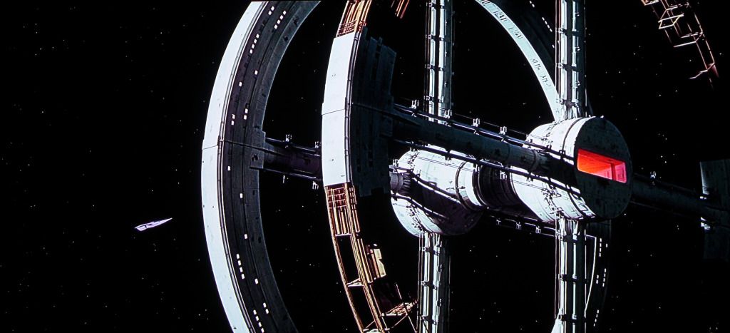

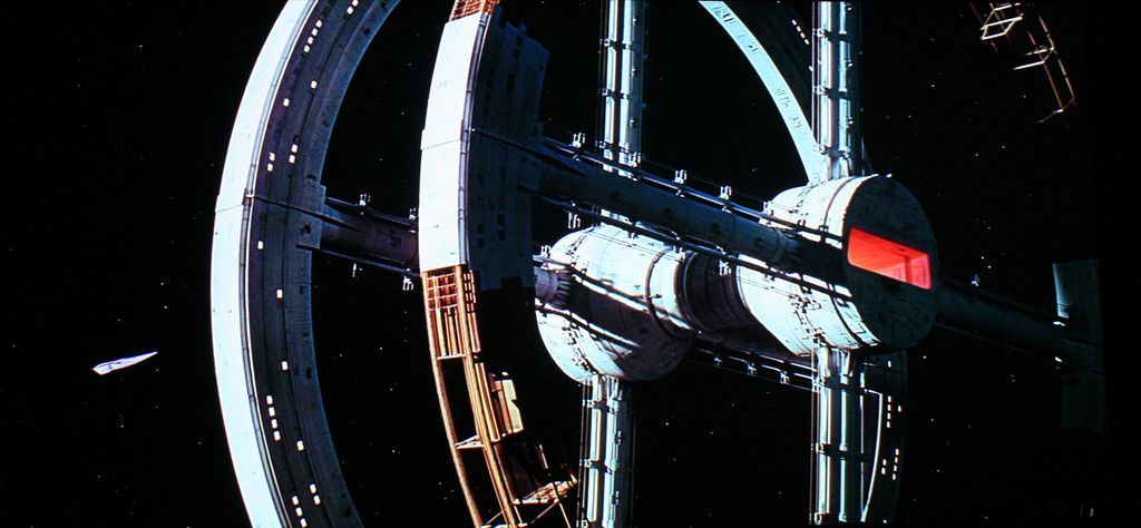

A-lens or not decisions decisions........14`.2" throw 1.97 TR.
JVC RS65 (X90) 3m white 1.2 gain screen 108hours Calibration at 250hrs. Resized only.
Arts Sim HT5000 + A-Lens 4.25m screen

Thanks for the reply Hogpilot
Your A-lens is giving you more lumens needed for your 3.4m screen which is good if needed but what else is the A-lens doing to improve the picture?
If extra lumens are not required, menus visible all good but is the picture quality something you can photograph to show A/B comparisons or is it more like a perceptual improvement?
The 6million odd e-shifted pixels and no SDE remaining without the A-lens and lower lumens degrade picture quality enough to buy the A-lens?
Just trying to understand, i can purchase an A-lens with a 2 week full refund if needed but to save the hassle hear i am, extra lumens would be nice as lamp ages but really asking about picture quality..

It's notoriously hard to appreciate the difference an A lens can make just using photographs (you need the full res available otherwise it's a waste of time), and usually only a demo can provide what's needed.

I'd say the lumens are the biggest contribution. I haven't had a chance to A/B with and without the lens in my final setup (zoom vs. lens). I have yet to notice any extra CA, but the Isco is about as good as they come in this respect so no surprise here. What's your viewing distance?
I would love to take some pics, but I'm currently deployed to the Middle East until July, so unfortunately my theater will be sitting and waiting unused until then Sorry I can't offer more help on this...
Only you can really answer that question, but I'll offer this up - when I was A/B'ing the Enlightor 4K screen material against the Seymour AV CenterStage XD, the 4K clearly had the edge in terms of lack of screen surface visibility, yet my eye was constantly drawn to the image on the XD because it was noticeably brighter. So I guess what I'm saying is not to underestimate the benefit that the extra brightness will give you. Whether or not it's worth the cost...everyone has a different answer as to how much money is "enough" - hence the rather heated debates on the subject in this forum
I would say that extra brightness contributes to PQ significantly. Since you have the 2-week grace period, I'd recommend you give the lens a shot and see if you like the result. If you don't, at least you're not out any money.
