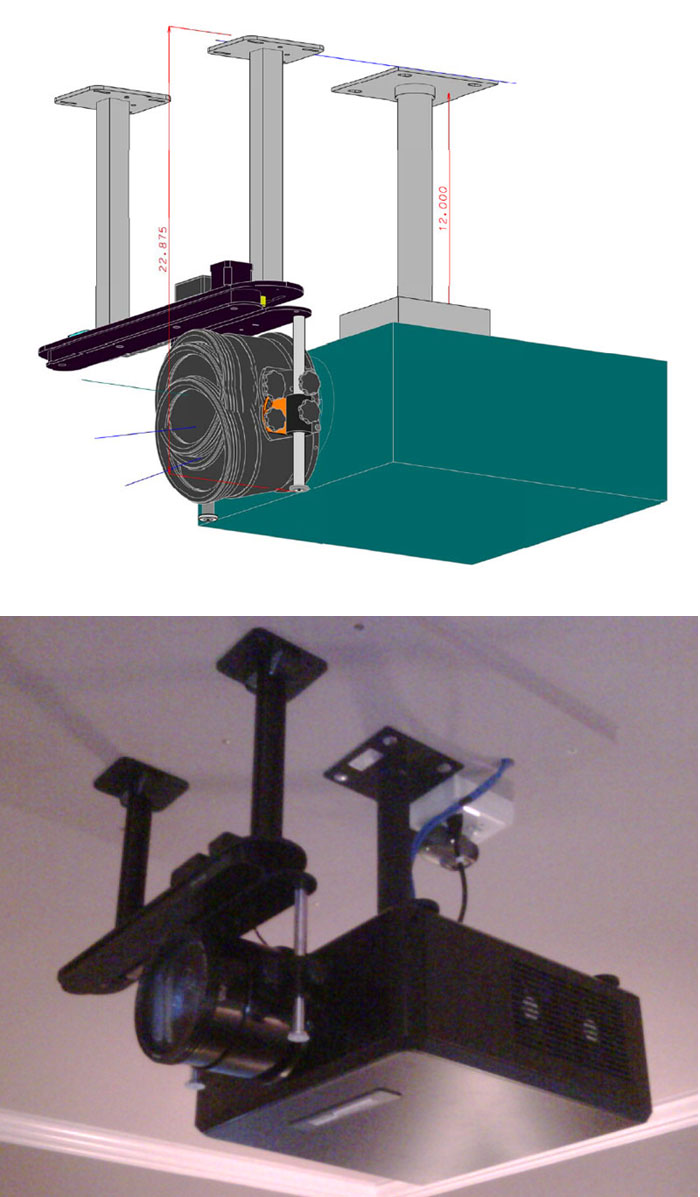

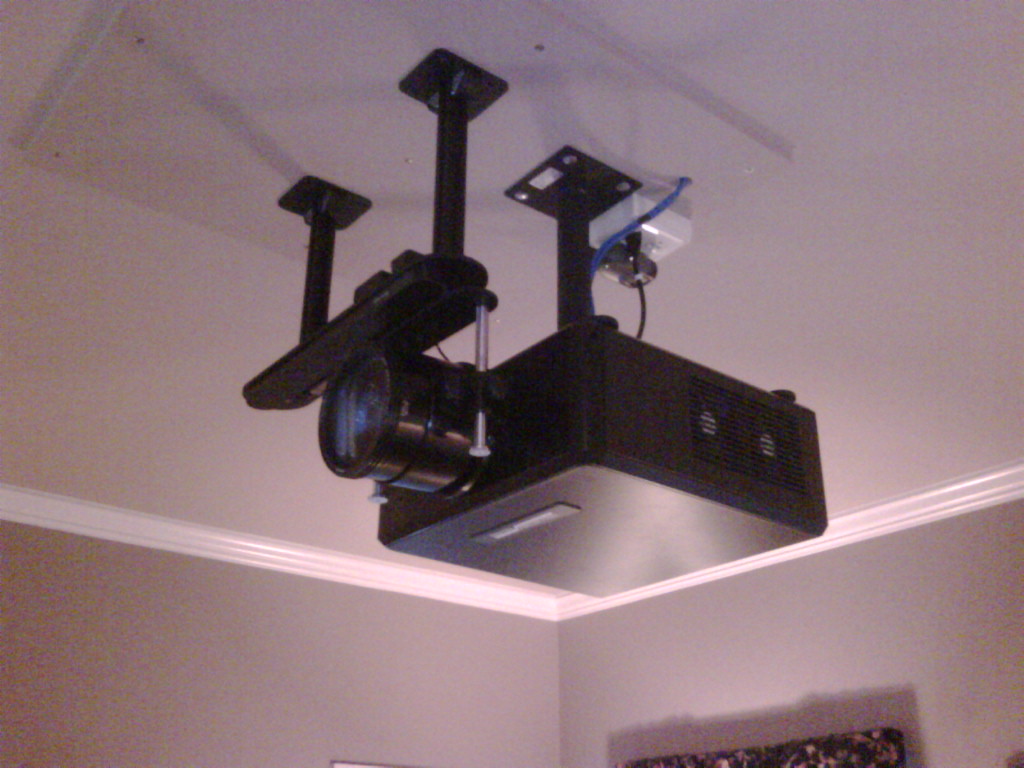

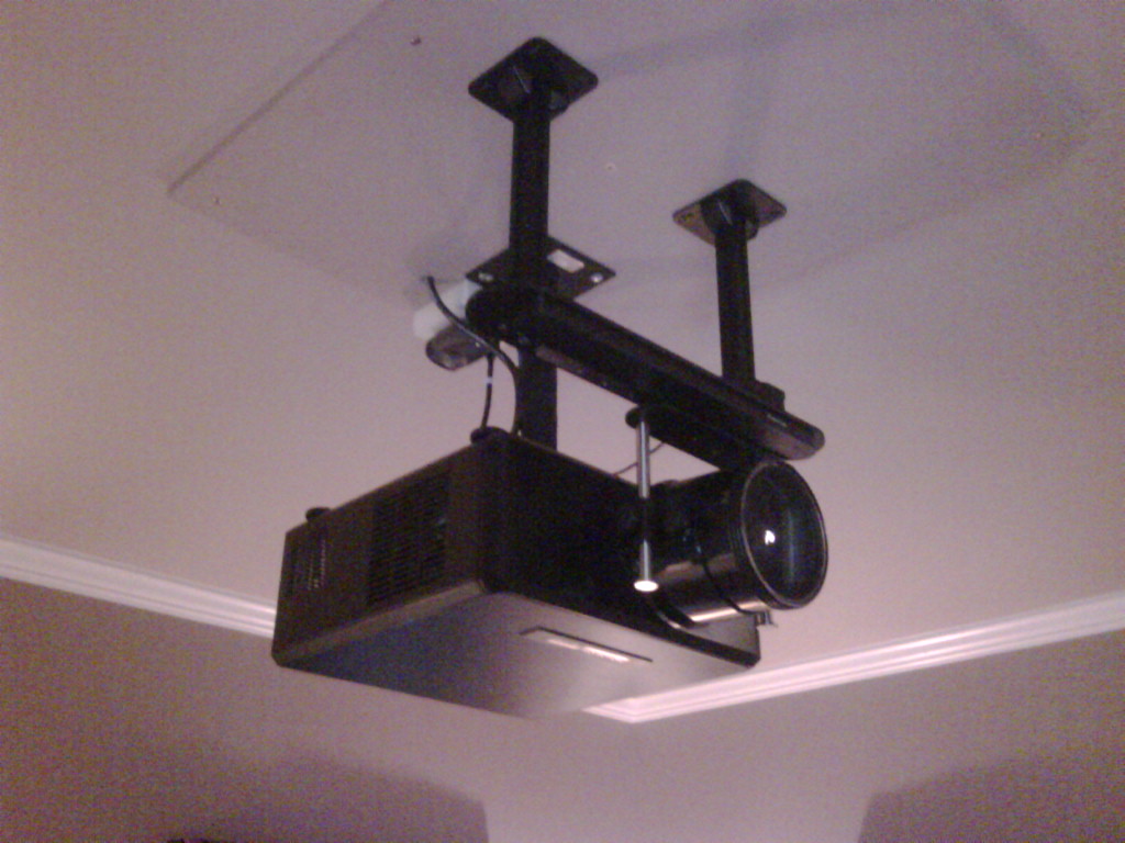

This combination is amazing. The mechanics and construction of the CineSlide are extremely precies and well made [overbuilt for the task]. When activated the slide is quiet, smooth and quick. Again the tolerance and craftmenship are top shelf.
The packing on both items was very well done. The lens came in its own plastic foam filled case were as the CineSlide came in foam packing and individual components were boxed and wrapped. Again to notch.
The father of CineSlide, GetGray [Scott, HTTech] is very professional and detailed in his assemly and installation process. He is truely a videophile at heart with a wealth of knowledge and insight to achieving the best performance of his product and most projectors. Now here is the really interesting part. There was no mounting plate for my projector [DPI M260LED, there is plate for the M260 w/lamp]. What do you do? Well GetGray made one! It was spot on. Prior to installation he created a CAD drawing that located the projector mount, slide leg mounts, lens center and even the floor joist to transpose to the mounting board [3/4" birch plywood].
Most installers prefer the mount that retrofits to the projector case but not me. I wanted in separate that allowed easy chaning of projectors and no movement or "frame settle" as a result of slide moving.

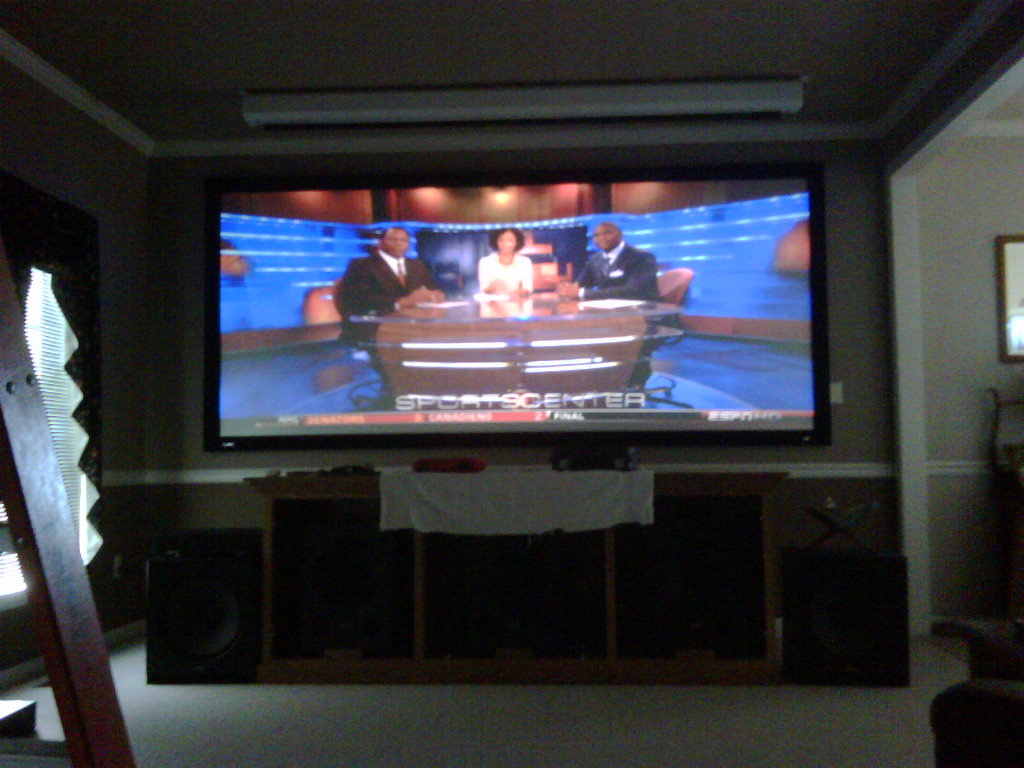

Is that a curved screen or is that the amount of pin cushion distortion you get with the ISCO III?

I think it's hard to tell from that camera phone picture...it looks like there is a bit of 'fisheye' type effect on the whole picture (especially in the middle if you look at the white trim on the wall below the screen). I don't think it helps that the picture on screen is a stretched 16:9 program rather than a 2.35:1 source. Hopefully there'll be some better photos later to calm your worries Taffman.
FWIW I get about 1-1.5" of pincushion across a 9.5' screen with an Isco II, which is tiny and easily lost by the screen border and slight overscan.

I know both Scott and Mike. Knowing that Scott is an extreme videophile, There's no way they would accept a pin cushion effect from the isco. That's the camera doing that.

true. look at the bottom screen border. it has the same amount of curve. im thinking its the camera.

The pincushion was due to the phone, and I agree the 1.78 material being stretched adds to the illusion. It's about a 1.7 TR so there is some, but definately not much. I think 1/4-3/8" IIRC. The poor photo is the reason for the look. Sorry, it's all I had, was travelling light.

The cell phone pics are not very good but the only thing we have. I do not own a good camera and tripod sorry fellas. At night it looks like a 110" plasma I kid you not.

Well, part of my reason for going to visit with Mike was to see how the template and projector mount all fit together. DPI didn't have real 3D CAD drawings available and there was some confusion (from them) over mount hole locations from early production units. I modeled the Projector, Chief mount, and CineSlde all together and produced a template to make it easy for the installer to use. Installers want the "easy button" for installing A-lenses. I'm a strong proponent of independent mounts for a variety or reasons. Since independent mounts aren't the "easy button" I'm trying to throw the installers a bone so to speak by giving them a printed template. Particularly for popular projectors. Just lay it on the mount surface and mark the holes, mount, done. I was very pleased how this new PJ install went. Fit perfectly. Thanks to 3D cad. Here's a render of the PJ and mount that the template was generated from. You can see it matched the end result just as planned.
