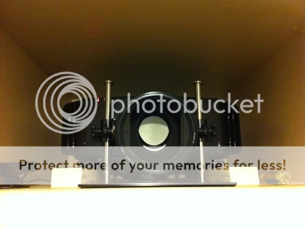

I what my vertical cineslide. I know its possible. Think periscope. Probably need 3" longer rods to give enough extension. I haven't tried it yet to see if it will work as is.

Whilst I do think it looks cool, I don't see it as the best solution due to the fact that it requires so much height. The only place that it would be totally suited is when your projector is shelf mounted at the back of the room and the lens moves up or down from there. I can't see the "pole" mount with a vertical lift being that popular because of the added height the lift adds to the complete assembly. Sure when you have 9" ceilings, you probably have the room, but at standard 8" I can't really see this idea being the preferred one. Horizontal slides are more low profile, especially for large diameter lenses like the ISCO III L

I see your point but now a lot of the PJ manufacturers are designing multi-breathing ports on the PJ chasis with a centered PJ lens. These new designs could create issues for those who prefer to move their lens when not watching anamorphic content, as horizontal movement will park the lens in front of either an exhaust or intake port on the PJ. With PJs that have an offset lens, I would say the slide would be best, but the centered lens with dual vents are best paired with a lift, IMO.

Great point and one of the two main reason for wanting this. I could pull the whole pair forward past the wall but then I have hot air venting to the glass. That has got to be less than optimal. I don't want warm to hot air blowing on the glass even if it's filtered air.

Well... First of all CineSlide™ is a trademarked name for one device. Sometimes I'm flattered that the name is used to describe all things that move lenses, but make no mistake, there is only one CineSlide™, and it does not go up and down. We'd be grateful if any non-CineSlides are not called same. It would be almost like calling a HTB prism lens a Cinedigitar.
Second, the stand in your photograph is just the tabletop base for a Multistand II. I can get you longer posts for it if you like, we make them all the time. They aren't cheap due to the polish and materials we use, but if you want longer posts, contact me off-line.
That said, you would have to reposition your lens each time, I suppose you could make a "stop" so it came to rest in the same place each time. And, I'd strongly recommend using some of Isco's baseplate holes to bolt it down, because it will be top heavy up that high.
As for breathing ports, I've only encountered one unit with dual exhaust on the front, the new JVC. But only one side really puts out any air. The lens in no way blocks the exhaust ports air flow. The real CineSlide is configurable to "home" on either side in case you worry about it. Further, because of ample yaw adjustability in the lens mount, it can be mounted as much as 15 degrees (more by special order) off axis with the light beam so that as the lens moves out of the light path, it also moves away from the projector. But that's never been necessary.
