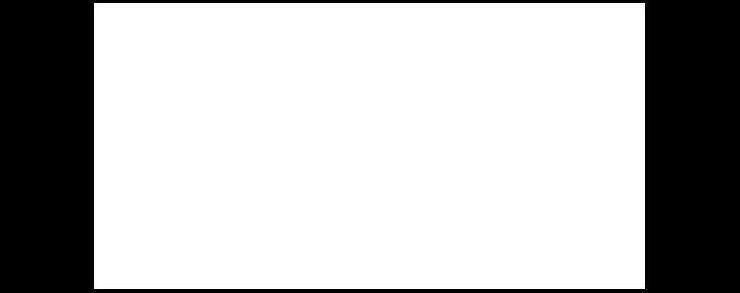

With that said, I have a relevant question to this topic.
I pulled this information from the Panny AE7000U I plan on purchasing shortly.
Note that spec sheet states that I need a minimum throw distance of 9' 4" to achieve a 120" diagonal screen size with the next step up on the chart being 150" at 11' 9". Keeping that in mind, I will have about a 12' throw distance where I plan on mounting my projector. I am space limited to 130" diagonal, so given the spec sheet, I should be good to go. (can I get a sanity check/confirmation????)
This is where I need help. Will the "lens memory" function on the Panny allow the 16:9 content to shrink within the confines of the 2.35:1 screen height.
This is the screen I plan on getting (2.35:1)
This is what I want to achieve when watching 16:9 content:
This is what I want to avoid:
Help please!
Help please!
If you zoom, you will see a 2.35:1 image on your 2.35:1 screen, and the black bars will spill over the top and bottom (like the first pic, but with overspill like the third pic, which shouldn't be visible with a black cloth screen wall). When you watch 16:9, you will zoom smaller so you will get the the second pic.
Gary
