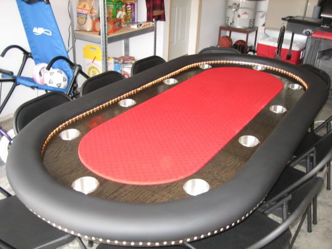

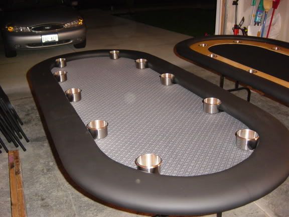

Hey Grant,
Here are the pictures you requested!!!
Table #1
Table #2
Table #3
Table #4
Hope that helps Grant!!!
I do have more pics if you want... let me know!!!
David

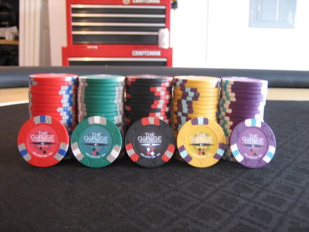

I would head over here and read, and then read some more!
I picked up a set of 1000 Nexgen, and had custom labels made for a very reasonable price! The only thing that SUCKED was putting on 2000 labels on by hand!!!
(crappy photo!)

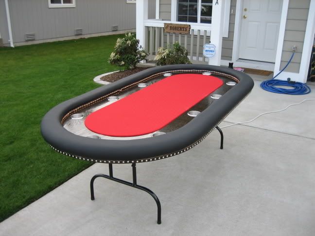

Here is my latest build...
David

David, that's pretty sweet. You're getting good! I like the color contrasts.
This Am I checked out the Pimp My Poker site and Scott's Poker Table Forum (briefly). Need to do more reading in preparation for the build, then order the materials. How do you get those tacks and the spacing just right? Do you freehand it?
Bud

Thanks for the compliment bro!!!
The spacing on the tacks is pretty easy... I picked up a spacer that is made for them! It was only a couple of dollars from Your Auto Trim!!!
I would get all of your foam (playing surface, and Rail) from YAT!!! Jason is great to deal with!!! I would get the vinyl for the rail from Joann's. It works out pretty good with one of the 50% coupons they have all the time!!!
Also, hang around Scott's Forum and read all you can, there is a wealth of knowledge, and amazing table builders!!!
