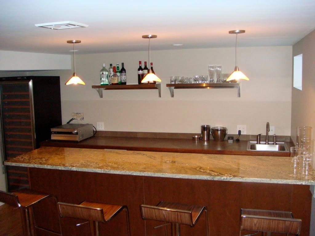

I finally found the additional lighting for my bar....I stumbled on it at Lowes. I'm going to put up some track lighting and drop some pendents over the bar and 2-3 spot lights on the art on the walls. This is the pendents I'm going to get...
I'm going to try to get it done this weekend. If so, will post pics...

For those with pendent type lighting, how high off the bar do you have the lighting? As you can see above, I decided on lighting, but in doing my initial measurement, I can't quite decide how high off the bar to make them.
Looking at photos it looks like most have gone about 3-4 feet from the top of the bar to the bottom of the light. Does that seem to be about right?
edit: I found this:
First we tackle height. Position a pendant with an “open bottom” too high; and you will have created one big eyesore! The same applies if you place a pendant fixture with “tapered-in bottom” too low. Rule – Keep the fixture at eyelevel, this will depend on average height of household occupants - but averages suggest that the optimum level lies about 70” up from the floor.
http://www.guide4home.com/dec-light/pendant.htm
But I'd still love to hear thoughts.

funny i thought about this earlier today. first, i think the lights you found are cool looking. after that thought, my 2nd thought this AM was something like that would never work above our bar (posted up above) becuase our ceiling is on the lower side (about 7'2"). our first filter in selecting was a low profile as we wanted to hang high enough so that when seated at the bar, it would not obstruct your line of sight with anyone else. and even when standing it's not bad. so that meant a pretty small light. so most didn't fit that profile though that can help when choosing too (but not when searching). not sure what that means from a measurement point of view re your question (i.e., i'm too lazy right now to go down and measure) but that at least points out an important consideration i think.

ours our at 68" inches (from floor to bottom of glass fixture)

Ahh...certainly a good point! You don't want to block any views. And I do have a TV in the bar. So that is something to think about. My ceiling is sloped. So I'll have to adjust each of the lengths of the lights. I'll have to play around a bit.

Bottom of fixture such that you don't see the actual bulb when seated:
-Steve
