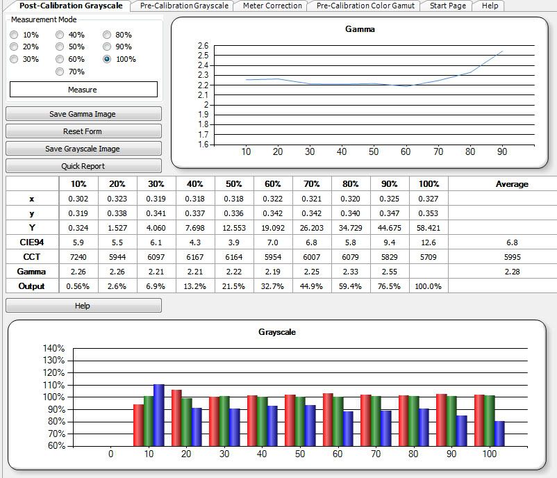

Originally Posted by buzzard767 View Post
It's might be the TV and not the D3.
I also have a PN51D8000 and use a D3 profiled from an i1Pro and Accupel patterns. Calibration reports are excellent but I still get a bit of pink in a couple of steps.
Wow. Totally different pattern source and similar result. It's hard to believe that this much color isn't detected by these probes! I assume you're using a totally different gray ramp as well. It is easiest to see in the gray steps but also seen in the continuous gray ramp at approximately the same points.
Odd (to me) that 100% white looks perfectly white while the band right next to it is pinkish.
I had to turn up 2p WB red gain to 36 (default is 25 and it only goes to 40, as you know) just to get enough red gain to set the 10p upper IREs. Otherwise I ran out of red setting headroom between IRE 60-100. Even now I use red 7 for 100% white) This is WAY different than anybody reported in the settings thread and seems odd that on the ramp it looks too red.

Originally Posted by kjgarrison View Post
So now to the problem. After getting a near perfect calibration time and time again, the grayscale steps screen shows a variety of color tinges at various higher IRE points. In particular a definite pink tinge is seen at IRE90. Yet the dE at IRE90 is <1.
I should mention that I do have to increase red gain in my 2 point grayscale setting and then increase it more in the higher IRE in the 10 point settings. So the D3 or Chromapure or some erroneous setup I have chosen dictates these higher than expected red gain settings. But toggling back and forth between 10 point ON/OFF as well as turning 2 point back to default clearly shows the abnormal red tint of the higher IRE. Honestly, I think it's the D3.
Is there any way to figure this out without sending the probe back?
None that I can think of. The only thing I can do when someone reports a reading that seems inconsistent with visual assessment is test the meter against a known reference.
I don't think that is what is happening. Place the probe on the ramp just at the spot where it looks pinkish to you. How does it measure? Reproducing a single window of one shade of gray is a different task for a display than reproducing a full ramp of different shades of gray.
I seriously doubt that this has anything to do with the probe.
When there is a discrepancy between how a commercial display visibly performs and how well it measures, I would caution against assuming that the display is the reference against which the calibration equipment is judged. Most often, all that occurs is that the calibration equipment simply reveals some flaw in the display's performance, not vice-versa. Consumer displays are just not manufactured to meet the exacting expectations of those who have invested in expensive calibration equipment.
In this particular case, it is hard to imagine--even in principle--how a probe could measure 100% to a high degree of accuracy, but then fail miserably at 90%. That's just about impossible.
Good idea. I'll try the probe on the pinkish area. How wide is the viewing angle of the D3? As in, how close does it have to be to the screen to be able to sample the relatively narrow area?
Also, I wonder why the APL windows don't look tinted. It's all the same IRE points .... maybe they do and I haven't noticed. It would be easier to measure one of them.

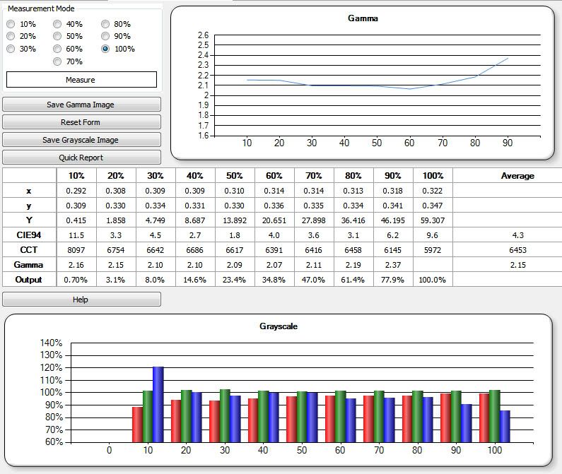

Found the following in my notes:
The only tint you can detect is in reference to the white that is the brightest shade of gray on the screen.
That's why when red clips and the brightest white goes blue, your eye tells you all the lower swatches just turned pinkish.
Your eye can be sensitive to see if the grayscale is consistent, but it doesn't have a clue what the whitepoint is.

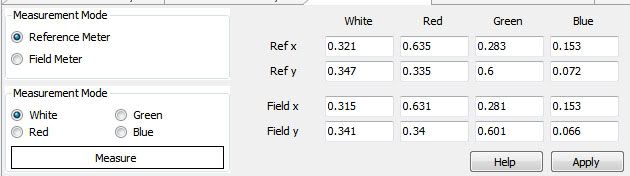

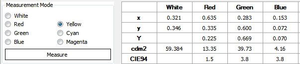

Lets look at my charts;
First, the calibration table.
Then, the calibrated results of the i1D3 after profiling to an i1Pro.
All seems to be good and working.
Now this is my problem; grayscale measurements from i1D3;
Then there is the result of the i1Pro;
I know that the profiling was only at the 100% point so at least at 100IRE they should measure the same, right?
And lets just say the color space of a monitor is really 'funny' and does not accomodate to normal specification. Would the grayscale results be different from 10-90IRE and only measure the same at 100IRE after profiling?
It is very obvious that the i1Pro's measurements are tainted after being profilied to the i1D3. Or I just do not know what I am talking about?
** By the way, I tested that unplugging either one makes no difference to the results.
