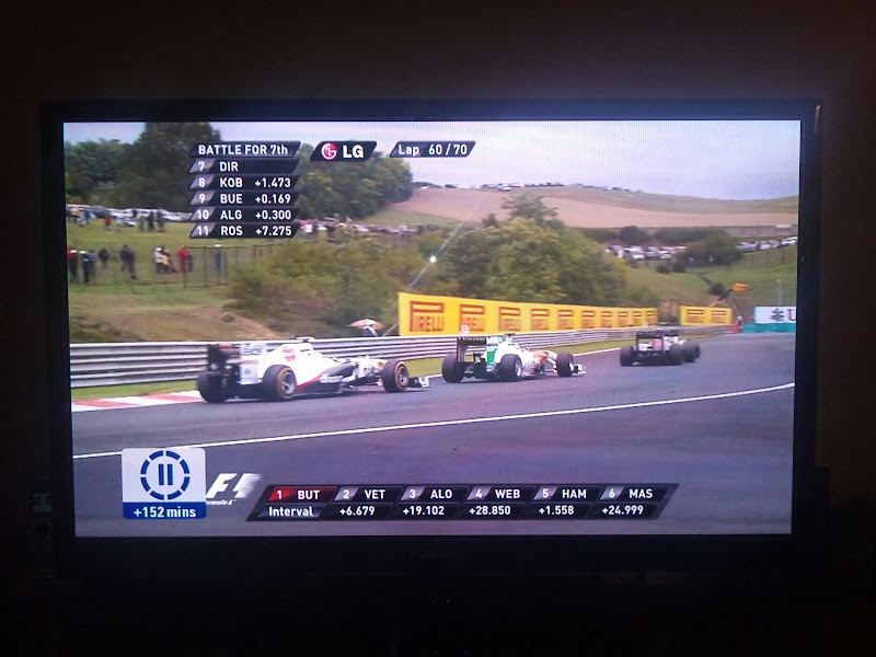

hi all, i've spent a couple of late nights calibrating my 43d450 (low-end samsung plasma) and i'm getting there slowly. my main problem is my greens are neon! to get to the stage below in my images i've increased green gain and green offset quite alot. i read that you shouldn't really touch them, but without increasing them i couldn't get some of the reds and blues low enough when calibrating the greyscale. as soon as i adjusted the greens i got much closer to 100% for r,g & b. edit: you can click on the thumbnails for a bigger picture.
what should i do differently? if i drop the greens back to standard, my red and blue won't get near 100%.
current settings:
13 - cell light
87 - contrast
57 - brightness
54 - colour
50/50 - tint
30 - red offset
39 - green offset
20 - blue offset
08 - red gain
42 - green gain
08 - blue gain
warm 1
gamma 0
everything else off
(for reasons unknown i didn't bring the hcfr file to work, but a load of screen shots instead- first lesson learned.)
this is the original screenshot on standard samsung movie mode:
this is the calibrated screenshot (camera moved a bit so not as sharp, but you can see the lovely glowing shrubbery)
edit 20/08: tonights calibration... colour dropped from 54 to 51, tint changed to 52/48
kpm197 is offline

The luminance of your primaries is completely out of control.
red 23, green 88, blue 11, yellow 104, cyan 95, magenta 35, ...
Have you disabled all dynamic modes?

When showing primaries/secondaries, click on the "down arrow" next to the "Editable data". That will show you "delta Luma" and you can see how much off you are.
Your luminance is off. Use this table for your reference. For Y, it is the % of White. In your case, If White Y=113.426, then your Green Y should be 0.7152*113.426 = 81.12 (you have about 87)
Blue Y should be 0.0722*113.426 = 8.19. (you have about 10.7)
Red Y should be 0.2126*113.426 = 24.11 (you have about 23.226)
So, you are about 10% too bright in Green, and about 20% too dim in Blue (hence the large DeltaE).
For primaries, get the luminance to be as close to each other...
If you have CMS, then try it. If not, you might need to reduce overall color down... it might affect your other color... but most device is a compromise. You should not expect you can get everything perfect, especially with a low-end device.
Other alternative is to get a video processor like lumigan or DUO or AVFoundry...

Remember that the green gain and green offset are adjusting the gray scale. That isn't the same as the color. Your gray scale looks very good. The luminance of green seems a bit high, which is what is likely making everything that is green look too bright. Unless you have a color management system, you won't be able to do much other than reduce the color control (basic color). The other thing to check is whether or not color is being decoded properly. I ran into this with one of my displays taking rec709 (HD) source material and misconverting it. The display applied a color 'twist' which made green much brighter. What is your source and how are you feeding it to the display?

as angryht indicated, your grayscale is fine. No need to mess around with the RGB gain/offset anymore.
CMS is completely different. Your monitor might not even allow you to do this. YOu might need to search through the service menu or this forum to find out if your monitor have CMS or not.
Remember, the RGB gain/offset is to set the different RGB balance within the WHITE level.. Your Green looks too "bright"/neon because the individual color of GREEN is too bright. Most set do not include CMS.. you might try different color control (wide, standard, normal or something??) and that might help.

i've finished going over the colours and now the grass glows even more! i've edited post #3790 with the latest screenshot.
edit: i don't have CMS in the user menu (i've yet to check service menu) so adjustments done with colour and tint controls.
primary and secondary luminance:
red = 21.7 was 23 (target 24.4)
green = 81.7 was 88 (target 82.2)
blue = 9.6 was 11 (target 8.3)
yellow = 103.3 was 104 (target 106.7)
cyan = 90.5 was 95 (target 90.5)
magenta = 32.1 was 35 (target 32.7)
i concentrated on getting the green accurate at the expense of red (i tend to find images too warm anyway).
i even improved the greyscale before hand and gamma is now at 2.27 which was a nice surprise!
i've attached my hcfr file...
any more suggestions on how i can fix the neon grass?
i noticed that if i changed the image from WARM1 to WARM2 i can get much more accurate colours but at the expense of the greyscale.

If all you have are color and tint controls you're limited on what you can do.
Tint typically affects the location of the secondaries. If you subjectively think aiming for the 709 secondaries made the picture worse, then instead try to get the dotted lines on the CIE diagram to go from the primary, through white to the secondary. It looks like the dotted lines on the CIE diagram from the tint setting on the prior image were closer to white than on the latest chc file.
Color usually affects Y in comparison to white the most. If you're looking mainly at green, the delta luma line is basically dead on for Rec 709 on the chc file. The spreadsheet is under 1% for difference in Y for a custom color reference, so dropping color one setting may or may not be closer.
Note:
- Your measurements and evaluation video generally need to played from the same source. If you are playing the calibration video from a Blu-ray player, then you also need to use the Blu-ray player for evaluating other video. The reason for this stipulation is that the source can affect the video output, so if one of the sources modifies the video it will likely affect the resulting picture from another source. While ideally all digital sources should simply use matching video levels, that may or may not be the case, and you really don't know without further testing.
- When evaluating video it's a decent idea to use a few different videos, since it's unlikely to know how exactly grass was encoded with a single video.
